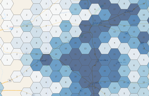

Flat hexagon binned feature layer
This binned feature layer displays the total count of recorded tornadoes over West Texas in flat hexagonal-shaped bins.
