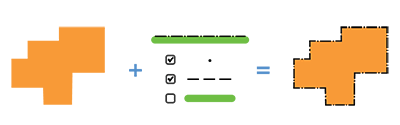

Sometimes it is easier to reuse components from another symbol than to build a new symbol. This is also a good way to ensure graphical consistency between related symbols. To reuse existing symbol components, ensure that the source symbol is stored in a style. Save it in your Favorites style if you don't want to store it formally elsewhere. Then you can import any of the symbol layers in the source symbol into the current symbol. You can do this even from symbols of differing geometry types. For example, you can import stroke and marker symbol layers from a line symbol into a polygon symbol to have them draw along the polygon outlines.
The black dashed stroke layer and a black dot marker layer of a line symbol are imported into a solid orange polygon symbol to make a solid orange polygon symbol with a dash-dot outline.
From a polygon symbol with a solid fill symbol layer, you can import some symbol layers from an existing line symbol to create a polygon symbol with a dash-dot outline.
