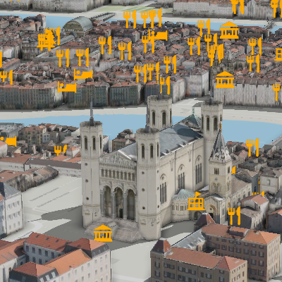

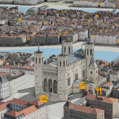

Improve perspective
The improve perspective option sizes symbols in screen units but scales down symbol sizes farther from the camera.
3D points of interest without perspective
3D points of interest with perspective
3D Points of interest with perspective view
