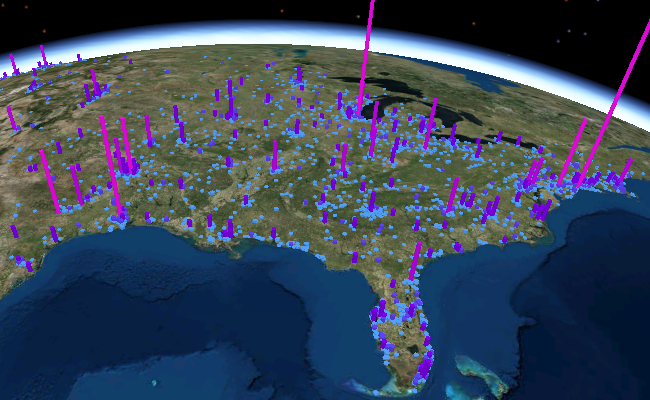

Global scenes
Global scenes are ideal when sharing data that has a global extent. Global scenes only support WGS 84 and China Geodetic Coordinate System 2000.
Global scene showing the population of United States cities
A global scene shows the population of United States cities.
