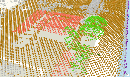

Edit classification codes for lidar data
Lidar points have classification codes, such as ground, building, or medium vegetation, and these values can be missing or incorrect. Profile viewing can be used to view the lidar in a way that facilitates the selection and updating of class codes for individual points. To edit classification codes, select the LAS dataset layer in the Contents pane and click the Classification tab. The Profile Viewing controls are accessible on the Classification tab to create a profile view. Use interactive selection methods and the Classification Codes drop-down menu in the Interactive Edit group to choose a new classification code for the selected points.
Example profile viewing of lidar data
The GIF shows an example of navigating through lidar data using profile viewing to find unclassified points.

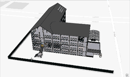

Create profile images of building model data
Architectural designs often include profile views of the principal sides of a building. Profile viewing can be used to view and export images along these lines. Navigate or use the Move Forward and Move Backward commands to step through your profile. On the Share tab, click Export Map to File to save an image file of the current display.
Example profile viewing of building data
The GIF shows an example of navigating through building data using profile viewing.
