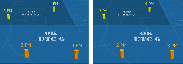

The following images demonstrate this map time value adjustment using two layers in neighboring time zones:
Time value adjustment
The left image shows two time-aware layers with their respective time zones set. The yellow locations are located in Colorado, which is in Mountain time (UTC-7), and the orange locations are located in Oklahoma, which is in Central time (UTC-6). Values in this image are not adjusted to reflect map time. The right image shows the same values after being adjusted to display in Mountain time. As a result, the orange values have decreased by the one-hour time difference.
When a map time zone results in a temporal adjustment such as this, the display of temporal values is adjusted in all areas of the software, including the attribute table, the Attributes pane, pop-ups, layouts, and reports.
