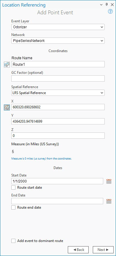

To create a single point event using coordinates with the Add Point Event tool, complete the following steps:
  1. Open the map in ArcGIS Pro and zoom to the location where you want to add the point event.
  2. On the Location Referencing tab, in the Events group, click Add > Point Event .
    The Add Point Event pane appears.
  3. Click the Method drop-down arrow and choose Coordinates.
    Add Point Event pane with Coordinates method
  4. Click Next.
    The Event Layer drop-down menu, Network drop-down menu, and the Coordinates section appear in the pane.
  5. Click the Event Layer drop-down arrow and choose the point event layer where you want to add a point event.
    The Network drop-down menu is populated based on the Event Layer value.
  6. Specify the route for the new point event by doing one of the following:
    • Provide the route name in the Route Name text box.
    • Click Choose route from map and click the route on the map.
    Add Point Event pane with coordinate selections
  7. Optionally, provide a geographic coordinate factor value in the GC Factor text box.
    Providing a geographic coordinate factor adjusts the coordinates by dividing the X and Y values by the factor specified.
  8. Click the Spatial Reference drop-down arrow and choose a spatial reference:
    • LRS Spatial Reference—The spatial reference of the LRS network
    • Web Map Spatial Reference—The spatial reference of the basemap
    • GCS_WGS_1984—A geographic spatial reference using degree decimals as units
  9. Specify the x-, y-, and optionally, z-coordinate values for X, Y, and Z.
    Based on the provided coordinates, the event is located on the route. If the coordinate location does not fall on the selected route, a point on the route that is nearest to the coordinate location is selected to locate the event, and its distance from the route is displayed.
    Tip:
    You can also select a coordinate by clicking Select an X/Y Location on the Map.
  10. Specify the date that defines the start date of the event by doing one of the following:
    • Provide the start date in the Start Date text box.
    • Click Calendar and choose the start date.
    • Check the Route start date check box.
  11. Optionally, specify the date that defines the end date of the event by doing one of the following:
    • Provide the end date in the End Date text box.
    • Click Calendar and choose the end date.
    • Check the Route end date check box.
    The end date is optional. If no end date is provided, the event remains valid from the event start date and into the future.
  12. Click Next.
    The attributes for the specified point event layer appear in the Manage Attributes section.
    Add Point Event pane with Manage Attributes section
  13. Provide attribute information for the new event.
    Note:
    Click Copy attribute values by selecting event on the map and click an existing point event belonging to the same event layer on the map to copy event attributes from that point.
  14. Click Run.
    A confirmation message appears when the point event is added and appears on the map.

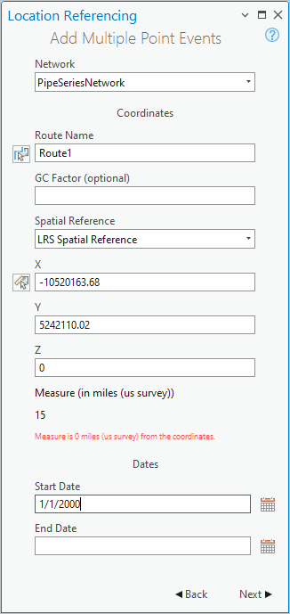

To add multiple point events by coordinates using the Add Multiple Point Events tool, complete the following steps:
  1. Open the map in ArcGIS Pro and zoom to the location where you want to add the point events.
  2. On the Location Referencing tab, in the Events group, click Add > Multiple Point Events .
    The Add Multiple Point Events pane appears.
    Add Multiple Point Events pane with Coordinates method
  4. Click Next.
    The Coordinates options appear in the Add Multiple Point Events pane.
  5. Click the Network drop-down arrow and choose a network.
    The Network value must be a published LRS Network layer.
  6. In the Coordinates section, specify the route where the events will be located by doing one of the following:
    • Provide a route name in the Route Name text box.
    The specified route is highlighted on the map.
    Add Multiple Point Events pane with Coordinates section
    • LRS Spatial Reference—The spatial reference of the LRS Network
    Based on the provided coordinates, the event is located on the route. If the coordinate location does not fall on the selected route, a point on the route that is nearest to the coordinate location is selected to locate the event, and its distance from the route will be displayed.
    Tip:
  10. Specify the start date of the event by doing one of the following:
    Note:
    The start date default value is today's date, but you can specify a different date.
  11. Optionally, specify the date that defines the end date of the events by doing one of the following:
    • Click the Calendar and choose the end date.
    The end date is optional. If no end date is provided, the events remain valid from the event start date and into the future.
  12. Click Next.
    The Manage Attributes section appears with the default attribute set.
  13. Click the Attribute Set drop-down arrow and choose an attribute set.
    The event layers and fields that are configured in the chosen attribute set appear in the pane.
    Add Multiple Point Events pane with Manage Attributes section
  14. Provide attribute information for the events in the attribute set.
    Note:
  15. Click Run.
    A confirmation message appears when the new point events are created and appear on the map.
