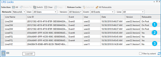

The following is an example of the LRS Locks table with user22 signed in using Version2:
The LRS Locks table is shown with user22 signed in using Version2.
The locks were acquired by user22 using Version2, and their edits were saved, resulting in a releasable status value of On Post.
The locks were acquired by user22 using Version2, and they didn't save any edits, resulting in a releasable status value of Yes.
The locks were acquired by user11 using Version1, and the signed-in user (user22) didn't acquire the locks, resulting in a releasable status value of No.

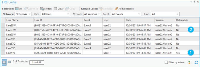

The following is an example of the LRS Locks table with user11 signed in using Version1:
The LRS Locks table is shown with user11 signed in using Version1.
The lock was acquired by user11 using Version1, and they didn't save any edits, resulting in a releasable status value of Yes.
The locks were acquired by user22 using Version2, and the signed-in user (user11) didn't acquire the locks, resulting in a releasable status value of No.
