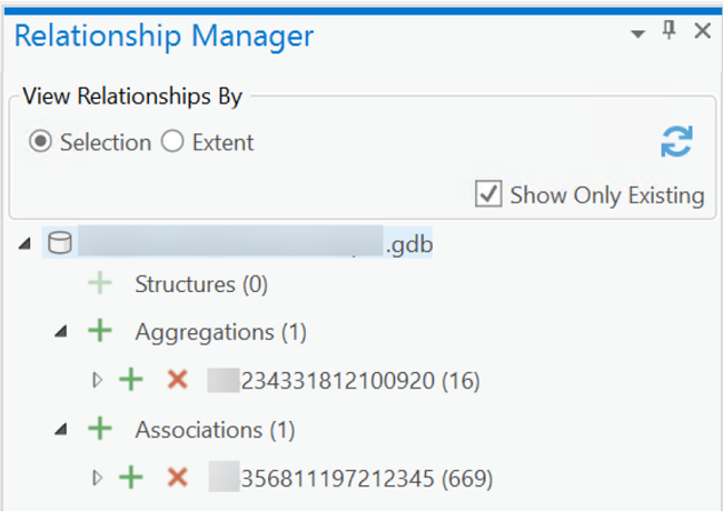

  4. On the Maritime S-57 tab, in the S-57 Editing group, click Relationship Manager .
    The Relationship Manager pane appears.
  5. In the View Relationships By section, click Selection.

  7. Perform one or more of the following to create relationships:
    Create an aggregation relationship
    Click the Add button on the Aggregations node.
    Create an association relationship
    Click the Add button on the Associations node.
    Append selected features to an existing association or aggregation
    Select the participating features and click the Add button on the node of the relationship to which you want to append the selected features.
    Relationship Manager pane with Aggregations and Associations nodes
