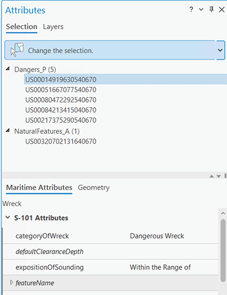

    Attributes pane
  5. On the Selection tab, click the Select one or more features drop-down arrow to select the features you want to edit, and expand the selection.
    If you selected S-100 features, the Maritime Attributes tab appears in the Attributes pane.
    Maritime Attributes tab in the Attributes pane

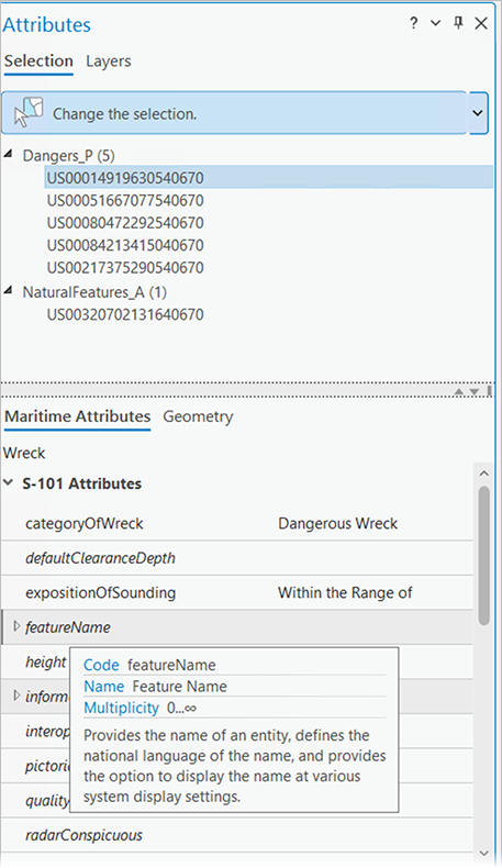

  5. On the Maritime Attributes tab, hover over a field name.
    A tooltip appears with the multiplicity of the attribute.
    Maritime Attributes tab with multiplicity tooltip
    For example, in the image above, the attribute featureName has a multiplicity that allows for 0, or an infinite number of, instances.
