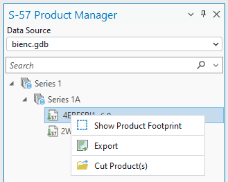

Context menu in the S-57 Product Manager pane

  6. In the S-57 Product Manager pane, right-click the products that you want to move and click Cut Product(s).
    Tip:
    To select multiple products in the same series, click each product you want to move while pressing the Ctrl key, or click a product and a second product while pressing the Shift key to select a range of products.
  7. Right-click the name of the series that you want to move the product to and click Paste Product(s).
