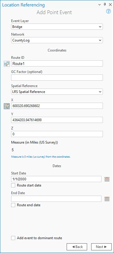

    The Event Layer drop-down menu, Network drop-down menu, and the Coordinates section appear in the pane.
  5. Click the Event Layer drop-down arrow and choose the point event layer where you want to add a point event.
    The Network drop-down menu is populated based on the Event Layer value.
  6. Specify the route for the new point event by doing one of the following:
    • Provide the route ID in the Route ID text box.
    • Click Choose route from map and click the route on the map.
    Add Point Event pane with Coordinates method
  7. Optionally, provide a geographic coordinate factor value in the GC Factor text box.
    Providing a geographic coordinate factor adjusts the coordinates by dividing the X and Y values by the factor specified.
  8. Click the Spatial Reference drop-down arrow and choose a spatial reference:
    • LRS Spatial Reference—The spatial reference of the LRS Network
    • Web Map Spatial Reference—The spatial reference of the basemap
    • GCS_WGS_1984—A geographic spatial reference using degree decimals as units
  9. Specify the x-, y-, and optionally, z-coordinate values for X, Y, and Z.
    Based on the provided coordinates, the event is located on the route. If the coordinate location does not fall on the selected route, a point on the route that is nearest to the coordinate location is selected to locate the event, and its distance from the route is displayed.

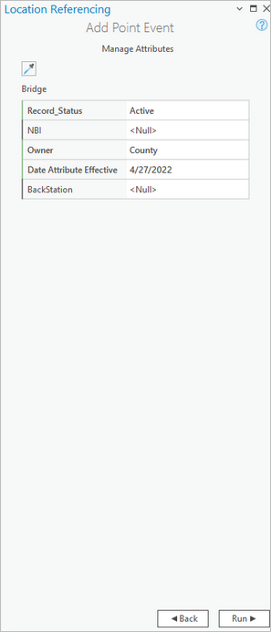

    The attributes for the specified point event layer appear in the Manage Attributes section.
  13. Provide attribute information for the new event.
    Note:
    Click Copy attribute values by selecting event on the map and click an existing point event belonging to the same event layer on the map to copy event attributes from that point.
    Add Point Event pane with Manage Attributes
  14. Click Run.
    A confirmation message appears when the point event is added and appears on the map.

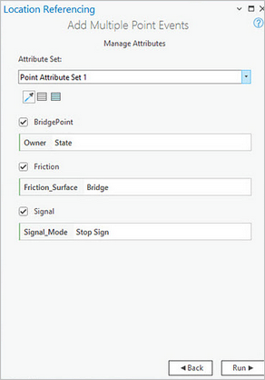

    The Manage Attributes section appears with the default attribute set.
  13. Click the Attribute Set drop-down arrow and choose an attribute set.
    The event layers and fields that are configured in the chosen attribute set appear in the pane.
    Add Multiple Point Events pane with Manage Attributes
  14. Provide attribute information for the events in the attribute set.
    Note:
  15. Click Run.
    A confirmation message appears when the new point events are created and appear on the map.
