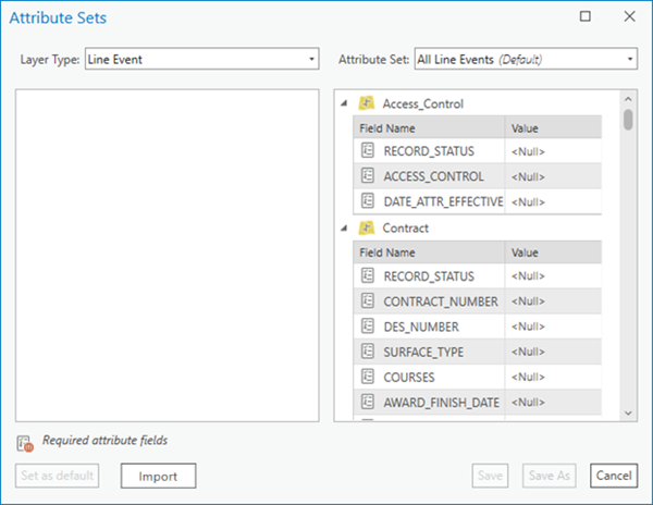

    The Attribute Sets dialog box appears with the line event default attribute set visible.
    There are attribute sets for both point events and line events that contain events and their attribute fields. These attribute sets are the default values for the current geodatabase administrator. You can designate a different attribute set as the default attribute set after saving at least one custom attribute set. In the following image, all the line event layers in the project are included in the All Line Events attribute set.

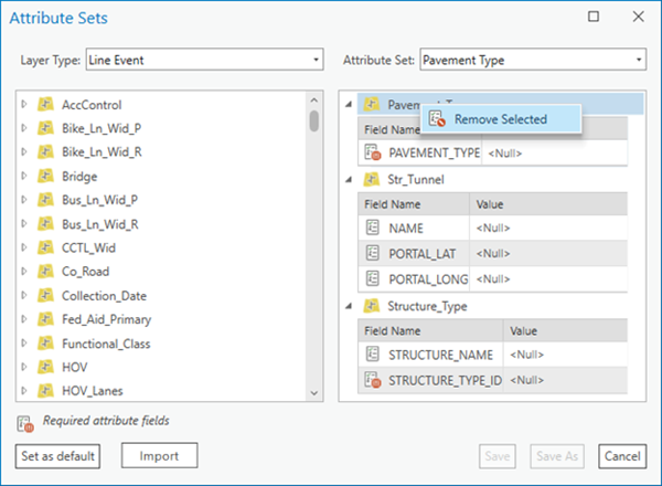

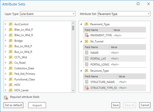

  6. Drag any layer of the layer column to the list on the right to define it as part of an attribute set. Alternatively, right-click an event layer on the left and choose Add Selected to add it to the attribute set.
    Attribute Sets dialog box with custom attribute set
    In the image, the Pavement_Type event and other line event layers were added to the attribute set.
    Note:
    Some event attributes are required fields. If you attempt to add attributes from an event layer that includes required fields, the required attributes are automatically added to the attribute set.
    To remove, right-click an event layer in the attribute set and choose Remove Selected to move it back to the available event layers list on the left. Alternatively, drag items from the right side of the dialog box to the left to remove them from the attribute set.
    Remove Selected layer or field
  7. When you are finished adding attributes and providing values in the attribute set, click Save.
    The saved attribute sets are stored in the map.
