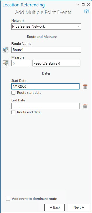

  4. Click the Network drop-down arrow and choose the network that is the source for the event layers.
  5. Specify the route where you want to create the point events by doing one of the following:
    • Provide a route name in the Route Name text box.
    • Click Choose route from map and click the point on the route where you want to add the point events.
    To choose a new measure, click Choose measure from map and click the route measure.
    The measure is initially populated using the route location where you clicked.

  6. Specify a new location by doing one of the following:
    • Provide the value in the Measure text box.
    • Click Choose route from map and click the measure value along the route on the map.
    Once the measure is provided, a green dot appears on the map at that measure location.
  7. The start date default value is the current date, but you can change the date by doing one of the following:
    • Provide the start date in the Start Date text box.
    • Click Calendar , and choose the start date.
    • Check the Route start date check box.

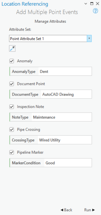

    Manage Attributes appears with the default attribute set.
    The Attribute Set list includes other attribute sets if configured.
    You can configure attribute sets in the same feature service.
  10. Optionally, click the Attribute Set drop-down arrow, and choose the attribute set.
    The attributes configured in the attribute set appear in the pane.
  11. Provide attribute information for the events in the attribute set.
    Add Multiple Point Events pane with Manage Attributes section
    Note:
    Click Copy attribute values by selecting event on the map and on the map, click an existing point event from the same event layer to copy event attributes from that point.
