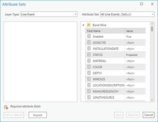

    The Attribute Sets dialog box appears with the line event default attribute set visible.
    There are attribute sets for both point events and line events that contain events and their attribute fields. These attribute sets are the default values for the current geodatabase administrator. You can designate a different attribute set as the default attribute set after saving at least one custom attribute set. In the following image, all the line event layers in the project are included in the All Line Events attribute set.
    If a field has a default value, it is shown when the attribute set that includes that field is selected on the Attribute Sets dialog box. Double-click a default value in the Value column to change its value. Values that are updated on the Attribute Sets dialog box can overwrite the default value set in the database.
    When one or more layers in an attribute set are not present in the map, the warning icon appears next to the name of the attribute set on the Attribute Sets dialog box.
    Attribute Sets dialog box with the default attribute set

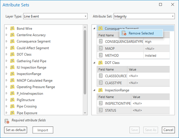

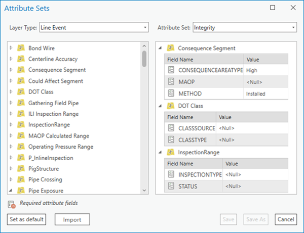

  6. Drag any layer of the layer column to the list on the right to define it as part of an attribute set. Alternatively, right-click an event layer on the left and choose Add Selected to add it to the attribute set.
    Attribute Sets dialog box with custom attribute set
    In the image, all the attributes from the Consequence Segment event layer were added to the attribute set.

    To remove, right-click an event layer in the attribute set and choose Remove Selected to move it back to the available event layers list on the left. Alternatively, drag items from the right side of the dialog box to the left to remove them from the attribute set.
    Remove Selected layer or field
  7. When you are finished adding attributes and providing values in the attribute set, click Save.
    The saved attribute sets are stored in the map.
