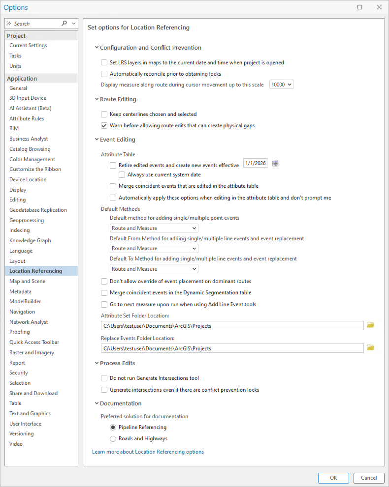

To configure Location Referencing options in ArcGIS Pro, complete the following steps:
  1. Open the project where you want to set Location Referencing options.
  2. On the Location Referencing tab, in the Routes group or the Events group, click the Location Referencing Options button .
    The Options dialog box appears with the Location Referencing tab active.
    Tip:
    You can also access Location Referencing options by clicking Project > Options and clicking the Location Referencing tab on the Options dialog box.
  3. Configure any of the following options as often as needed:

    Configuration and Conflict Prevention
    Set LRS Layers in maps to the current date and time when project is opened
    Check this check box to set the current date and time for the current project and user if time is enabled for LRS data. When this check box is checked, the current date and time is set on maps in the project each time the project is opened.
    Automatically reconcile prior to obtaining locks
    Check this check box to configure automatic lock reconciliation for conflict prevention.
    Learn more about conflict prevention
    Display measure along route during cursor movement up to this scale
    Click the drop-down arrow and choose a scale for the display of routes and measures while moving the pointer on the map in a feature service. The default is 1:10,000.
    Route Editing
    Keep centerlines chosen and selected
    Check this check box to keep centerlines in the Location Referencing pane chosen and selected on the map after route edits. When this check box is not checked, centerlines chosen in the Location Referencing pane are deselected, and selected features on the map are cleared.
    Warn before allowing route edits that can create physical gaps
    Uncheck this check box to disable the warning prompt that appears when a route edit will result in one or more physical gaps.
    Event Editing
    Retire edited events and create new events effective
    Check this check box to retire events as of the date set in the text box following an update to an event’s attributes using the Attributes pane, attribute table, or Edit Vertices tool . When this check box is checked, the Retire edited events and create new events effective option in LRS Advanced Options is checked by default. The default date is the current date.
    Always use current system date
    Check this check box to always use the current system date when retiring edited events and creating a new record in LRS Advanced Options. When this check box is checked, the text box in the Retire edited events and create new events effective option above is unavailable.
    Merge coincident events that are edited in the attribute table
    Check this check box to merge events that are coincident and edited to have identical attributes following an update to an event's attributes using the Attributes pane, attribute table, or Edit Vertices tool . When checked, the Merge coincident events that are edited in the table option in LRS Advanced Options is checked by default.
    Automatically apply these options when editing in the attribute table and don't prompt me
    Check this check box to automatically apply the options above without prompting the LRS Advanced Options pop-up when editing event attributes using the Attributes pane, attribute table, or Edit Vertices tool .
    To disable the LRS Advanced Options pop-up, check this check box and leave the check boxes above unchecked.
    Default method for adding single/multiple point events
    Click the drop-down arrow and choose a default method for adding single or multiple point events. The default option is Route and Measure.
    Default From Method for adding single/multiple line events and event replacement
    Click the drop-down arrow and choose a default From Method value for adding single or multiple line events and event replacement. The default option is Route and Measure.
    Default To Method for adding single/multiple line events and event replacement
    Click the drop-down arrow and choose a default To Method value for adding single or multiple line events and event replacement. The default option is Route and Measure.
    Don't allow override of event placement on dominant routes
    Check this check box to automatically add events to the dominant routes without showing the route concurrency pane if the Add event to dominant route check box in the add event tools is checked. If the Add event to dominant route check box in the add event tools is unchecked, events are still added to the selected route.
    Merge coincident events in the Dynamic Segmentation table
    Check this check box to automatically merge coincident events following attribute updates in the Dynamic Segmentation table. When this check box is checked, events that are coincident and edited to have identical attributes are merged.
    Learn more about dynamic segmentation
    Go to next measure upon run when using Add Line Event tools
    Check this check box to automatically go to the next measure upon running the Add Line Event or Add Multiple Line Events tools. When this check box is checked, the next edit will begin at the end measure location of the previous edit and use the same method as the To Method value in the previous edit.
    Attribute Set Folder Location
    Choose an alternate attribute set folder location, either by clicking the Browse button to choose a folder other than the default location or by providing the folder path.
    Replace Events Folder Location
    Choose an alternate replace events folder location, either by clicking the Browse button to choose a folder other than the default location or by providing the folder path.
    Process Edits
    Do not run Generate Intersections tool
    Check this check box to prevent intersections from being created or updated when running the Process Edits tool.
    Note:
    Intersections will still be updated if a cartographic realignment is performed and an LRS event is configured with the Honor Referent Location event behavior rule.
    Generate intersections even if there are conflict prevention locks
    Check this check box to bypass existing locks on the intersecting routes when creating or updating intersections using the Process Edits tool.
    Caution:
    Bypassing conflict prevention locks may result in data corruption or unexpected behavior. Consider the potential consequences and create a database backup before running the Process Edits tool with this option checked.
    Documentation
    Pipeline Referencing
    Set this preference to have Pipeline Referencing documentation load when context-sensitive help links are clicked.
    Roads and Highways
    Set this preference to have Roads and Highways documentation load when context-sensitive help links are clicked.
  4. Click OK.
