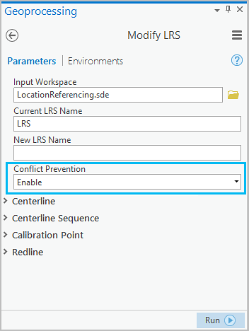

Enable conflict prevention
Conflict prevention is supported only on an LRS dataset that is registered as branch versioned.
Once the dataset is registered as branch versioned, run the Modify LRS tool with the Conflict Prevention parameter set to Enable.
Modify LRS tool with Conflict Prevention enabled
If conflict prevention is enabled, each editing tool automatically acquires locks, if locks are available, or alerts you when locks cannot be acquired.

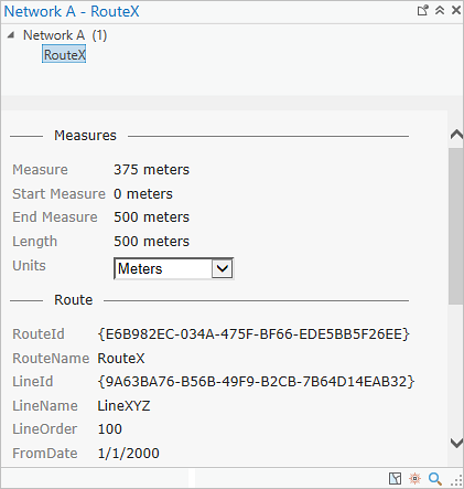

  1. On the Location Referencing tab, in the Tools group, click Identify Routes , and click RouteX.
    The Identify Routes pop-up appears.
    The Identify Routes pop-up shows that no locks exist.
  2. Verify that no locks exist on the selected route or line.
    The previous example shows no locks exist for RouteX.

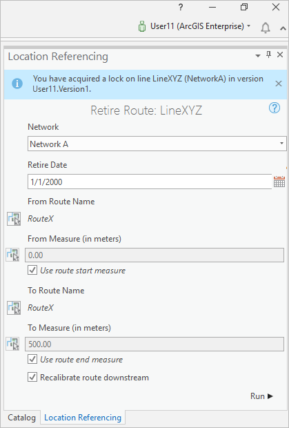

  4. Click Choose route from map , and click the route you want to retire.
    Once a route name is selected, an acquire lock message appears at the top of the pane.
    Retire Route pane with lock acquired
    Acquired routes are confirmed in the Retire Route pane.
    The locking message provides the following information:
    • The lock has been acquired on LineXYZ.
      Note:
      RouteX is part of LineXYZ.
      Since RouteY and RouteZ are part of LineXYZ, they are also locked for editing.
    • The lock has been acquired by the portal user, User11.
    • The lock on LineXYZ for the named version, Version1, has been acquired by User11.
    Note:
    You will automatically transfer an existing route or line lock from another person to yourself if all of the following conditions are met:
    • The version that is owned by another person is public.
    • You are making the request in the same version in which another person has the lock.
    • If the lock version is a named version, the lock owner does not currently have an edit session open in that version. If the lock version is the default version, the lock owner does not currently have a read session open in the default version.

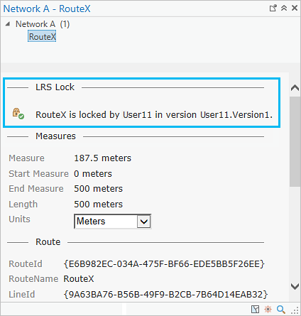

  5. To ensure that the lock exists, click Identify Routes , and click and RouteX again.
    Identify Routes pop-up with LRS Lock section
    The Identify Routes pop-up shows that the route is locked.
    The Locked by you icon also confirms that you have locks for the identified route and can edit that route.

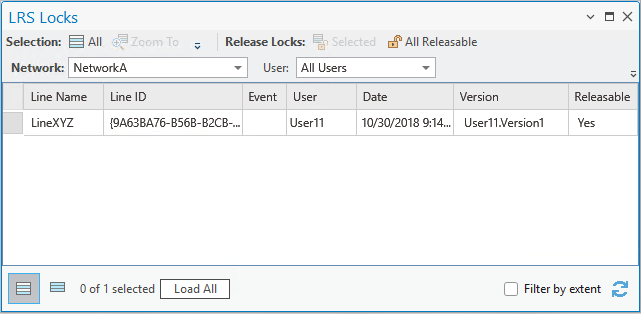

  6. Optionally, on the Location Referencing tab, in the Conflict Prevention group, identify existing locks using the LRS Locks button .
    The LRS Locks table appears.
    LRS Locks table
    The Locks table shows the existence of the recently acquired lock.

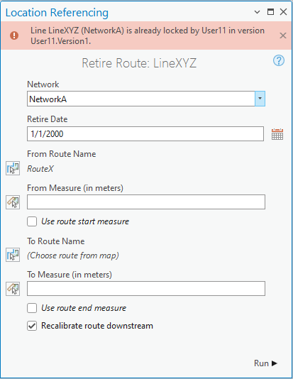

Conflict prevention messages
As described previously, the conflict prevention logic allows editing of a route or line and an event only by a single person in a single version at a time.
For example, if User22 tries to retire RouteX while the same RouteX is locked by User11, the following message appears:
Retire Route pane with no lock acquired
The route cannot be edited by User22 when User11 has the locks.
The message provides the following information:
  • LineXYZ cannot be edited because the lock belongs to someone else.
    Note:
  • The lock has already been acquired by the portal user, User11.
  • The lock on LineXYZ for the named version, Version1, has already been acquired by User11.

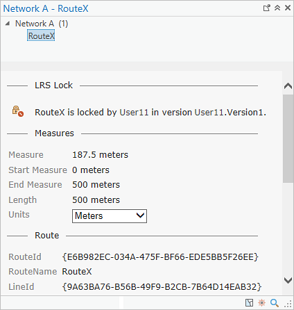

The Identify Routes pop-up shows the following result:
Identify Route pop-up with existing locks
The route is not editable due to existing locks.

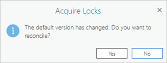

Ensure that the most recent version of the dataset is edited
Edit the most recent version so that all recent changes to the data are present in the version being edited. To confirm that you are editing the most recent version, Location Referencing checks if a reconciliation with the default version is needed before acquiring a lock. When a named version needs to be reconciled with the default version, the following message appears:
Acquire Locks dialog box
Reconcile with the default version.
Clicking Yes on the Acquire Locks dialog box reconciles the named version with the default version.
Note:
Ensure that any conflicts with the default version are reconciled before you edit the routes or events.
