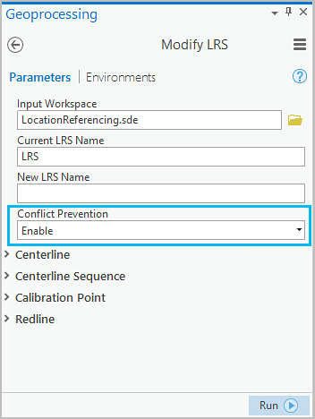

Conflict prevention is supported only on an LRS dataset that is registered as branch versioned.
Once the dataset is registered as branch versioned, run the Modify LRS tool with the Conflict Prevention parameter set to Enable.
Modify LRS tool with Conflict Prevention enabled
If conflict prevention is enabled, each editing tool automatically acquires locks, if locks are available, or alerts you when locks cannot be acquired.

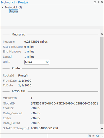

  1. Click Identify Routes , and click RouteY.
    The Identify Routes pop-up appears.
    The Identify Routes pop-up shows that no locks exist.
  2. Verify that no locks exist on the selected route.
    Because the results do not show any locks, no locks exist for that route.

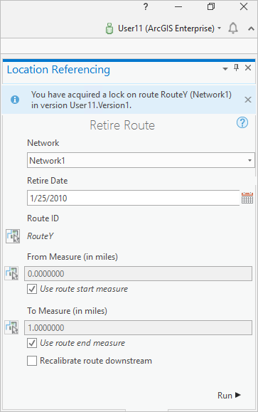

  4. In the Retire Route pane, click the Choose route from map button , and click the route you want to retire.
    Once a route name is selected, an acquire lock message appears at the top of the pane.
    Retire Route pane with lock acquired
    Acquired routes are confirmed in the Retire Route pane.
    The locking message provides the following information:
    • The lock has been successfully acquired on RouteY.
    • The lock has been acquired by the portal user, User11.
    • The lock on RouteY for the named version, Version1, has been acquired by User11.

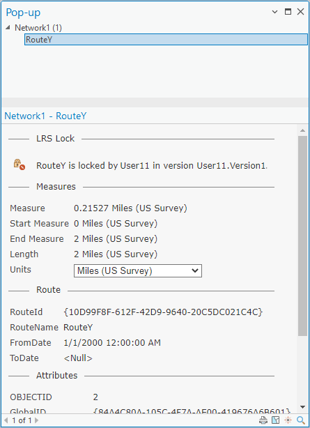

  5. To confirm the existence of a lock, click Identify Routes , and click RouteY again.
    Identify Routes pop-up, LRS Lock section
    The Identify Routes pop-up shows that the route has been locked.
    The Locked by you icon also confirms that you have locks for the identified route and can edit that route.

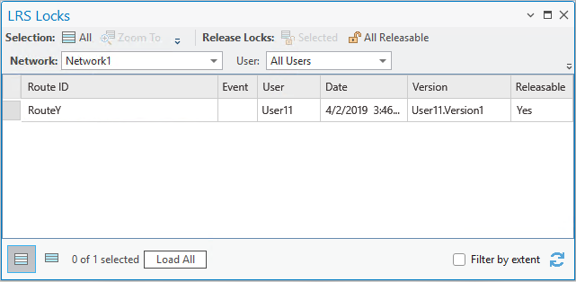

  6. On the Location Referencing tab, in the Conflict Prevention group, click the LRS Locks button to identify existing locks.
    The LRS Locks table appears.
    LRS Locks table
    The Locks table shows the existence of the recently acquired lock.

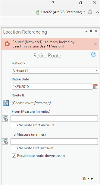

For example, if User22 tries to retire RouteY while the same RouteY is locked by User11, the following message appears:
Retire Route pane with locked route
The route cannot be edited by User22 when the route is locked by User11.
The message provides the following information:
  • RouteY cannot be edited because the lock belongs to someone else.
  • The lock has already been acquired by the portal user, User11.
  • The lock on RouteY for Version1 has already been acquired by User11.

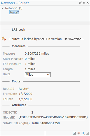

The Identify Routes pop-up shows the following result:
Identify Routes pop-up, existing locks
The Identify Routes pop-up shows the route is not editable due to existing locks.

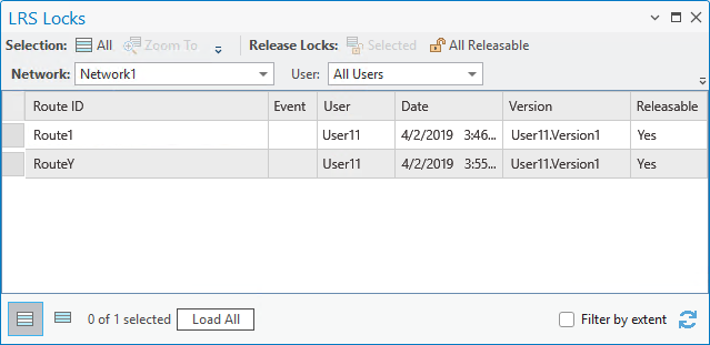

LRS Locks table
The locks table shows the lock on the route.

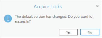

Acquire Locks dialog box
Reconcile with the default version.
Clicking Yes on the Acquire Locks dialog box reconciles the named version with the default version.
