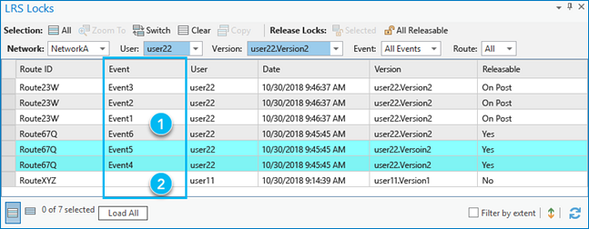

You can differentiate between the lock types by looking at the contents of the Event column. If a cell in the Event column contains a value, the lock is an event lock. If a cell in the Event column is blank, the lock is a route lock.
The following is an example of event and route locks in the LRS Locks table:
LRS Locks table, Event column
You can identify lock types in the LRS Locks table by user.
Item
Lock type
Event
Route
