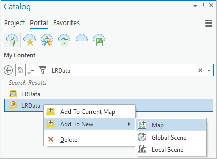

  2. In the Catalog pane, click the Portal tab, and under My Content, right-click the feature service that was published, and click Add To New > Map.
    Add a published feature service to a new map.

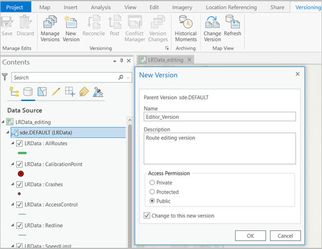

  4. On the Versioning tab, in the Versioning group, click New Version .
    The New Version dialog box appears.

  5. Provide a name for the new version in the Name text box.
  6. Optionally, provide a description for the version in the Description text box.
  7. Choose from the following access levels for the version:
    • Private—Only the owner or the geodatabase administrator can access the version and modify it and the versioned data.
    • Protected—Any user can access the version, but only the owner or the geodatabase administrator can edit the version and the datasets in it.
    • Public—Any user can access the version. Any user who has been granted read/write (update, insert, and delete) permissions on datasets can modify datasets in the version.
  8. Check the Change to this new version check box to switch to the named version after it is created.
    Tip:
    Check Change to this new version each time you create a version.
  9. Click OK.

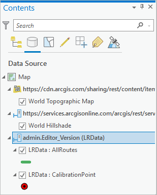

    The new version is created, and if the Change to this new version check box was checked, the editor version is shown in the Data Source list.
    Published feature service, editor version

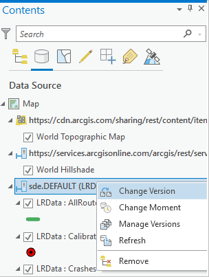

    To switch versions, right-click the feature service layer in the Data Source list, and click Change Version.
    Change Version command in the context menu
