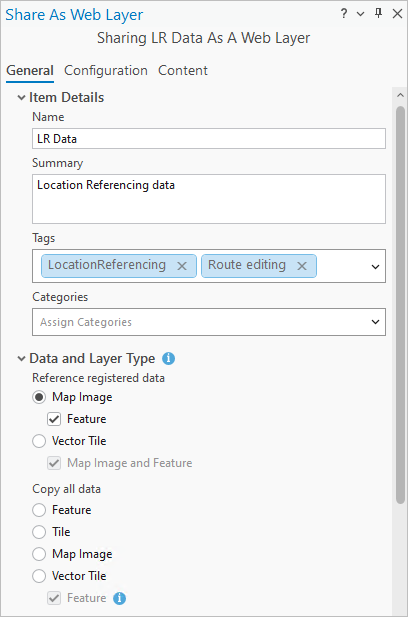

  6. Provide a name for the web layer.
  7. Optionally, complete the Summary and Tags fields.
    You can use the Tags drop-down menu to select existing tags. You can enter a maximum of 128 tags.
  8. Optionally, use the Categories drop-down menu to assign content categories.
    You can assign a maximum of 20 categories.
  9. Expand Data and Layer Type, and under Reference registered data, click Map Image, and check the Feature check box.
    Share As Web Layer pane

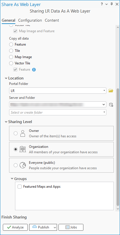

  10. Under Location, choose where to share the data under Portal Folder.
    You can share the data to the root folder or create a folder.
  11. Use the Server and Folder drop-down menus to specify the federated server where the service is published and the folder where it is stored.
    Optionally, create a folder.
    By default, the service is stored in the root folder of the server.
    Note:
    The Server and Folder options appear only if you are sharing a web feature layer that references registered data to ArcGIS Enterprise. In this case, you can also click the Data Stores button to open the Manage Registered Data Stores pane. Use this pane to register geodatabases and folders with federated servers.
  12. Under Sharing Level, specify how the web layer will be shared:
    • Owner—Only the owner (and organization members with privileges to view content owned by other members) can access the item. This is the default option.
    • Organization—Share your content with all authenticated users in your organization. This option is available when you are signed in with an organizational account.
    • Everyone (public)—Share your content with the public. Anyone can access and see it.
    1. Optionally, under Groups, select groups to which you belong to share your content with their members.

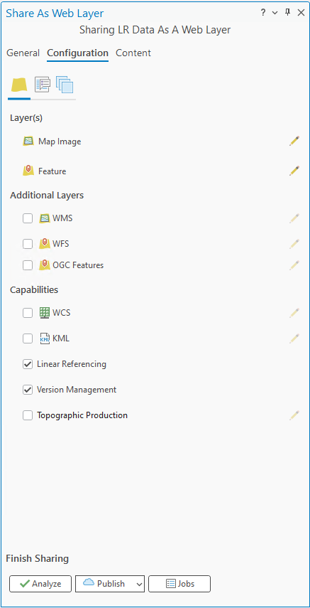

  13. Click the Configuration tab.
  14. In the Capabilities section, check the Linear Referencing and Version Management check boxes.
    Configuration tab with Linear Referencing and Version Management checked
