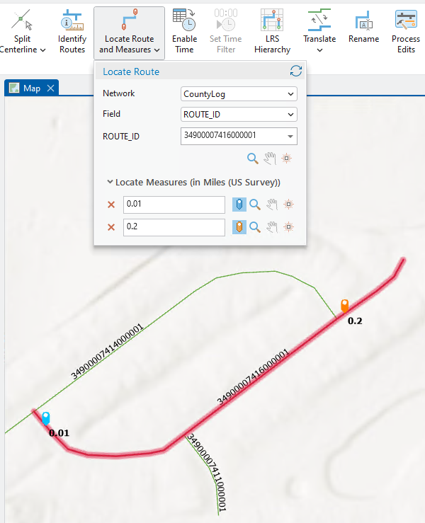

  6. Provide the measure value that you want to locate in the first Locate Measures text box, and click the blue snappable marker button .
    A blue snappable marker with the measure value appears on the map.
  7. Optionally, provide a value in the second Locate Measures text box and click the orange snappable marker button to locate another measure on the same route.
    An orange snappable marker with the measure value appears on the map.
    Locate Route options after measure markers are set

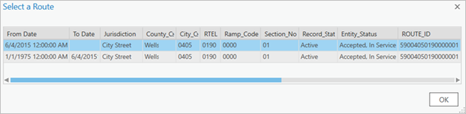

    Depending on your configuration, the Select a Route table may appear for routes that are time sliced.
    If the LRS layers are time enabled, you can set the map to a previous date using the time slider. The measure marker is added on the route according to the time set in the time slider.
    If the LRS layers are not time enabled, the Select a Route table appears, displaying all time slices of the selected route. Select a time slice for which you want to locate a measure and add a marker.
