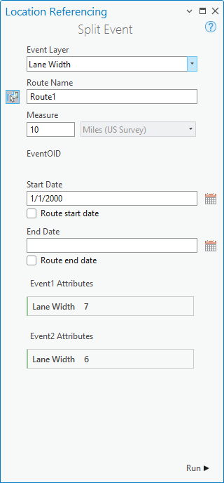

  1. Open the map in ArcGIS Pro and zoom to the location where you want to split the line event.
  2. Click the Location Referencing tab, and in the Events group, click the Split button .
    The Split Event pane appears.
    Split Event pane
  3. From the Event Layer drop-down list, choose the event layer that contains the event you want to split.
    All of the line event layers in the feature service appear in the Event Layer drop-down list. The Event1 Attributes and Event2 Attributes options and values update when the event layer changes.
  4. Choose a route by clicking the Choose route from map button , and on the map, click the measure on the route where you want to split the line event.
    The Route Name and Measure options are populated in the Split Event pane.
    The event is split into two events on either side of the point. Alternatively, you can provide a measure value in the text box.

  5. Click the Start Date and End Date calendars, and choose the start and end dates of the event being split.
    The event start date default value is the current date and the end date default value is null.
  6. Edit the Event1 Attributes and Event2 Attributes values as needed.
  7. Click Run to split the event record into two events using the provided values.
    A confirmation message appears once the split events are saved.
