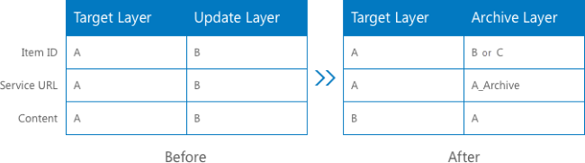

The illustration below shows how properties of the target, update, and archive layers are managed:
  • The item ID of the target layer (A) does not change. By default, the archive layer is assigned a new item ID (C); optionally, the archive layer can use the item ID of the update layer (B).
  • The service URL of the target layer (A) does not change. The service URL of the archive layer references the target layer name and appends the word archive and a date stamp (A_Archive). The portal no longer contains a web layer with the name or service URL of the update layer.
  • The target layer content (A) is replaced by the update layer content (B). The archive layer stores the replaced target layer content (A).
Table of target, update, and archive layer properties
Properties of the target layer, update layer, and archive layer before and after replacement are shown.
