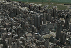

3D Object
Visualize 3D objects such as exterior shells of buildings or objects that are explicitly modeled in three dimensions.
Textured buildings
A textured buildings from Montreal.

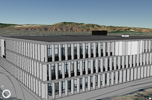

Building
3D building models derived from building information models (BIM) from REVIT or IFC data. Used to visualize complex buildings and disciplines.
Building scene layer
A building scene layer example.

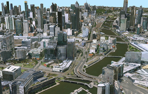

Integrated mesh
Textured continuous mesh capturing reality in a photogrammetric or sensor-based process. Visualize large areas with buildings, vegetation, and ground information.
Integrated mesh example
An integrated mesh of the City of Melbourne. Captured by Aerometrix.

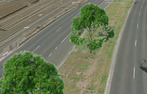

Point
Visualize large amounts of point features. Point allows you to draw millions of points symbolized by 3D symbols, such as all trees of a county.
Point scene layer example
Point scene layer of realistic trees: Urban Tree Forest Melbourne.

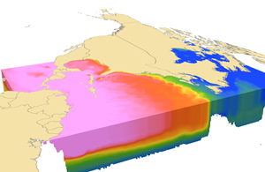

Voxel
Represents multidimensional volumetric 3D or 4D data. Visualize and explore atmospheric or oceanic data, geological underground models, or space-time cubes of voxels.
Voxel scene layer example
Water temperatures in the Atlantic ocean.
