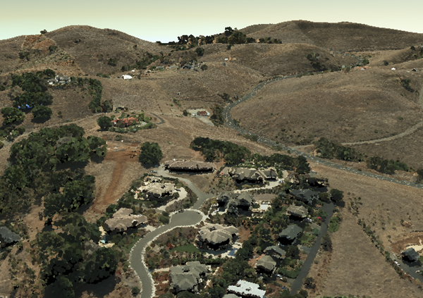

Point cloud scene layer
An example of a point cloud scene layer is shown.
