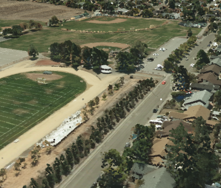

When a LAS dataset, .las file or .zlas file is added to a 3D scene in ArcGIS Pro, the points are drawn with an elevation renderer and eye-dome lighting applied by default. Eye-dome lighting is a shading technique that improves the perception of depth and contour when viewing LAS datasets. To turn eye-dome lighting on or off, select a LAS dataset in the Contents pane, select the LAS Dataset Layer tab set, and locate the Lighting and Shading group. Click the Eye-Dome Lighting button to turn the shading effect on or off. You can switch the shape in which points from a point cloud are being rendered from circles to squares to improve overall performance in a 3D scene.
LAS dataset layer
