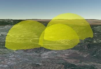

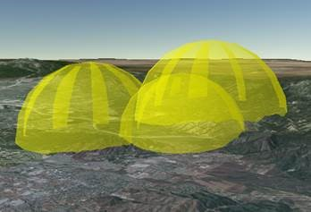

Face culling
Modifying the layer face culling property allows you to see through the front, back, or both faces of 3D objects, depending on which side of the objects you are viewing. The command is enabled for layers containing area-based data, including extruded polygons, multipatch features, TIN triangles, and raster data.
Three transparent yellow domes where the backs of the domes are visible through the fronts Three transparent yellow domes where only the fronts of the domes are visible
