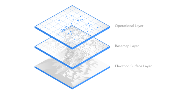

Elevation surface layers
An elevation surface layer is a composite layer representing the ground surface or a custom surface. Elevation surface layers define the height values across the extent of a map or scene. Elevation surface layers contain one or more elevation source layers that contribute height values to the surface.
Layers in a 3D scene

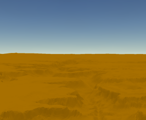

When you want the surface to draw as a physical surface in the map (scene), choose a color, and optionally check Shade Relative To Light Position to emphasize variations in relief. This is typically done when there is no basemap in the scene.
Ground surface with a color and shaded relative to the scene's light position Ground surface with a color and without surface shading relative to the scene's light position
