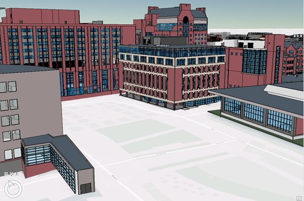

Building scene layer
A complex building scene layer is shown. Copyright 2020: The Ohio State University Facilities Information and Technology Services.
