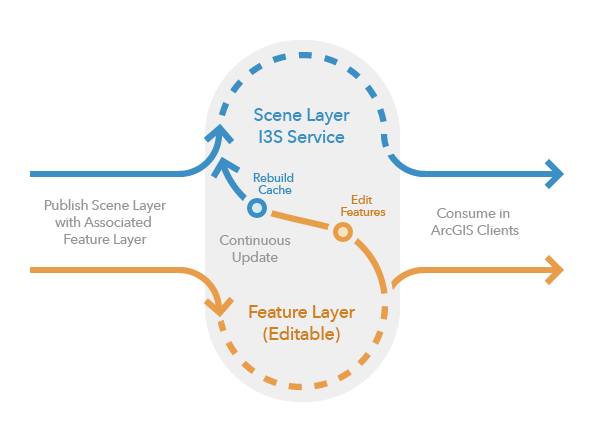

Workflow for editing a scene layer with associated feature layer
Life cycle of editing a scene layer with associated feature layer.
