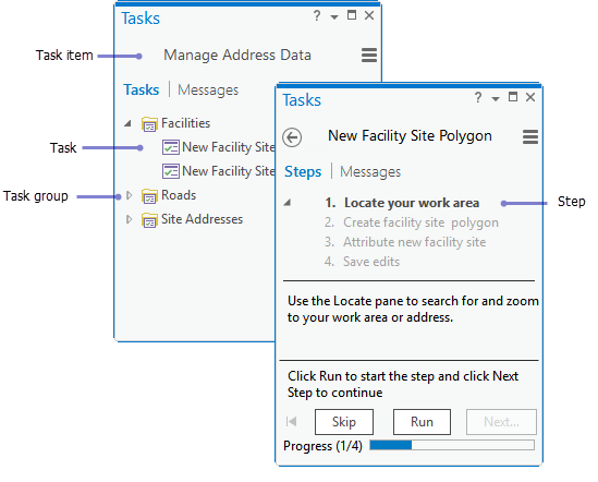

  2. Task groups (optional), which are used to group related tasks.
  3. Tasks, which contain a set of sequential steps.
  4. Task steps, which perform actions.
A task is created in a task item and steps are created in a task. A related set of tasks can be grouped into task groups.
A task and its steps
The Tasks pane displays tasks and their steps.

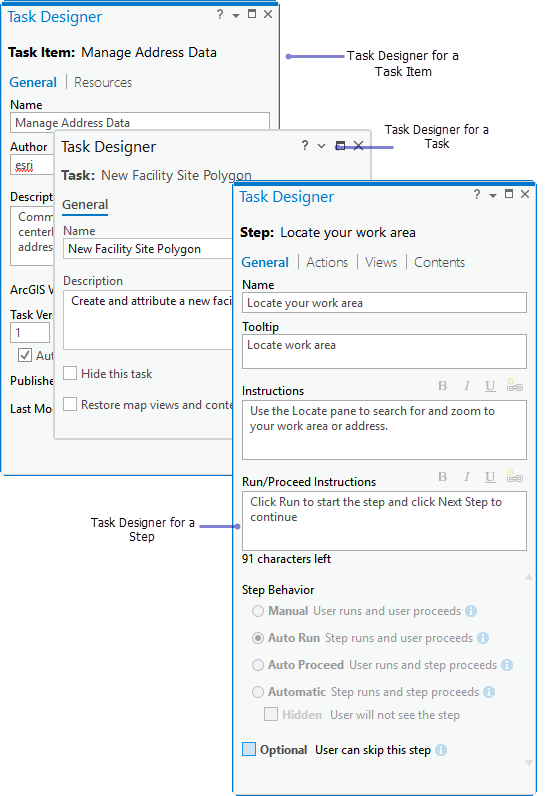

A task item, task group, task, and task step is created and designed using the Task Designer pane. The Task Designer pane displays different parameters based on which component of the task is selected in the Tasks pane, for example, the task item, task, or step.
Task Designer panes for a task item, task and step
