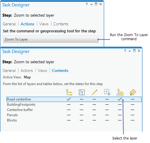

  • Select a layer in the Contents pane.
    For example, select a layer in the Contents pane and run the Zoom To Layer command to zoom to the selected layer.
    Configure a step to zoom to a selected layer
    Configure an automatic step to zoom to a selected layer.
