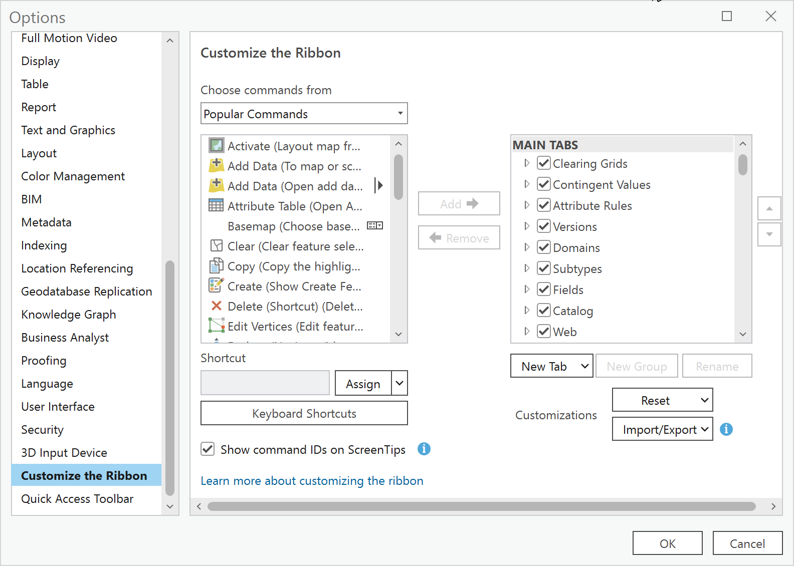

BlockCustomizeDialog
REG_DWORD. Set to 0x01 (True) to disable Customize the Ribbon property sheet and 0x0 (False) to allow the Customize the Ribbon property sheet. False is the default if no registry key is set. The Customize the Ribbon property sheet is accessed via the Project options, Option button.
blockCustomizeDialog = 0x0 (False) (note the Customize the Ribbon option)
blockCustomizeDialog = 0x01 (True) (note the Customize the Ribbon option is removed)

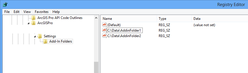

Add-In Folders
Add one or more string values (REG_SZ) whose names are the full paths to the folder locations or UNC shares that are to be searched for Add-ins. The Value data will be empty. Folders that are logical drive path letters only (e.g. "C:", "D:", "E:", etc.) are not allowed.
In this example, two additional Add-in folders have been added: C:\Data\AddinFolder1 and C:\Data\AddinFolder2

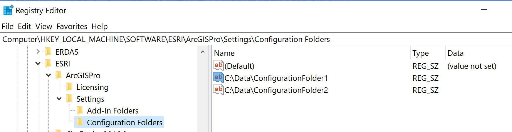

Configuration Folders
Add one or more string values (REG_SZ) whose names are the full paths to the folder locations or UNC shares that are to be searched for Configurations. The Value data will be empty. Folders that are logical drive path letters only (e.g. "C:", "D:", "E:", etc.) are not allowed.
In this example, two additional Configuration folders have been added: C:\Data\ConfigurationFolder1 and C:\Data\ConfigurationFolder2
