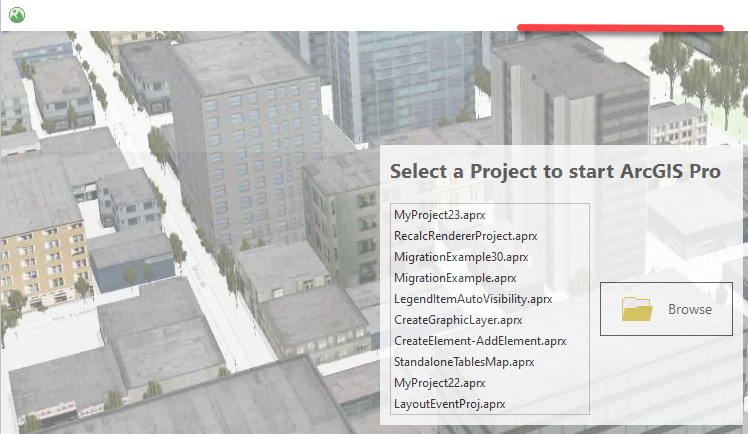

  • Make a custom splash screen and a custom start page

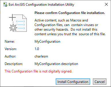

Installation
Configurations use the same installation pattern as add-ins. Double-click the .proConfigX file to run "RegisterAddin.exe". "RegisterAddin.exe" validates the configuration and copies it to the configurations' well-known folder: C:\Users\<UserName>\Documents\ArcGIS\AddIns\ArcGISPro\Configurations. Users are given an opportunity to review the author, description, version, and digital signature information of the configuration before proceeding. If a configuration has the same name as an existing configuration installed to the same folder (default folder or well-known folder), the existing configuration will be overwritten.

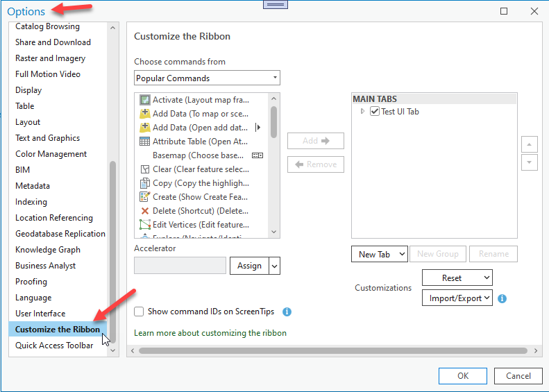

blockCustomizeDialog Default value: false
When set to true, the blockCustomizeDialog attribute removes the “Customize the Ribbon” option from the ArcGIS Pro options property sheet. This blocks all user level customizations made from the ‘Customize the Ribbon’ page in the ‘Options’ property sheet.
"Customize the Ribbon" will be removed when blockCustomizeDialog="true".

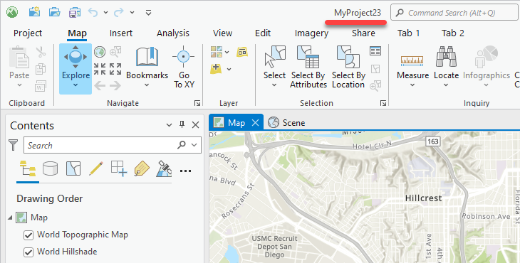

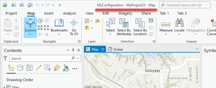

    //Gets the new application name
    protected internal virtual string ApplicationName { get; }
    //Gets the title bar text (New at 3.0)
    protected internal virtual string TitleBarText { get; }

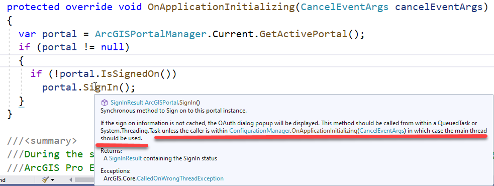

    //Called when the application is initializing. Denotes it is now safe to
    //communicate with Portal at this time. The DAML records have not been processed
    //at this point.
    //cancelEventArgs: false signals a problem has occurred. The application will shut down.
    protected internal virtual void OnApplicationInitializing(CancelEventArgs cancelEventArgs);

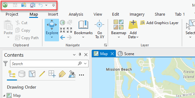

    //Opportunity for the configuration to provide a list of commands to show in the
    //quick access toolbar. It occurs after the start page has been closed and the first
    //project is opening.
    // Returns: A list of commands to be used on the QAT
    protected internal virtual List<Tuple<string, bool>> OnCreateQuickAccessToolbar();

    • OnShowStartPage

Initializing begins with the OnApplicationInitializing callback. Initializing is the first time you get access to the Pro API but it is still limited. You can safely call EsriHttpClient, ArcGISPortalManager, and ArcGISPortal in the API but that's about it. You can use the OnApplicationInitializing callback as a convenient location to consolidate your code for accessing portal and online. For example, if your configuration needs to access portal content or portal settings, roles, etc. to influence the configuration of the upcoming Pro session.

Options Reset
Users can customize the appearance of the application via the (project) Options property page accessible from the Pro Backstage (use <Configuration blockCustomizeDialog="false" ...> to prevent ribbon customization). If users change the ribbon or Quick Access Toolbar, QAT, or reset customizations on the ribbon or QAT they have previously made (during the session on the options dialog) then the application re-initializes the ribbon and/or QAT resulting in your OnApplicationInitializing, OnCreateDaml and OnUpdateDatabase callbacks being called as well as the application name and icon. This allows your configuration to respond to customization changes made via the application UI once it is already up and running and re-apply any modifications, etc.
