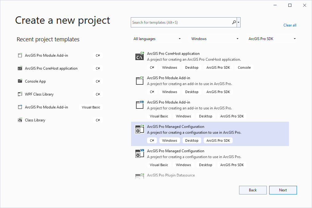

Step 1: Create a new Configuration using the Managed Configurations template
Open Visual Studio, select File | New | Project, drill down to Installed | Templates | Visual C# | ArcGIS | ArcGIS Pro Add-ins | ArcGIS Pro Managed Configuration. Name the solution "MyConfiguration".
ProGuide: Configuration Manager - Organizational Branding - Create New Project

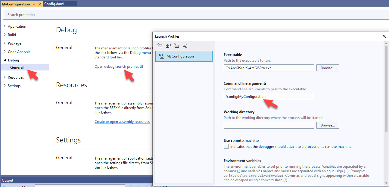

Step 2: Debugging a Configuration project
In Visual Studio build the project and open the properties page of the MyConfiguration project, select the Debug tab. Note that the ArcGISPro.exe is run using the /config:{configuration name} ArcGIS Pro command line parameter.
ProGuide: Configuration Manager - Debugging and using a Configuration
The Managed Configuration template adds the correct command line parameter to your project automatically. When the project is built, a configuration package with a .ProConfigX file extension is installed to the default location for configurations: C:\Users\<Username>\Documents\ArcGIS\AddIns\ArcGISPro\Configurations.
Note: If you change the name of your configuration in the project you must also change the name of the configuration in the command line switch on the Debug tab.
To debug, set breakpoints as normal and click 'start' to run the configuration (ensuring your active Visual Studio configuration is Active (Debug)).

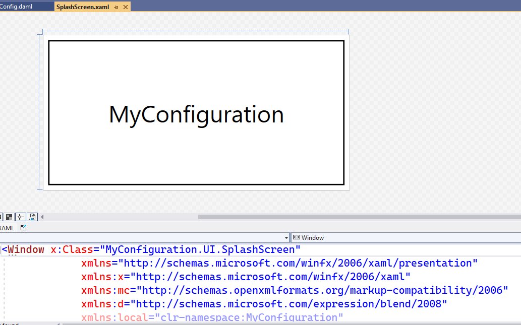

Step 3: Overriding the Splash Screen
Open "ConfigurationManager1.cs". Scroll to the OnShowSplashScreen override method. The Managed Configurations template will have added a default implementation of a splash screen window for you in "SplashScreen.xaml" that you can customize (or delete the callback or return null to retain the stock splash screen).
ProGuide: Configuration Manager - Overriding the Splash Screen

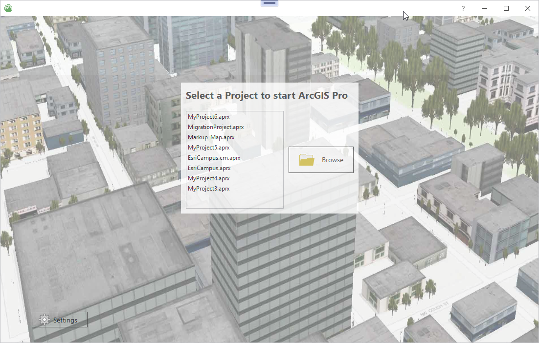

Step 4: Overriding the Startup Page
Open "ConfigurationManager1.cs". Scroll to the OnShowStartPage override method. The Managed Configurations template adds a default implementation of a startup page for you in "StartPage.xaml" that you can customize (or delete the callback or return null to retain the stock startup page). Configurations use the Model-View-ViewModel, MVVM, pattern so the startup page view also has a companion view model: "StartPageViewModel.cs". It is your responsibility to initialize the startup page datacontext with the view model for purposes of binding as shown here:
	if (_vm == null)
	  _vm = new StartPageViewModel();
	var page = new StartPage();
	page.DataContext = _vm;//Initialize the datacontext
	return page;
Your startup page is automatically closed when an ArcGIS Pro project file is opened. You do not have to close it:
	if (dlg.ShowDialog() ?? false)
	  var item = dlg.Items.FirstOrDefault();
	  if (item != null)
	    Project.OpenAsync(item.Path);//Automatically closes the startup page
ProGuide: Configuration Manager - Overriding the Startup Screen

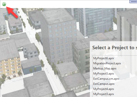

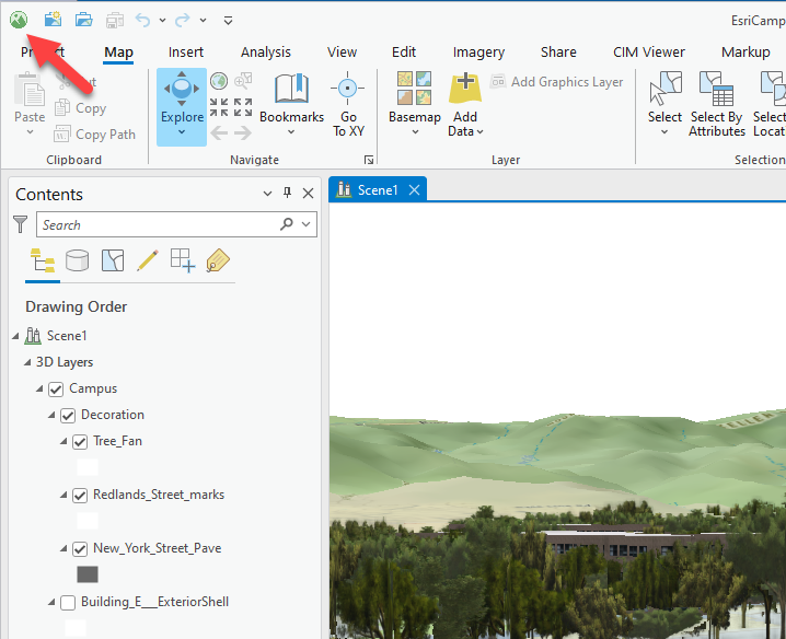

Step 5: Overriding the Application Icon
Open "ConfigurationManager1.cs". Scroll to the Icon and override it. By default, it shows the "favico.ico" that comes with the "new Configuration" template. The icon in the title bar is changed (it will revert back to the Pro icon though when the configuration is not run) but the icon in the Windows task bar is not changed. The task bar always shows the Pro icon. Changing the Icon is optional. Delete the property to use the Pro application default icon.
The Application Icon on Startup
ProGuide: Configuration Manager - The Application Icon on Startup
The Application Icon with a Project Open
ProGuide: Configuration Manager - The Application Icon and Name with a Project Open
Note: Use the full pack URI format as shown below. Set the icon file's build action to "Resource" in your Visual Studio project:

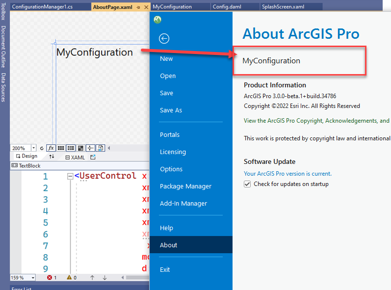

Step 6: Overriding the About Page
Open "ConfigurationManager1.cs". Scroll to the OnShowAboutPage override method. Optionally override this method to return a System.Windows.FrameworkElement (usually a User Control) that is hosted within the Pro about tab. The Managed Configurations template adds a default implementation of about page content for you in "AboutPage.xaml" that you can customize (or delete the callback to leave the stock about page unchanged).
ProGuide: Configuration Manager - Overriding the About Page

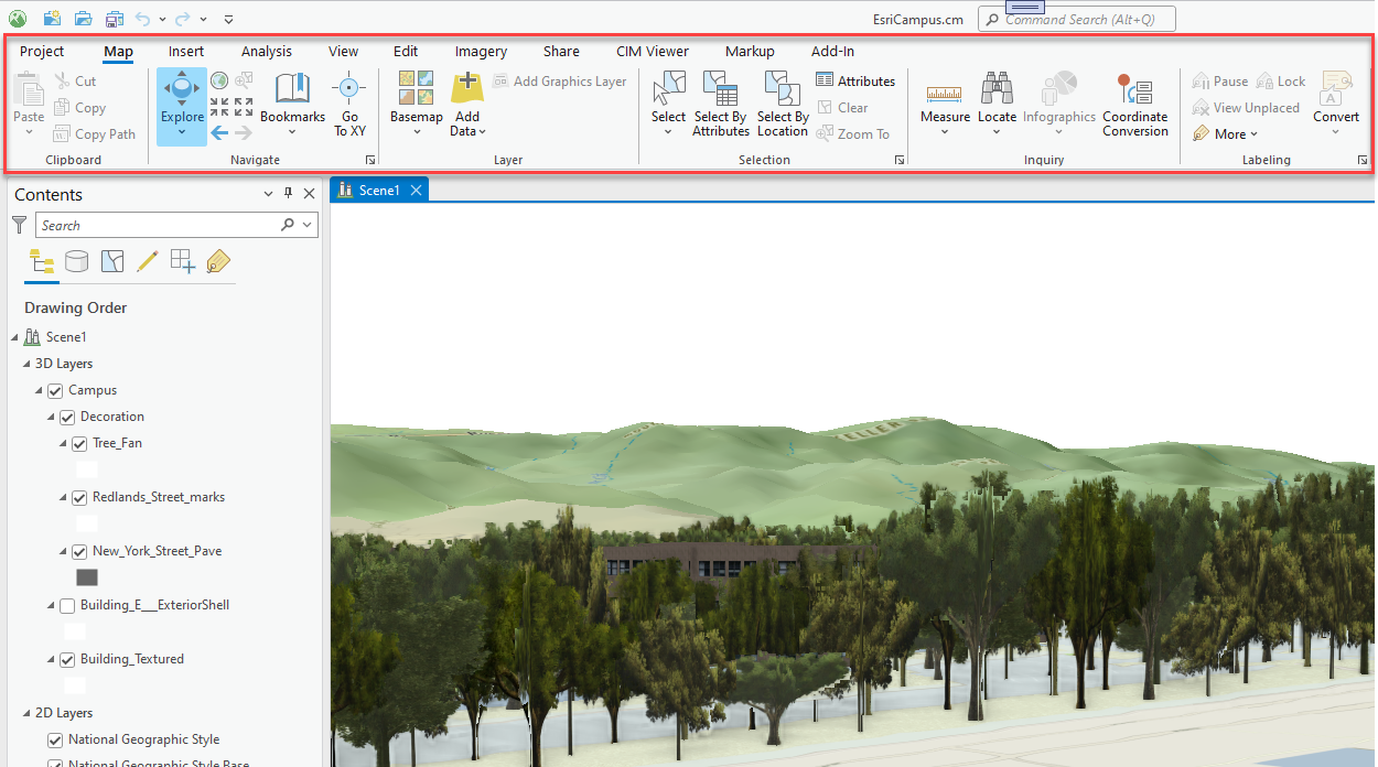

Open the MyConfiguration solution we built in the previous section. Click the Start button in Visual Studio to start a debug session. Note the default ArcGIS Pro Ribbon is unchanged (assuming other add-ins are not installed on your system).
ProGuide: Configuration Manager - Default ArcGIS Pro UI

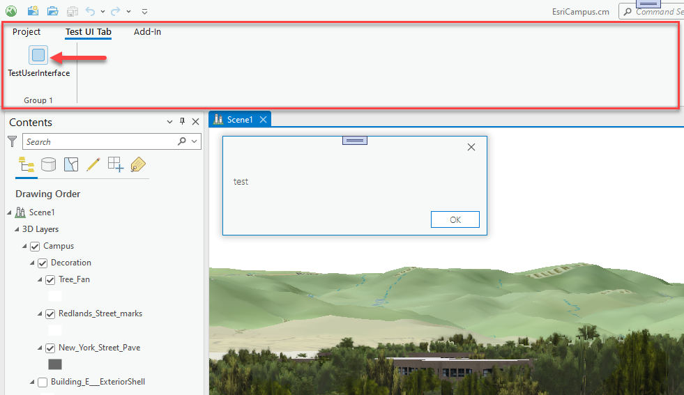

Step 3: Add Custom Tabs
We are going to add some custom controls and tabs to the Pro UI. Right click on the MyConfiguration project and select Add | New Item from the project context menu. Add an ArcGIS Pro Button to the configuration (select Visual C# Items | ArcGIS | ArcGIS Pro Add-ins | ArcGIS Pro Button). Name the button "TestUserInterface".
Open the newly added "TestUserInterface.cs" file. Add a MessageBox.Show("test"); line to its OnClick method.
Edit the project's "Config.daml" file. Add a new tab to the Config.daml. Ensure it contains a reference to the MyConfiguration_Group1 group:
<tabs>
  <tab id="MyConfiguration_Tab1" caption="Test UI Tab" keytip="Z0">
    <group refID="MyConfiguration_Group1"/>
  </tab>
</tabs>
Change appearsOnAddInTab="true" to appearsOnAddInTab="false" on the <group ...> element. We do not want to show the Add-ins tab on the Ribbon:
<groups>
  <group id="MyConfiguration_Group1" caption="Group 1" appearsOnAddInTab="false">
    <button refID="MyConfiguration_TestUserInterface" size="large" />
  </group>
</groups>
Next, we want to exclude our newly added tab from our removal code in our OnUpdateDatabase override. Notice the //Add your own id prefix here to skip deleting your own tabs comment in the OnUpdateDatabase override. Replace the existing if (id == null) continue; expression with if (id == null || id.Value.StartsWith("MyConfiguration")) continue; to skip our own tab element. Note: Change ...StartsWith("MyConfiguration") to be whatever is your own tab id prefix if it is different:
protected override void OnUpdateDatabase(XDocument database)
   foreach (var tabElement in tabElements)
      if (id == null || id.Value.StartsWith("MyConfiguration")) continue;//Skip our tabs
Save your changes and Build the project. Run the application from Visual Studio. Open a project. Verify that you see your "Test UI Tab" displayed on the Ribbon. Verify that all of Pros other standard tabs have been deleted from the ribbon. Click your custom TestUserInterface button. Your message box should be displayed.
ProGuide: Configuration Manager - Customized Pro UI and functionality
We have now changed the ArcGIS Pro user interface and functionality using a Managed Configuration. You can download the complete sample from ConfigWithMap community sample code
