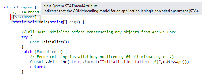

In your code, add the [STAThread] attribute above the console's static Main(string[] args) method. The presence of the STAThread attribute forces the application's primary thread to initialize as an STA thread the first time the application does any interoperability work with COM (for example, via the first call to a type in ArcGIS.Core.dll).
STAThread
Initialize the Host class before accessing any types within the ArcGIS.Core assembly. To initialize the Host class, call its static Initialize method:
class Program {
        //[STAThread] must be present on the Application entry point
        [STAThread]
        static void Main(string[] args) {
            //Call Host.Initialize before constructing any objects from ArcGIS.Core
            try {
                Host.Initialize();
            catch (Exception e) {
                // Error (missing installation, no license, 64 bit mismatch, etc.)
                Console.WriteLine(string.Format("Initialization failed: {0}",e.Message));
                return;
There is no return value. If initialization is successful, program execution will continue, and ArcGIS.Core functionality can be accessed. If initialization fails, a System.Exception will be thrown on the Initialize call.
