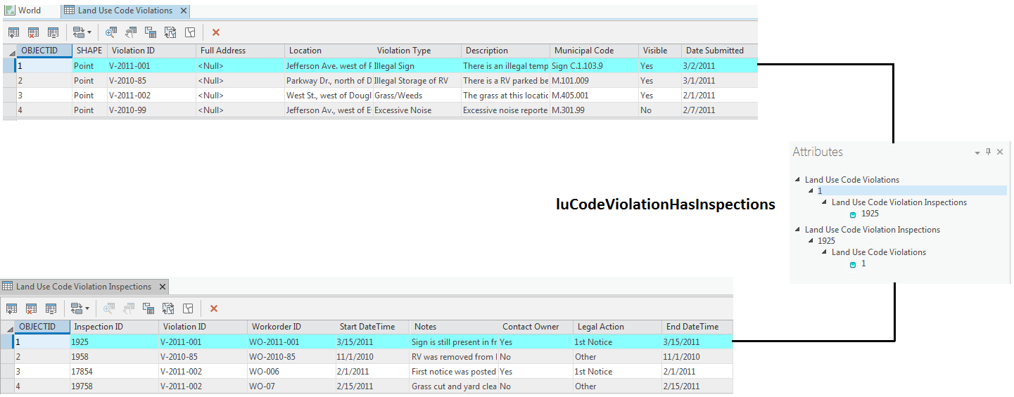

Relationship class
A GIS integrates information about various types of geographic and non-geographic entities, many of which can be related.
  • Geographic entities can relate to other geographic entities. For example, a building can be associated with a parcel.
  • Geographic entities can relate to non-geographic entities. For example, a parcel of land can be associated with an owner.
  • Non-geographic entities can relate to other non-geographic entities. For example, a parcel owner can be assigned a tax code.
Relationship classes in the geodatabase manage the associations between objects in one dataset (feature class or table) and objects in another. Objects at either end of the relationship can be features with geometry or records in a table.
Relationship classes help validate, and in some cases ensure, referential integrity. For example, the deletion or modification of one feature could delete or alter a related feature. Furthermore, a relationship class is stored in the geodatabase, which makes it accessible to anyone who uses the geodatabase. Relationship classes support the following cardinalities:
  • One-to-one
  • One-to-many
  • Many-to-many
Note: Many-to-many relationship classes are considered attributed relationship classes. They can still be opened as relationship classes, but they can also be opened as attributed relationship classes.
The ArcGIS.Core.Data.RelationshipClass object can be obtained from the Geodatabase object. If the name of the relationship class is known, it can be opened using the Geodatabase.OpenDataset<RelationshipClass> method:
RelationshipClass relationshipClass = geodatabase.OpenDataset<RelationshipClass>("RelClassName");
Alternatively, you can fetch all of the relationship classes between two tables or feature classes by using the OpenRelationshipClasses method. The first parameter is the origin table name or object and the second parameter is the destination table name or object. The return value is an IReadOnlyList of RelationshipClass objects, because there could be more than one relationship between the specified tables. Note that the order of the parameters makes a difference as to what relationship classes are returned.
IReadOnlyList<RelationshipClass> relationshipClasses = geodatabase.OpenRelationshipClasses("SourceTableName", "DestinationTableName");
IReadOnlyList<RelationshipClass> relationshipClassesAlternate= geodatabase.OpenRelationshipClasses(sourceTableObject, destinationTableObject);
If using a feature service geodatabase, the table names should be layer ID strings or the names of the feature classes as they are exposed via the feature service.
IReadOnlyList<RelationshipClass> srcToDestRelClasses = geodatabase.OpenRelationshipClasses("0", "2"));
IReadOnlyList<RelationshipClass> srcToDestRelClassesAlternate = geodatabase.OpenRelationshipClasses("L3States", "L2Counties");
For more information on working with relationship classes, see Working with relationship classes.

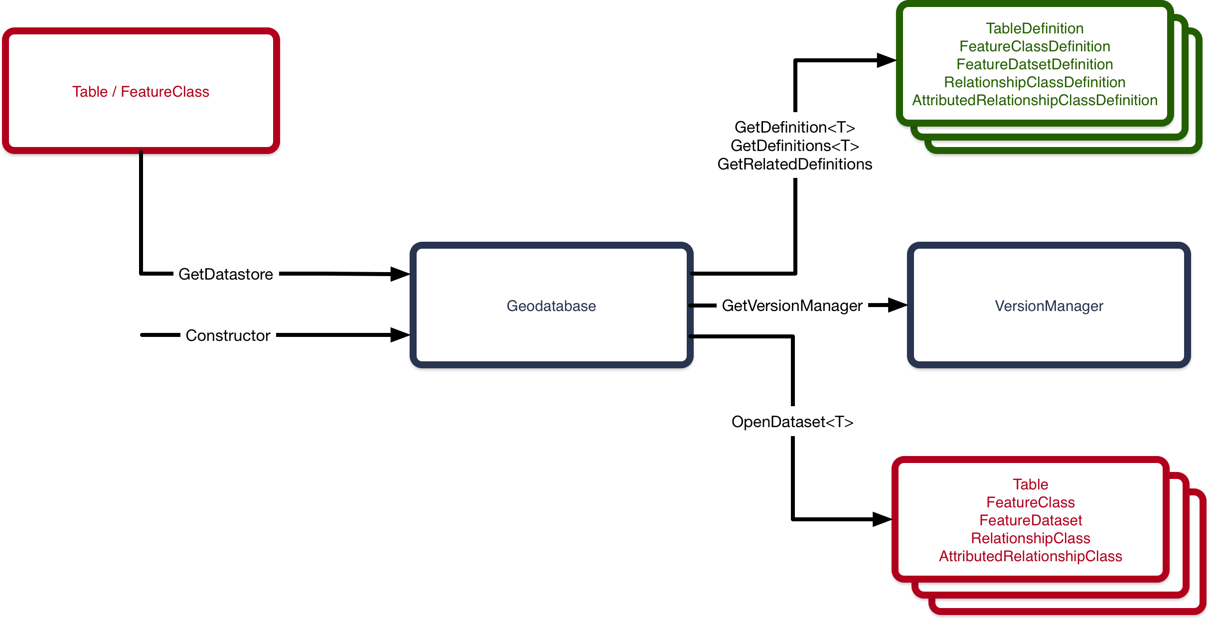

Definitions
Definition is a concept that represents the metadata about the dataset. While the dataset provides a way to access the data that it encapsulates, the definition describes the dataset's schema, unique properties associated with it, and so on.
Note: Definition is an abstraction that is conceptually equivalent to DataElement in the ArcObjects API.
It should be noted that all classes that inherit from the ArcGIS.Core.Data.Dataset abstract class have methods that provide the behaviors unique to that dataset. However, all metadata must be accessed through the Definition abstract class.
One reason for separating metadata into a Definition is that opening a Definition is a lightweight operation compared to opening a dataset. For example, if you only need information about polyline feature classes, getting and filtering definitions is more efficient than opening all the feature classes to do the same.
The classes that inherit from the Definition abstract class are as follows:
  • TableDefinition—Metadata for an ArcGIS.Core.Data.Table dataset. Some major objects accessible from TableDefinition are Fields, Subtypes, Indexes, names of the ObjectIDField, SubtypeField, GlobalIDField, and so on.
  • FeatureClassDefinition—Inherits from TableDefinition and has additional access to metadata specific to FeatureClasses, especially methods to access ShapeField, ShapeType, SpatialReference, Area, Length, and so on.
  • FeatureDatasetDefinition—Metadata that provides access to the SpatialReference and Extent of the FeatureDataset.

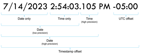

Diagram of the date and time data type components.

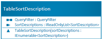

Sorting Tables
The geodatabase also provides the ability to create row cursors in a sorted order. This is accomplished through the Table.Sort() method. Sort takes a TableSortDescription object as an argument, which combines a QueryFilter and a set of SortDescriptions.
The SortDescription class allows sorting on a particular field. Properties on this object allow the caller to specify whether the sort is ascending or descending, and case-sensitive or case-insensitive.
The following snippet sorts a World Cities table by country name and then by city name:
public RowCursor SortWorldCities(FeatureClass worldCitiesTable)
  using (FeatureClassDefinition featureClassDefinition = worldCitiesTable.GetDefinition())
    Field countryField = featureClassDefinition.GetFields().First(x => x.Name.Equals("COUNTRY_NAME", StringComparison.OrdinalIgnoreCase));
    Field cityNameField = featureClassDefinition.GetFields().First(x => x.Name.Equals("CITY_NAME", StringComparison.OrdinalIgnoreCase));
    // Create SortDescription for Country field
    SortDescription countrySortDescription = new SortDescription(countryField);
    countrySortDescription.CaseSensitivity = CaseSensitivity.Insensitive;
    countrySortDescription.SortOrder = SortOrder.Ascending;
    // Create SortDescription for City field
    SortDescription citySortDescription = new SortDescription(cityNameField);
    citySortDescription.CaseSensitivity = CaseSensitivity.Insensitive;
    citySortDescription.SortOrder = SortOrder.Ascending;
    // Create our TableSortDescription
    TableSortDescription tableSortDescription = new TableSortDescription(new List<SortDescription>() { countrySortDescription, citySortDescription });
    return worldCitiesTable.Sort(tableSortDescription);

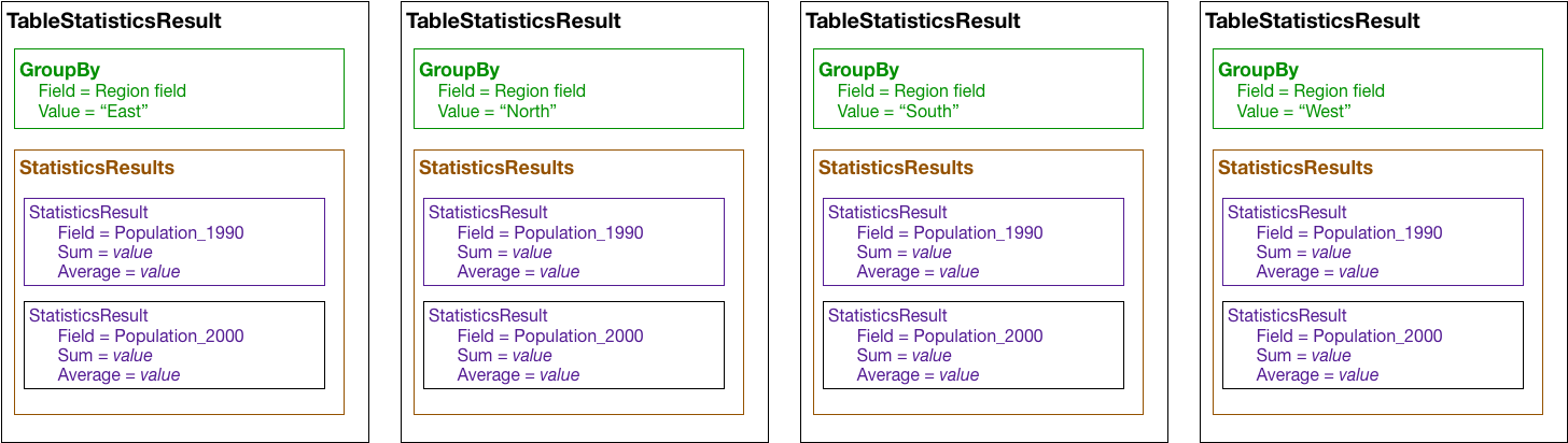

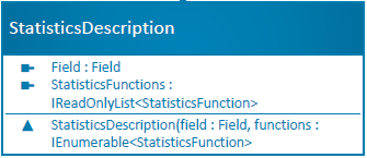

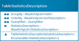

Calculating Statistics
The geodatabase provides powerful tools to calculate statistics on table fields. These statistics are computed on the server if supported. Statistics are calculated by calling the CalculateStatistics() method on the Table class.
CalculateStatistics() takes a TableStatisticsDescription object to specify how the statistics should be calculated.
The QueryFilter property allows the table rows to be filtered before statistics are calculated. The optional GroupBy property groups the rows together, and the optional OrderBy property sorts those groups. If the underlying datastore does not support Group By and Order By, for example shapefiles, these properties are ignored.
Finally, the StatisticsDescriptions property contains a set of statistics to calculate.

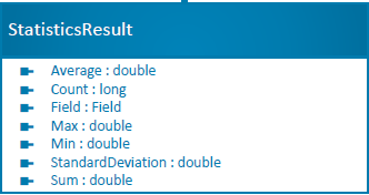

The StatisticsDescription class allows the caller to specify a set of different functions to calculate on a given field. The classes above can be used to calculate multiple statistics on multiple fields in a single call to Table.CalculateStatistics().

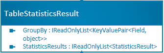

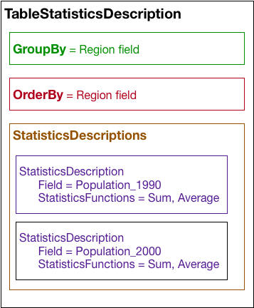

The return value is a set of TableStatisticsResult objects. If no GroupBy was specified, or if the underlying datastore doesn't support GroupBy, one TableStatisticsResult is returned. Otherwise, one TableStatisticsResult instance is returned for each field grouping.
The GroupBy property on the TableStatisticsResult object describes the grouping that was returned. The key-value pair represents the Field and value of that field for the group. One key-value pair is returned for each field in the original GroupBy.
The StatisticsResults list contains a list of the statistics that were calculated.
In the StatisticsResults object, only the appropriate properties are filled in, based on which statistics were requested for each field.
For example, consider a Country table that contains three fields of interest— Region, Population_1990, and Population_2000. There are four regions, "North", "South", "East" and "West." For each of these regions we want to compute the sum and average of the Population_1990 and Population_2000 fields. To perform this calculation, assemble a TableStatisticsDescription as follows:
The Table.CalculateStatistics() method would return a list of TableStatisticsResults objects like the following:
The following code sample matches the example above:
// Calculate the Sum and Average of the Population_1990 and Population_2000 fields, grouped and ordered by Region
public void CalculateStatistics(FeatureClass countryFeatureClass)
  using (FeatureClassDefinition featureClassDefinition = countryFeatureClass.GetDefinition())
    // Get fields
    Field regionField = featureClassDefinition.GetFields().First(x => x.Name.Equals("Region"));
    Field pop1990Field = featureClassDefinition.GetFields().First(x => x.Name.Equals("Population_1990"));
    Field pop2000Field = featureClassDefinition.GetFields().First(x => x.Name.Equals("Population_2000"));
    // Create StatisticsDescriptions
    StatisticsDescription pop1990StatisticsDescription = new StatisticsDescription(pop1990Field, new List<StatisticsFunction>() { StatisticsFunction.Sum, StatisticsFunction.Average });
    StatisticsDescription pop2000StatisticsDescription = new StatisticsDescription(pop2000Field, new List<StatisticsFunction>() { StatisticsFunction.Sum, StatisticsFunction.Average });
    // Create TableStatisticsDescription
    TableStatisticsDescription tableStatisticsDescription = new TableStatisticsDescription(new List<StatisticsDescription>() { pop1990StatisticsDescription, pop2000StatisticsDescription });
    tableStatisticsDescription.GroupBy = new List<Field>() { regionField };
    tableStatisticsDescription.OrderBy = new List<SortDescription>() { new SortDescription(regionField) };
    // Calculate Statistics
    IReadOnlyList<TableStatisticsResult> statisticsResults = countryFeatureClass.CalculateStatistics(tableStatisticsDescription);
    // Code to process results goes here...

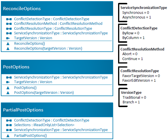

Versioning
Versioning allows multiple users to edit spatial and tabular data simultaneously in a long transactional environment. Users can directly modify the database without having to extract data or lock features in advance.
The following are the five primary capabilities provided by the API:
  • List all versions in a geodatabase, including version properties
  • Connect to a specific version
  • Create a new version
  • List the differences between Tables and FeatureClasses from different versions
  • Reconcile and post

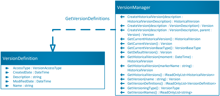

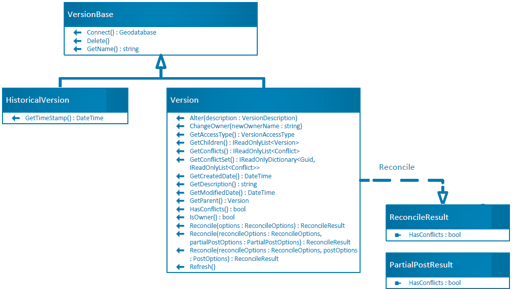

The VersionManager object can be accessed from the Geodatabase object. VersionManager provides access to the currently connected version; a list of historical versions; and a list of all public versions, protected versions, and private versions owned by the currently connected user. VersionManager is only accessible if the IsVersioningSupported method on the Geodatabase object returns true. The type of versioning in use by a particular geodatabase, branch or traditional, can be determined by calling VersionManager.GetVersioningType().
The VersionBase class represents either a Version or a HistoricalVersion in a Geodatabase. The VersionManager.GetCurrentVersionBaseType() returns whether the current geodatabase is connected to a Version or a HistoricalVersion.
The versions returned are ArcGIS.Core.Data.Version objects, which provide access to the following:
  • Attributes such as name, access type, and description
  • Parent version object
  • List of child version objects
  • Whether the current user is the owner of the version
To connect to a version represented by a Version object obtained from VersionManager, you can call the Connect method on the Version object, which returns the corresponding Geodatabase object so that datasets in that version of the geodatabase can be obtained.
The GetVersionDefinitions() method in the VersionManager class returns a list of VersionDefinition objects, each containing attributes associated with the version. Similarly, the GetVersionNames() method provides a list of version names. If the objective is to display a list of applicable versions, this method is quick and efficient. The name can later be used to get the Version by calling VersionManager.GetVersion(string).
To create a new version, a VersionDescription should be created with the appropriate properties. This version description is passed to CreateVersion on the VersionManager class. This creates a new version that is a child of Default. If using traditional (not branch) versioning, an overload allows versions to be created that are children of other versions.
To find differences, one workflow could be as follows:
  1. Get the Geodatabase object using one of the methods described in Geodatabase.
  2. Use VersionManager to find the other Version object of interest.
  3. Get the Geodatabase object for the other version using Connect().
  4. Open the corresponding Table/FeatureClasses from both Geodatabase objects.
  5. Get the DifferenceCursor using the Differences method.
The type of difference can be specified as a parameter to the Differences method using the ArcGIS.Core.Data.DifferenceType enum.
On feature service workspaces, only branch versioning with ArcGIS Enterprise 10.7 or higher is supported. The source table must be from a child branch and the target table must be from DEFAULT. The difference type DeleteNoChange will return deletions made in the child version, Insert will return inserts made in the child version, and UpdateNoChange will return all updates in the child version. No other difference types are supported.
using (Geodatabase geodatabase = new Geodatabase(new DatabaseConnectionFile(new Uri("path\\to\\sde\\file\\sdefile.sde"))))
using (VersionManager versionManager = geodatabase.GetVersionManager())
  IReadOnlyList<Version> versionList = versionManager.GetVersions();
  IReadOnlyList<Version> childVersionList = null;
  try
    IEnumerable<Version> publicVersions = versionList.Where(version => version.GetAccessType() == VersionAccessType.Public);

Reconcile and Post edits
Retrieving changes from an ancestor version is called Reconcile, while merging edits into that version is called Post. After editing a child version, you can merge your changes into another version. In traditional versioning, you can merge changes into any ancestor version, such as the parent or Default version. In branch versioning, you can merge only to the Default version.
Reconcile and post edits in child versions are accomplished by multiple overloads of the Reconcile method in the Version class. The following table summarizes the operations supported by each versioning type.
Method Traditional Branch Description
Reconcile (ReconcileOptions) ✔ ✔ Reconcile the child version. For ArcGIS Pro add-in, use ReconcileInEditOperation (Version, ReconcileOptions)
Reconcile (ReconcileOptions, PostOptions) ✔ ✔ Reconcile and post the child version. For ArcGIS Pro add-in, use ReconcileInEditOperation (Version, ReconcileOptions, PostOptions)
Reconcile (ReconcileOptions, PartialPostOptions) X ✔ Reconcile and partial-post the child version. For ArcGIS Pro add-in, use ReconcileInEditOperation (Version, ReconcileOptions, PartialPostOptions)
PostInEditOperation (Version, PostOptions) ✔ ✔ Post the child version. Intended to use in ArcGIS Pro add-in.
PartialPostInEditOperation (Version, PartialPostOptions) X ✔ Partial post the child version. Intended to use in ArcGIS Pro add-in.
GetConflicts() ✔ ✔ Gets a list of conflicts during reconcile
Post(PostOptions) X X Doesn't work. Obsolete since Pro 3.6 and Arcgis Enterprise 12.0
The PostOptions object specifies service synchronization type (whether or not post should run synchronously), and the target version (use null to specify the default version) to post.
The ReconcileOptions object specifies the conflict resolution method (abort or continue if conflicts are found), conflict detection type (by row or by column), and the target version (use null to specify the default version) to reconcile.
When you reconcile, the version you are editing is updated with changes from the target version. It does not merge changes into the target version. After finishing the reconciliation and reviewing conflicts, you complete the merge by posting your changes to the target version.
When using traditional versioning, you can also specify whether to resolve conflicts in favor of the target or edit version by setting the conflict resolution type.
The owner of a branch version can be changed by calling the Version.ChangeOwner routine.
Partial posting
Partial posting enables developers to submit only selected changes from a version. The Reconcile (ReconcileOptions, PartialPostOptions) method is used to post edits from a child version. For example, an electric utility may use a version to design facilities for a new housing subdivision. When one block is completed, and the rest remains under construction, partial posting allows users to post the finished work while retaining unbuilt features in the version for future posting.
The Selections property of PartialPostOptions specifies which features are posted. It also defines the types of conflict detection and service synchronization. The PartialPostOptions.Selections property holds a list of ObjectID-based selections. For updates and inserts, creating these selections is relatively straightforward. For example, you may use a ConstructedStatus field on your feature classes to indicate that a feature is ready to be posted:

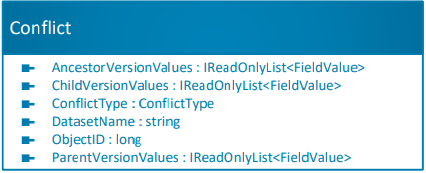

Conflicts
During a reconcile operation, the changes made in the child version are compared with the target version into which you want to merge. If conflicts exist, the Version.GetConflicts() method returns a list of Conflict objects for the target version. The Conflict class contains information about the differences between the two versions by a row's ObjectID, including conflict types and before-and-after row values.
The Version.GetConflicts() method enables access to conflicts from both traditional and branch-versioned datastores.
The following operations can be performed on RelationshipClass:

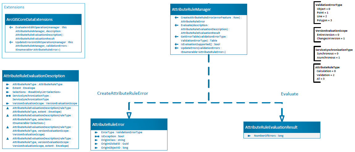

The Attribute Rule Manager
The central class for dealing with attribute rules in the Pro SDK is the AttributeRuleManager class. This object can be obtained by calling the GetAttributeRuleManager() method on the Geodatabase class. The IsAttributeRuleSupported() method described above should be first checked to ensure that the geodatabase supports attribute rules.
There are several different types of attribute rules. Immediate calculation and constraint rules are supported on multiple geodatabase types, and fire automatically when creating, updating, or deleting rows.
Some types of geodatabases support batch calculation and validation rules. These rules are executed by calling the EvaluateInEditOperation() extension method on the AttributeRuleManager class. To determine if a database supports evaluation, the IsEvaluationSupported() method should be called before proceeding.
Attribute Rule Evaluation
The EvaluateInEditOperation() method is used to execute attribute rules. The parameters passed in to a call to EvaluateInEditOperation() are specified by the AttributeRuleEvaluationDescription class. Supported combinations are enforced through the use of a limited number of constructors.
Property Description
AttributeRuleType The AttributeRuleType parameter can be used to run batch calculation rules, validation rules, or both.
Extent The extent parameter is used to control which features are evaluated. If missing, the entire extent is evaluated.
Selections A list of one or more selections, specifying the features to evaluate. The default value is an empty list.
VersionEvaluationScope The VersionEvaluationScope parameter specifies whether to evaluate all of the rows in the version, or only those rows that have been changed within that version.
The EvaluateInEditOperation() method returns an AttributeRuleEvaluationResult object, which is used to determine the number of errors found.
Using the Asynchronous Service
When called on a feature service, the EvaluateInEditOperation() method makes a call to a REST endpoint, which runs synchronously. This routine has low processing overhead. Unfortunately, it is also susceptible to server timeouts if processing takes too long. To work around this, the Evaluate REST endpoint provides an asynchronous version of this routine. Processing is offloaded from the Validation Server to the Geoprocessing Server. While this does cause a performance hit, the Geoprocessing Server is designed to handle long-running jobs and is not susceptible to timeouts. With this service, ArcGIS Pro will poll the service until the operation completes. Because many evaluation calls run against a large number of features, the asynchronous version is the default.
The ServiceSynchronizationType parameter on AttributeRuleEvaluationDescription allows control over which version of the service is called. This uses the ServiceSynchronizationType enum, which has two values: Synchronous and Asynchronous. It's important to note that from a C# developer's perspective, this routine is still a synchronous C# method, regardless of this parameter. Like other methods in the API, it blocks the current thread until the operation completes.
If writing a CoreHost application, use the Evaluate() base method on the AttributeRuleManager class. This routine provides its own transaction management; therefore, it cannot be issued inside an edit operation created by Geodatabase.ApplyEdits().
Attribute Rule Errors
If attribute rule validation fails, errors are written into a set of error tables. Likewise, if a problem occurs with running a batch calculation rule, an error is also written to these tables. There are four error tables that are used, based on the geometry of the source feature class or table. These error tables are visible in the Pro user interface, and can also be accessed in the Pro SDK with the GetErrorTable() method on the AttributeRuleManager. Once obtained, these tables can be read and queried like any other geodatabase table. Each row in these tables represents an error.
The CreateAttributeRuleError() routine takes a row from one of the error tables and uses it to generate an AttributeRuleError object. This object provides a more user-friendly view of the table. One key piece of functionality is that this object can be used to fetch the features that caused the error to be created. The OriginClass property returns the table or feature class name, which can be used to open the table using Geodatabase.OpenDataset(). The OriginGlobalID or OriginObjectID properties on the AttributeRuleError class can be used to fetch the specific row that caused the error.
The attribute rule error tables are, for the most part, read-only. New rows can only be created by running EvaluateInEditOperation() on features that fail validation. Rows can only be deleted by fixing the underlying problem that caused the error feature and re-running EvaluateInEditOperation(). The only update that can be made to these tables is to mark an error as an exception. This is used to indicate to the system that the error represents an exceptional case, and shouldn’t be treated as an error. Errors can be marked as exceptions by setting the IsException property on the AttributeRuleError class and then passing a list of these to the UpdateErrorsInEditOperation() extension method on the AttributeRuleManager.
If writing a CoreHost application, use the UpdateErrors() base method on the AttributeRuleManager class. This routine provides its own transaction management; therefore, it cannot be issued inside an edit operation created by Geodatabase.ApplyEdits().

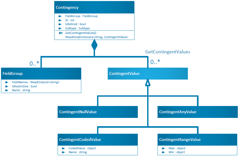

Contingent Values
Contingent values are a data design feature that allows the values of one field to depend on the values of another field. A field with a domain forces an editor to select from a valid list of values, but with contingent values, you can go a step further to limit the list of values based on other fields. Several fields are linked together in a field group and combinations of contingent values are defined within the field group. When editing, instead of seeing the entire list of domain values, you only see the contingent values. Thus, contingent values help enforce data integrity by applying additional constraints to reduce the number of valid inputs.
Contingent values can be accessed from the Contingency class using the GetContingentValues() method, which returns a dictionary of ContingentValue by the FieldGroup name. The ContingentValue is a base class that defines a possible value for a field participating in a field group. A contingent value can be one of the following:
  • ContingentCodedValue — A value from a coded value domain.
  • ContingentRangeValue — Defines maximum and minimum range domain values.
  • ContingentAnyValue — Indicates that any value in the field's domain is considered valid (as well as null).
  • ContingentNullValue — Indicates that a null value is valid for the field.
A FieldGroup includes the names of the fields that support contingencies and their restrictions.
The GetContingencies() method in the TableDefinition or FeatureClassDefinition class returns a list of Contingency objects applied to the dataset.
using (TableDefinition tableDefinition = table.GetDefinition())
  IReadOnlyList<Contingency> contingencies = tableDefinition.GetContingencies();
  foreach (Contingency contingency in contingencies)
    // Field group
    FieldGroup filedGroup = contingency.FieldGroup;
    string fieldGroupName = filedGroup.Name;
    IReadOnlyList<string> fieldInFieldGroup = filedGroup.FieldNames;
    bool isEditRestriction = filedGroup.IsRestrictive;
    int contingencyId = contingency.ID;
    Subtype subtype = contingency.Subtype;
    bool isContingencyRetired = contingency.IsRetired;
    // Contingent values
    IReadOnlyDictionary<string, ContingentValue> contingentValuesByFieldName = contingency.GetContingentValues();
    foreach (KeyValuePair<string, ContingentValue> contingentValueKeyValuePair in contingentValuesByFieldName)
      string attributeFieldName = contingentValueKeyValuePair.Key;
      // Contingent value type associated with the attribute field
      ContingentValue contingentValue = contingentValueKeyValuePair.Value;
      switch (contingentValue)
        case ContingentCodedValue contingentCodedValue:
          string codedValueDomainName = contingentCodedValue.Name;
          object codedValueDomainValue = contingentCodedValue.CodedValue;
          break;
        case ContingentRangeValue contingentRangeValue:
          object rangeDomainMaxValue = contingentRangeValue.Max;
          object rangeDomainMinValue = contingentRangeValue.Min;
          break;
        case ContingentAnyValue contingentAnyValue:
          // Any value type
          break;
        case ContingentNullValue contingentNullValue:
          // Null value
          break;
Additionally, the Table.GetContingentValues method retrieves a list of potential contingent values for a given RowBuffer and attribute field.
using (RowBuffer rowBuffer = parcels.CreateRowBuffer())
  IReadOnlyDictionary<FieldGroup, IReadOnlyList<ContingentValue>> possibleZonings = parcels.GetContingentValues(rowBuffer, "Zone");
  IEnumerable<FieldGroup> possibleFieldGroups = possibleZonings.Keys;
  foreach (FieldGroup possibleFieldGroup in possibleFieldGroups)
    IReadOnlyList<ContingentValue> possibleZoningValues = possibleZonings[possibleFieldGroup];

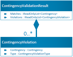

The Table.ValidateContingencies method validates a row against contingent values and returns the ContingencyValidationResult, which provides information about matched (valid) and violated (invalid) contingency constraints.
  // Insert values in a row buffer
  rowBuffer["Zone"] = "Business";
  rowBuffer["TaxCode"] = "TaxB";
  // Validate contingency values of the parcels' row
  ContingencyValidationResult contingencyValidationResult = parcels.ValidateContingencies(rowBuffer);
  // Valid contingencies
  IReadOnlyList<Contingency> matchedContingencies = contingencyValidationResult.Matches;
  if (matchedContingencies.Count > 0)
    // Create a row with valid contingency values
    parcels.CreateRow(rowBuffer);
  // Invalid contingencies
  IReadOnlyList<ContingencyViolation> violatedContingencies = contingencyValidationResult.Violations;
  foreach (ContingencyViolation contingencyViolation in violatedContingencies)
    ContingencyViolationType violationType = contingencyViolation.Type;
    Contingency violatedContingency = contingencyViolation.Contingency;
A Contingency can be retired. When it retires, it should remain in existing data but not be available for editing.
