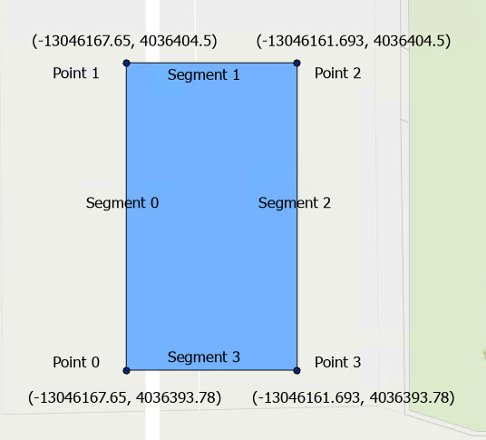

The polygon you're going to build is a rectangle:
Build A Rectangle
The polygon consists of four points with four linear segments connecting the points. The points are described by their coordinates containing the x and y values for the location using the Web Mercator spatial reference.
Looking at the PolygonBuilderEx class, you'll notice multiple overloaded constructors helping you to initialize the builder. At the same time, you'll also notice static convenience methods that allow you to fully describe the state of the geometry and produce a geometry in a single line of code.
The polygon is described by the four corners, so you need to create the points first. Points are geometries of type MapPoint and use a builder class of type MapPointBuilderEx. The MapPoint class contains the location values and the spatial reference information. The SpatialReference is immutable as well and uses a similar builder approach as the other types of geometry.
Light-weight alternatives, Coordinate2D and Coordinate3D, are also available. These structs are useful when you want to avoid the overhead of creating a MapPoint for use in the construction of a higher-level geometry such as a Polygon or Polyline. Because they are structs, Coordinate2D and Coordinate3D possess the same advantages as immutable geometries with respect to thread safety. Coordinate2D and Coordinate3D can be freely passed to any thread within ArcGIS Pro.
With this information, you can now create the polygon with the following code using Coordinate2D:

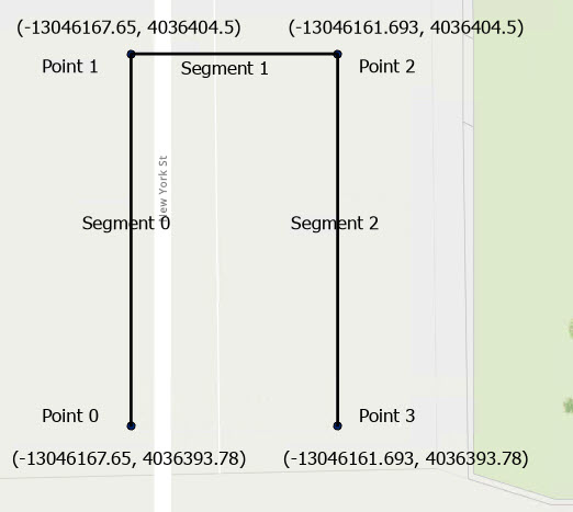

Based on the previous explanation, consider the difference if you used a polyline builder as opposed to a polygon builder with the same set of points.
// Create a spatial reference using the WKID (well-known ID)
// for the Web Mercator coordinate system.
SpatialReference mercatorSR = SpatialReferenceBuilder.CreateSpatialReference(3857);
// Create a list of coordinates describing the polyline vertices.
var vertices = new List<Coordinate2D>();
vertices.Add(new Coordinate2D(-13046167.65, 4036393.78));
vertices.Add(new Coordinate2D(-13046167.65, 4036404.5));
vertices.Add(new Coordinate2D(-13046161.693, 4036404.5));
vertices.Add(new Coordinate2D(-13046161.693, 4036393.78));
// Use the builder to create the polyline object.
Polyline polyline = PolylineBuilderEx.CreatePolyline(vertices, mercatorSR);
The result is now the following:
Rectangle with PolylineBuilderEx
The line geometry has one part, containing only the original four points and three linear segments you provided. The fourth segment was not created by the builder.

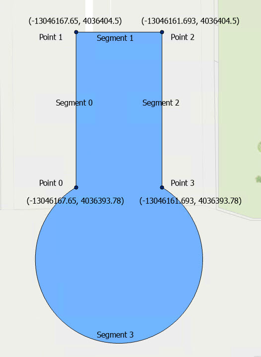

Changing segments in a geometry
From the Polygon class, you get read-only access to the parts of the polygon. Polygon parts, or rings, can be retrieved as either segment collections or point collections derived from the segment collection vertices. The builder classes allow read-write access to the properties of a geometry.
Using the builder class, you can add and remove segments to reshape the geometry. Here you remove the last segment indicated by the -1 argument. You replace the deleted segment with an elliptic arc constructed with three points, which you add at the end of the polygon builder segment collection, effectively closing the geometry.
// Replace the last segment, a line segment, from the 1st part of the polygon
// with an elliptic arc segment.
// Create a coordinate through which the elliptic arc needs to pass.
var interiorCoordinate = new Coordinate2D(-13046164.6, 4036383);
// Build a new segment of type EllipticArc.

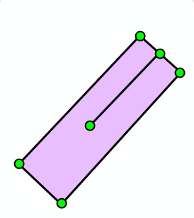

var arcSegment = EllipticArcBuilderEx.CreateCircularArc(corner4Point, corner1Point, interiorCoordinate);
// Replace the line segment with the new segment.
polygonBuilder.ReplaceSegment(0, -1, arcSegment);
The resulting polygon looks like this:
Resulting polygon

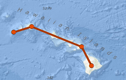

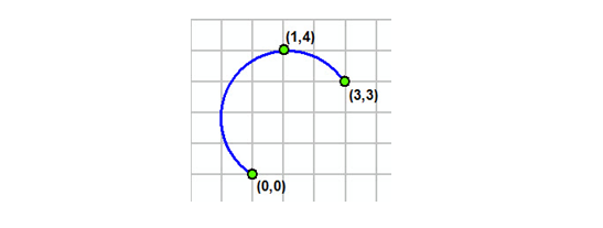

  1. A polyline which is a circular arc from (0, 0) to (3, 3) through (1, 4).
{"curvePaths": [[[0,0], {"c": [[3,3], [1,4]]}]]}
Polyline 1

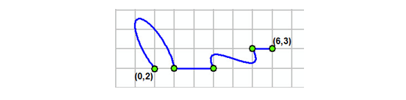

  1. A polyline containing a line segment from (6, 3) to (5, 3), a Bézier curve from (5, 3) to (3, 2) with control points (6, 1) and (2, 4), a line segment from (3, 2) to (1, 2) and an elliptic arc from (1, 2) to (0, 2) with center point (0, 3), minor = 0, clockwise = 0, rotation = 2.094395102393195 (120 degrees), semi-major axis = 1.78, ratio = 0.323.
  "curvePaths":
    [6,3], [5,3],
    {"b": [[3,2], [6,1], [2,4]]},
    [1,2],
    {"a": [[0,2], [0,3],0,0,2.094395102393195,1.78,0.323]}
Polyline 2

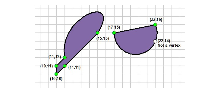

A multipart polygon with m-values. The first part contains three line segments, a Bézier curve from (11, 12) to (15, 15) with control points (10, 17) and (18, 20) which is closed with a line segment to (11, 11). The second part contains a circular arc from (22, 16) to (17, 15) through (22, 14) which is closed with a line segment to (22, 16).
  "hasM": true,
  "curveRings":
      [11,11,1], [10,10,2], [10,11,3], [11,12,4],
      {"b": [[15,15,5], [10,17], [18,20]]},
      [11,11,1]
      [22,16,1],
      {"c": [[17,15,2], [22,14]]},
      [22,16,1]
Polygon

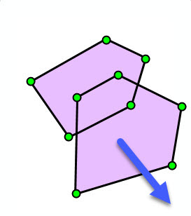

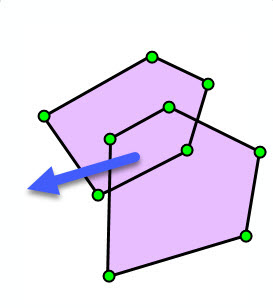

// Move an existing polygon in the y-direction.
var movedPolygon = GeometryEngine.Instance.Move(polygon, 0, 15) as Polygon;
Because geometries are immutable, the resulting movedPolygon is a new geometry instance.

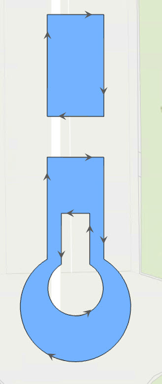

var finalPolygon = GeometryEngine.Instance.Difference(polygonBuilder.ToGeometry(), smallerPolygon);
The difference operation will cut a hole out of the polygonBuilder geometry. You'll use the subtracted area of the hole as your third part of the finalPolygon geometry describing an interior part. The segments of the interior part are oriented counter-clockwise.
The resulting polygon geometry and the orientation of the segments looks like the following:
Final Polygon

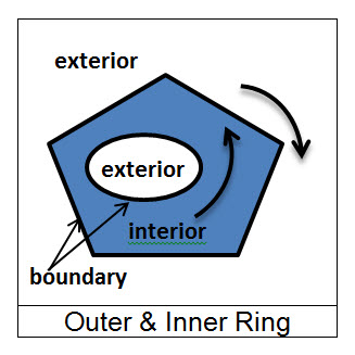

Interiors, boundaries, and exteriors
Each type of geometry has an interior, a boundary, and an exterior, which are important in understanding relational operators.
  • Point—A point represents a single location in space. The interior of a point is the point itself, the boundary is the empty set, and the exterior is all other points.
  • Multipoint—A multipoint is an ordered collection of points. The interior of a multipoint is the set of points in the collection, the boundary is the empty set, and the exterior is the set of points that are not in the collection.
  • Polyline—A polyline is an ordered collection of paths where each path is a collection of contiguous segments. A segment has a start and an end point. The boundary of a polyline is the set of start and end points of each path, the interior is the set of points in the polyline that are not in the boundary, and the exterior is the set of points that are not in the boundary or the interior. For the polyline shown below, the set of points comprising the boundary is shown in red. The interior of the polyline is shown in black.
  • Polygon—A polygon is defined by a collection of rings. Each ring is a collection of contiguous segments such that the start point and the end point are the same.
The boundary of a polygon is the collection of rings by which the polygon is defined. The boundary contains one or more outer rings and zero or more inner rings. An outer ring is oriented clockwise, while an inner ring is oriented counter-clockwise. Imagine walking clockwise along an outer ring. The area to your immediate right is the interior of the polygon and to your left is the exterior.
Similarly, if you were to walk counter-clockwise along an inner ring, the area to your immediate right is the interior of the polygon and to your left is the exterior.

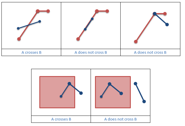

  • Crosses—Two polylines cross if they meet at points only, and at least one of the shared points is internal to both polylines. A polyline and polygon cross if a connected part of the polyline is partly inside and partly outside the polygon.

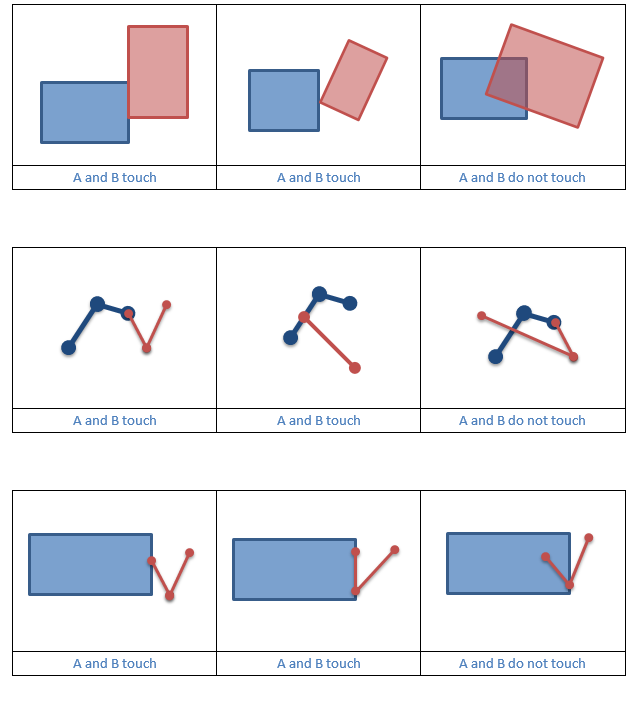

  • Touches—Geometry A touches Geometry B if the intersection of their interiors is empty, but the intersection of Geometry A and Geometry B is not empty

Example 3: Does Geometry A touch Geometry B?
Recall that two geometries, A and B, touch if the intersection of their interiors is empty, but the intersection of A and B is not empty. The first requirement is that the intersection of their interiors, I(A)∩I(B), is empty. Given the first requirement, what does it mean to say that the intersection of A and B is not empty? It means that one of the following must be true:
  • Boundary of A intersect interior of B is not empty
  • Interior of A intersect boundary of B is not empty
  • Boundary of A intersect boundary of B is not empty

Cut5
Intersects with conflicting edge classifications
  • Cutter parts that overlap in the same direction at an intersection behave as a single cutter segment.
Cut7
Same segment duplicated
  • Cutter parts that overlap in an anti-parallel way at a cuttee intersection assigns conflicting labels to cuttee and produce undefined parts.
Cut6
Same segment but start and end points are switched
  • Cutters that overlap the cuttee or have an endpoint touch with the cuttee can produce different kinds of output, depending on what else happens to the cuttee. Here, an overlapping cutter is the only interaction with the cuttee and causes the adjacent cuttee segments to be classified as undefined. The overlapping segments themselves are always grouped with the right output part.
Cut10
Cutter only overlaps cuttee
  • If additional information is available about what happens to a cuttee segment next to an overlap, that information is used.
Cut11
Cutter overlaps and crosses cuttee
  • Overlapping segments are always put into the right part, so the conflicting classification caused by the non-overlapping parts of the cutter does not matter.
Cut12
Cutter overlaps and has non-intersecting segments
The following examples show the behavior when considerTouch = true and the cuttee is a polyline.
  • A cutter that ends in the interior of a cuttee still divides the cuttee into left and right parts, based on the cutter orientation. (moving towards the cuttee or away from it). Note that if considerTouch = false for this example, there are no cuts and an empty list is returned.
Cut8
Cutter touches cuttee
  • A cuttee that stays to one side of a cutter is split into parts but has the same label for both parts. Note that if considerTouch = false for this example, there are no cuts and an empty list is returned.
Cut9

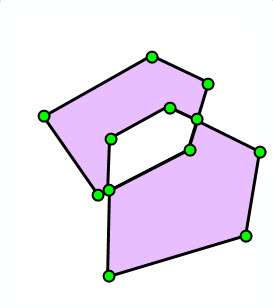

Let's look at some examples of non-simple vs. simple polygons. The green circles are the vertices of the polygon, and the lavender colored area represents the interior of the polygon.
Non-simple polygons
Non-simple polygon Non-simple polygon Non-simple polygon Non-simple polygon Non-simple polygon
Self-intersection Self-intersection Dangling segment Overlapping rings Dangling segment
Simple polygons
Simple polygon Simple polygon Simple polygon Simple polygon Simple polygon
No self-intersection Self-intersection at vertex No dangling segment No overlapping rings No dangling segment

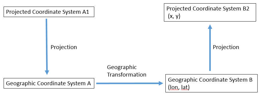

Geographic transformation
The most common form of datum transformation is the geographic transformation. The geographic transformation is a mathematical operation converting coordinates from one geographic coordinate system into a different system based on a different data/spheroid.
When the spheroids are different, your data is unprojected from the projected coordinate system (PCS) A1 into the geographic coordinate system A. Then it is converted to the latitude and the longitude values from GCS (Geographic Coordinate System) A to GCS B. This requires a geographic, or datum, transformation. The last step is to project GCS B into PCS B2. All of this is done under the covers when you use the Project operation.
In the following code sample, you're using a Mercator projection based on the European reference system as the input. The output coordinate system is the Web Mercator projection based on the world geodetic system (WGS) from 1984. The datum transformation transformation is then used to reproject the European location into a system that uses a WGS 84 reference system.
// Use this UTM spatial reference using the ETRS 1989 (European Terrestrial Reference System) datum.
// This will be the input spatial reference.
SpatialReference etrs_utmZone32N = SpatialReferenceBuilder.CreateSpatialReference(5652);

Suppose there is a polyline in the Pacific Ocean using the horizontal coordinate system WGS 84 and the vertical coordinate system EGM 84. You want to project the polyline to the NAD 83 horizontal coordinate system and NAD 83 PA 11 vertical coordinate system.
Example 1 Polyline to project
The transformations to use are specified in the instructions. Use the inverse of WGS_1984_To_EGM_1984_Geoid_1 and the forward transformation WGS_1984_(ITRF08)_To_NAD_1983_PA11.
Here is a code sample to perform the projection.

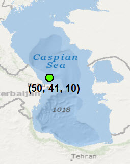

Example 3
Project only the z-coordinate of a point and the vertical transformation is unknown.
In this case, let the system choose the best vertical transformation based on the input and output spatial references.
Consider the point (50, 41, 10), that is, x = 50, y = 41, z = 10. The point is in the horizontal coordinate system WGS 84 and vertical coordinate system Baltic (depth). The point is located in the Caspian Sea.
Example 2 Point to project
Project only the height of the point, so the output horizontal coordinate system will be the same as the input, WGS 84, and the output vertical coordinate system will be Caspian (height).
// Create the input spatial reference with horizontal GCS_WGS_1984, vertical Baltic_depth
SpatialReference inSR = SpatialReferenceBuilder.CreateSpatialReference(4326, 5612);
// Create the point to project
MapPoint point = MapPointBuilderEx.CreateMapPoint(50, 41, 10, inSR);
// Create the output spatial reference with horizontal GCS_WGS_1984, vertical Caspian_height
SpatialReference outSR = SpatialReferenceBuilder.CreateSpatialReference(4326, 5611);
// Create the projection transformation from the spatial references.
ProjectionTransformation projectionTransformation = ProjectionTransformation.CreateWithVertical(inSR, outSR);
// Now project the point. Call ProjectEx to transform the z-coordinate.
MapPoint projectedPoint = GeometryEngine.Instance.ProjectEx(point, projectionTransformation) as MapPoint;
// Print the coordinates of the points
Console.WriteLine("Input point: (" + point.X + ", " + point.Y + ", " + point.Z + ")");
Console.WriteLine("Output point: (" + projectedPoint.X + ", " + projectedPoint.Y + ", " + projectedPoint.Z + ")");
Output from the code sample is the following:
Input point: (50, 41, 10)
Output point: (50, 41, 18)
