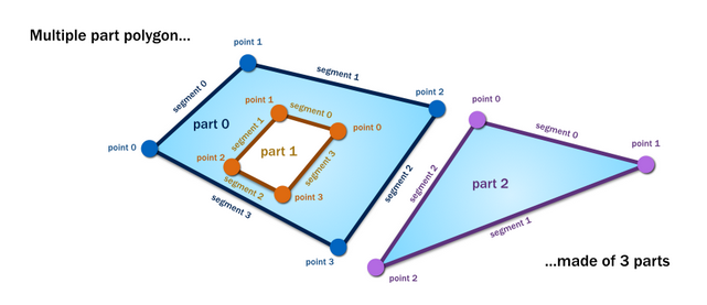

    Use the PolygonBuilderEx class to to create and/or modify a Polygon shape. The builder is best suited for editing workflows where the user may be adding, inserting or removing parts of a Polygon geometry interactively. A Polygon are based upon the parent Geometry class. The Geometry class is immutable which means that you can not change its shape once it is created. Hence, the PolygonBuilderEx provides the way to make changes when working with a Polygon. Use the PolygonBuilderEx.ToGeometry method to get the Polygon geometry from the builder.
    A polygon is defined by a collection of rings. Each ring is a collection of contiguous segments such that the start point and the end point of each Segment are the same (that is, it is a closed ring). If a polygon has more than one ring, the rings may be separate from one another or they may nest inside one another, but they should not overlap. Access the rings of a polygon using the Multipart.Parts method.
    Note: For a polygon to be topologically correct, exterior rings should be clockwise and interior rings should be counterclockwise. If there is ever a doubt about the topological correctness of a polygon, call the GeometryEngine.SimplifyAsFeature method to correct any issues.
