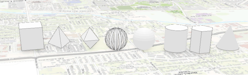

A multipatch is a series of 3-dimensional surfaces used to represent a 3D object. It can be used to represent simple objects such as spheres and cubes or complex objects such as buildings and trees. It allows for the storing of texture image, color, transparency and lighting normal vector information within the geometry itself, making it the ideal data type for the representation of realistic-looking 3D features. Multipatches are useful in exchanging data with other non-GIS 3D software packages such as Collaborative Design Activity (COLLADA) and SketchUp®.
Patches
Each part in a multipatch is called a patch and has a list of vertices with 3D coordinates to represent it's shape. A patch can be of type Triangles, Triangle Strip, Triangle Fan, First Ring or Ring. The type of the patch determines how to interpret the list of vertices. The following image displays examples of the different patch types.

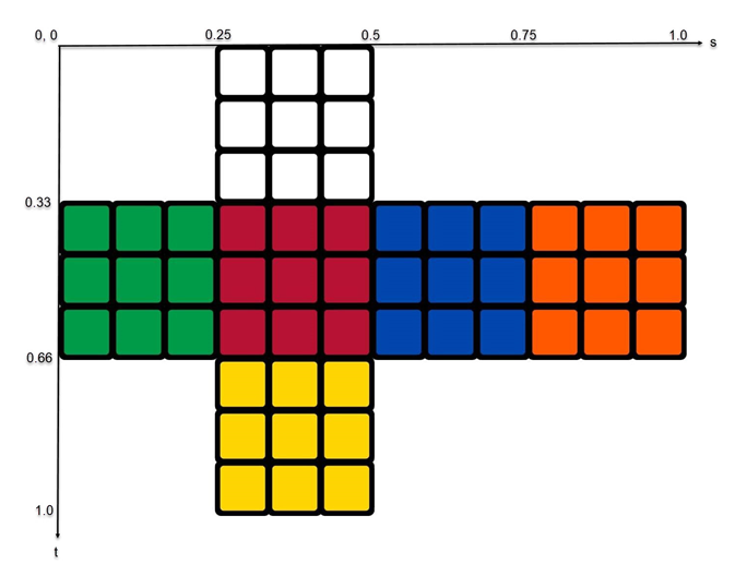

  • Texture Coordinates 2D. The list of 2D coordinates for mapping a 2D texture to the patch.

In addition to specifying the texture resource as part of the material on the patch, the TextureCoords2D property on the patch object is needed to specify the mapping of the image to the 2D face. There should be the same number of vertices in this list as there are in the Coords property. Normally textures will map to a (0,0), (1,1) pattern mapping the entire image to the face, however there may be instances where you want to map a subset of the texture to the face. For example, the following image displays a flat image of a Rubik's cube mapped to a grid. Rubiks Cube Coordinates
If only the part of the image containing the nine white squares is to be mapped to a patch, this can be achieved by specifying which [s,t] image coordinates map to each vertex of the patch. Here is a snippet illustrating this.
// assign texture coordinates to the top face patch
Patch topFacePatch = cubeMultipatchBuilderExWithTextures.Patches[0];
topFacePatch.TextureCoords2D = new List<Coordinate2D>
  new Coordinate2D(0.25, 0.33),
  new Coordinate2D(0.25, 0),
  new Coordinate2D(0.5, 0),
  new Coordinate2D(0.5, 0.33),

Predefined 3D Shapes
Special 3D shapes such as cubes, tetrahedrons, diamonds, sphere frames, spheres, cylinders, hexagons, and cones can be created using the MultipatchBuilderEx object.
Predefined Multipatches
Here is an example of creating a cube of size 10.
 MapPoint centerPt = MapPointBuilderEx.CreateMapPoint(1, 1, 1);
 // cube
 Multipatch cube = MultipatchBuilderEx.CreateMultipatch(MultipatchConstructType.Cube, centerPt, 10);
Or a sphere of size 10 with quality 0.8. The quality is a value between 0 and 1 inclusive. A higher quality number means more vertices for the shape resulting in a smoother shape.
 // sphere
 Multipatch sphere = MultipatchBuilderEx.CreateMultipatch(MultipatchConstructType.Sphere, centerPt, 10, 0.8);
In addition to using a static convenience method, you can also use the builder object and add materials or textures to the patches before creating the multipatch. Here is a snippet illustrating how to create a cone with each patch pointing to a material.
SpatialReference sr = SpatialReferenceBuilder.CreateSpatialReference(54004);
MapPoint centerZ = MapPointBuilderEx.CreateMapPoint(300, 400, 500, sr);
// use the builder constructor
MultipatchBuilderEx builder = new MultipatchBuilderEx(MultipatchConstructType.Cone, centerZ, 200, 0.8, sr);
// create the material
BasicMaterial faceMaterial = new BasicMaterial();
faceMaterial.Color = System.Windows.Media.Color.FromRgb(255, 0, 0);
faceMaterial.Shininess = 150;
faceMaterial.TransparencyPercent = 50;
faceMaterial.EdgeWidth = 20;
// assign the material to each of the patches
var patches = builder.Patches;
foreach (var patch in patches)
  patch.Material = faceMaterial;
// create the multipatch
Multipatch multipatch = builder.ToGeometry();
