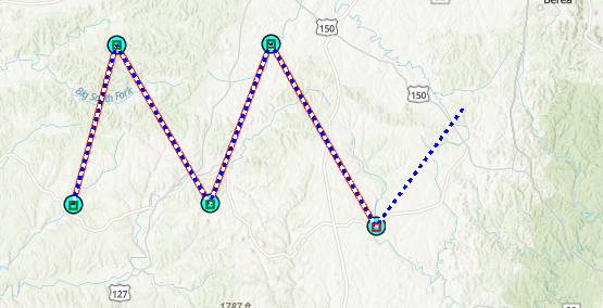

Sketch Tools
Sketch tools are used to create a sketch in the display. The features intersecting with this sketch can then be used as a basis for an editing operation.
Use the ArcGIS Pro MapTool template in Visual Studio to create a sketch tool. A MapTool can sketch feedback on the map when its IsSketchTool property is set to true. Use the SketchType property to specify what type of feedback you require. Common values are SketchGeometryType.Point, SketchGeometryType.Rectangle, SketchGeometryType.Line or SketchGeometryType.Polygon. Other options include SketchGeometryType.Circle, SketchGeometryType.Ellipse, or SketchGeometryType.Lasso amongst others.

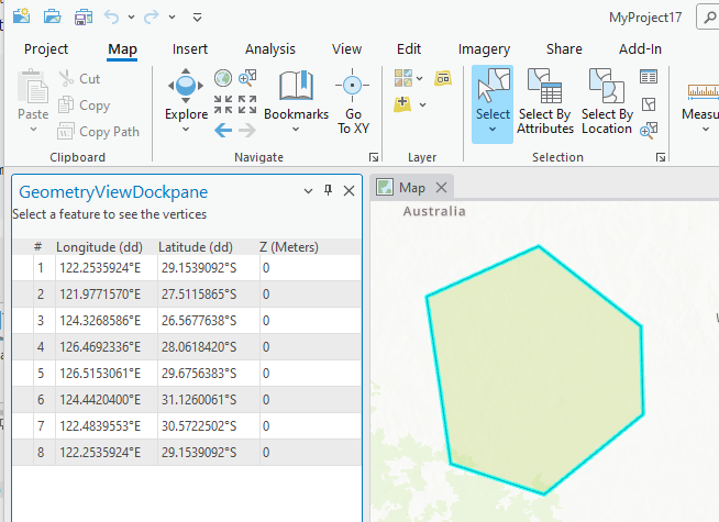

At 2.7+, a regular N-sided polygon or polyline feedback can be achieved using the SketchGeometryType.RegularPolygon or SketchGeometryType.RegularPolyline, along with setting the SketchNumerofSides property. The higher the number of sides, the more the sketch feedback begins to represent a circle. If no number of sides is specified, the sketch defaults to 6 (hexagon). The maximum number of sides is 100, the minimum that can be specified is 3.
For example; use the following code to sketch octagon feedback.
public CustomEditTool() {
  IsSketchTool = true;
  SketchType = SketchGeometryType.RegularPolygon;
  SketchNumberOfSides = 8;

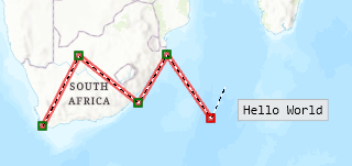

To add a custom sketch tip, use the SketchTip property. Or if a more complex tip is required, use an embeddable control and reference it's daml ID using the SketchTipID property. The embeddable control can be referenced using the SketchTipEmbeddableControl property. These properties are available at 3.0 onwards.
  SketchType = SketchGeometryType.Line;
  SketchTip = "hello world";
SketchTip
If you are using an embeddable control for a sketch tip, then from 3.4 onwards you can customize some additional properties. By default a sketch tip is located to the lower-right of the cursor and has a grey background. Change the position of the sketch tip by specifying a value for the SketchTipControlPosition property. The background of the sketch tip can also be set to transparent by setting the IsSketchTipControlTransparent to true. Note that these two properties can only be used if a SketchTipID is set.
public SketchToolHalo()
  SketchOutputMode = SketchOutputMode.Map;
  SketchTipID = "SketchToolWithHalos_HaloEmbeddableControl";
  SketchTipControlPosition = SketchTipControlPosition.Center;
  IsSketchTipControlTransparent = true;
See the ProGuide Sketch Tip With Halos and the associated Sketch Tool Halo Sample for an example of using the SketchTipID, SketchTipControlPosition and IsSketchTipControlTransparent properties.

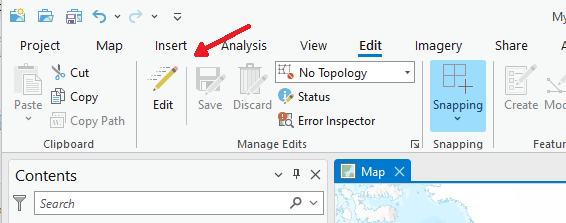

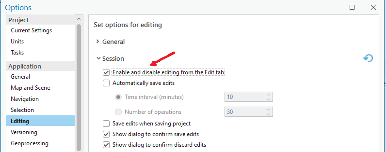

Enable and Disable Editing
Editing in the application, starting at 2.6, can be enabled and disabled via the UI. For users this means first checking on the "Enable and disable editing from the Edit tab" in the Session section of the Editing options on the Pro backstage.
EnableAndDisableEditing
If this checkbox is checked, the "Toggle editing on/off" button becomes visible on the Edit UI ribbon and users must enable editing within a project before doing any edits (they can also disable editing or "toggle it off" once they have enabled it or "toggled it on"). If the "Enable and disable editing" checkbox has been checked, then editing must always be enabled for any project after it is opened; the editing state of a project is not preserved on close.
ToggleEditing
The "Enable and disable editing from the Edit tab" checkbox in the UI corresponds to the ApplicationOptions.EditingOptions.EnableEditingFromEditTab setting within the application options. Toggling the value of EnableEditingFromEditTab true and/or false via code is equivalent to toggling the checkbox on|off via the UI. The complete list of available editing options in the api are listed in the Editing options section.
Custom editing tools and buttons that want to be enabled and disabled in concert with the Pro editing tools, in response to the editing status of the application, can use either the pre-existing esri_editing_EditingPossibleCondition condition or, for (map) tools, they can use the slightly more robust esri_editing_EditingMapCondition condition which additionally checks that a 2D map has been activated. If a user disables editing via the UI, Edit Operations in core tools and add-ins will not execute and return false (see "EditOperation" sub-section below).
Enable and Disable Editing via the API
By default, unless the user has explicitly checked the "Enable and disable editing" checkbox (or an add-in has disabled editing), editing in a project will always be enabled. Add-ins can check the editing enabled status within a given project via the Project.Current.IsEditingEnabled property. To enable or disable editing via the API, add-ins can call Project.Current.SetIsEditingEnabledAsync with true or false respectively.

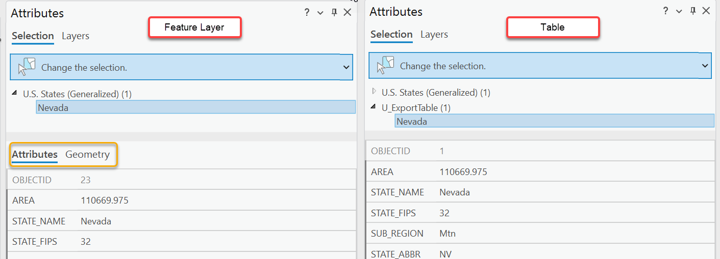

Feature Inspector and Working with Attributes
For updating attribute values of features, a convenient utility class called Inspector class is provided. The basic pattern for using the inspector is:
  1. Instantiate an inspector instance (var inspector = new Inspector();)
  2. Load (the attributes) of one or more features into the inspector (inspector.Load(...) or inspector.LoadAsync(...)). This will load joined data.
  3. Use indexer-style access (via the "[" and "]" brackets) by field index or name to set attribute values.
  4. Call Inspector.ApplyAsync() or use EditOperation.Modify(inspector) and EditOperation.Execute to apply the attribute updates to the set of features.
The Inspector.ApplyAsync() method applies and saves the changes in one shot. Both the Inspector.ApplyAsync and EditOperation.Execute will add an item to the undo stack if the operation is successful.
Note: All features loaded into the inspector must be from the same feature layer. Only feature values that are modified in the inspector are applied to the loaded feature(s). If tables are joined to the feature layer then the joined attributes are loaded also.

Single Workspace Editing
If the application has "Enable and disable editing from the Edit tab" enabled in the backstage Editing options (see Enable and Disable Editing), then users have the additional option of defining the type of edit session that will be used by the application; either multiple workspace editing or single workspace editing. Single workspace edit sessions are as they sound. When users enable editing (by clicking the "Toggle editing on/off" button to on), they must specify the single workspace that will be edited. The application commences an edit session on that workspace and only data within that workspace will be available to edit. All other data within your project that belongs to different workspaces will be read-only. If a user wishes to edit data from a different workspace, then any edits within the existing single workspace edit session must be saved or discarded, the edit session stopped (by clicking the "Toggle editing on/off" button to off) and a new edit session started on the different workspace.
Developers can use the SetSingleEditWorkspaceAsync extension method to specify a single workspace to edit. The EditingOptions.EnableEditingFromEditTab and EditingOptions.IsSingleWorkspaceEditSession must both be true for this API method to succeed. If either of these application options are false, then the SetSingleEditWorkspaceAsync method will throw an InvalidOperationException.
There are a number of different ways to call the SetSingleEditWorkspaceAsync method. The simplest is to start a single workspace edit session using a specific MapMember within a Map. Here is an example

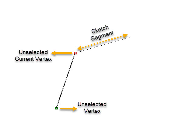

Sketch Feedback and Sketch Symbology
The MapTool sketch feedback consists of vertices and segments. A vertex can be fixed or it can be the active or current vertex. The default symbology for a fixed vertex is a hollow green square; whereas the default symbology for the current vertex is a hollow red square. Similarly, segments are either fixed or the active / current segment. There is no difference in the symbology between fixed or current segments; all sketch segments have the default symbology of a black dash-dot line; commonly referred to as the ant-trail. All vertices and segments whether they are fixed or current comprise the sketch feedback. The following displays the default sketch feedback showing the vertex and segment symbols.
Sketch feedback
Within a custom MapTool, you can customize the sketch symbol using the SketchSymbol property. Typically you would set this in the OnToolActivateAsync method. Alternatively you could use the OnSketchModifiedAsync method if you wanted to make the modifications more dynamic (for example changing the sketch symbol's color based on the number of vertices in the sketch).
Here's a code snippet for setting the SketchSymbol property in OnToolActivateAsync
    private CIMLineSymbol _lineSymbol = null;
    protected override async Task OnToolActivateAsync(bool hasMapViewChanged)
      if (_lineSymbol == null)
        _lineSymbol = await Module1.CreateLineSymbolAsync();
      this.SketchSymbol = _lineSymbol.MakeSymbolReference();

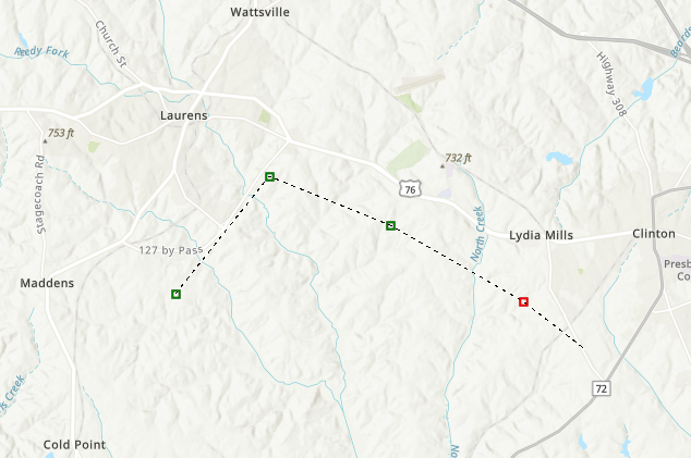

And the result. Note that you can still see the green and red vertex squares along with the dash-dot ant-trail line of the sketch feedback overlaying the sketch symbol.

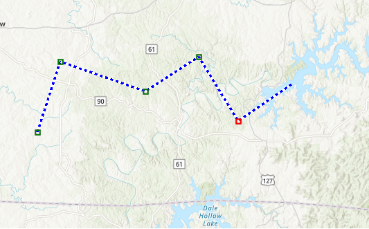

Modified Sketch feedback
Starting with Pro 2.9, you can also change the symbology of the vertices and segments of the sketch feedback in your custom MapTool. There are 4 different types of vertices - unselected vertex, selected vertex, unselected current vertex, and selected current vertex. For the purposes of sketching all vertices are unselected. Selected vertices are only visible within the Edit Vertices tool. As previously mentioned, the default vertex symbology whilst sketching is the green hollow square (unselected vertex) and the red hollow square (unselected current vertex). The default symbology for vertices within the Edit Vertices tool is a green filled square (selected vertex) and a red filled square (selected current vertex). The images below illustrate this; the first shows the unselected vertex symbology whilst sketching; the lower images show the selected vertex symbology within Edit Vertices.
Sketch segment, unselected sketch vertex, & unselected current sketch vertex
Selected sketch vertex Selected current sketch vertex
You can modify the vertex and segment symbology of the sketch feedback using the following new methods on the MapTool class:
Symbology set via these methods override the default symbology defined in the application settings. Here's a code snippet showing how to customize the segment symbol of the sketch feedback. In this example, the ant-trail becomes a blue dash-dot line of width 2.5. Note it is not possible to change the segment symbol type. It continues to be constrained to be a dash-dot line.
  protected override Task OnToolActivateAsync(bool active)
    return QueuedTask.Run(() =>
      var options = GetSketchSegmentSymbolOptions();
      var blue = new CIMRGBColor();
      blue.R = 0;
      blue.G = 0;
      blue.B = 255;
      options.PrimaryColor = blue;
      options.Width = 2.5;
      SetSketchSegmentSymbolOptions(options);
Modified Segment Sketch feedback
A sample tool modifying sketch feedback can be found at CustomToolSketchSymbology.

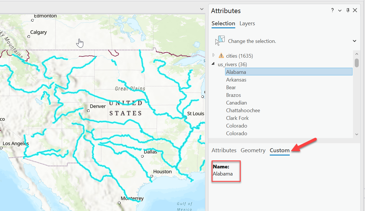

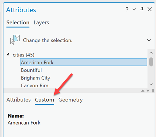

Customizing the Attributes Dockpane
Adding Tabs
The Attributes dockpane in ArcGIS Pro displays information for the selected features in a feature layer or selected rows in a standalone table. This information is displayed in a series of tabs in the lower half of the dockpane. Examples of these tabs are the Attributes and Geometry tabs.
At 3.1, the Attributes dockpane can be extended to display a custom tab. In the screenshot below, a tab called "Custom" has been added to the Attributes dockpane. In this example, the tab displays the name of the selected feature.
CustomTab

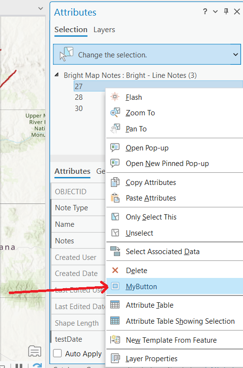

Here's a screenshot of a custom button added to the esri_editing_Attributes_FeatureContextMenu.
AttributesContextMenu
When writing a command that is to be inserted into a context menu, the typical pattern is to use the FrameworkApplication.ContextMenuDataContext method to obtain a representation of the item that was clicked on; that is the context. Sometimes it is possible to cast this context directly to an API object. For example, when inserting a command into the esri_mapping_mapContextMenu menu (displayed when a map is right-clicked in the Table of Contents), the context is the Map object.

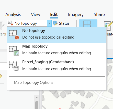

These classes represent the topological editing options shown in the Topology dropdown on the Edit tab as shown below. Note that topological editing only applies to 2D non-stereo maps.
TopologyProperties
Extension methods on the Map class can be used to interact with these topology property classes. Use GetAvailableTopologiesAsync to retrieve the set of topologies present in the current map or GetTopologyAsync to retrieve a specific topology by name.
The active topology properties can be retrieved using GetActiveTopologyAsync. Set the map topology as active using the combination of CanSetMapTopology and SetMapTopologyAsync or set a specific geodatabase topology as active by CanSetActiveTopology and SetActiveTopologyAsync. Set the active topology to "No topology" using the CanClearTopology and ClearTopologyAsync methods.
Here are some snippets illustrating the methods referenced above.
    var map = MapView.Active.Map;
    // get the active/current topology set for the map
    var activeTopology = await map.GetActiveTopologyAsync();
    var isMapTopology = activeTopologyProperties is MapTopologyProperties;
    var isGdbTopology = activeTopologyProperties is GeodatabaseTopologyProperties;
    var isNoTopology = activeTopologyProperties is NoTopologyProperties;
    //Get a list of all the available topologies for the map
    var availableTopologies = await map.GetAvailableTopologiesAsync();
    var gdbTopologies = availableTopologies.OfType<GeodatabaseTopologyProperties>();
    var mapTopologies = availableTopologies.OfType<MapTopologyProperties>();
    // get the GeodatabaseTopologyProperties specified by name
    var topoProperties = await map.GetTopologyAsync("TopologyName") as GeodatabaseTopologyProperties;
    var workspace = topoProperties.WorkspaceName;
    var topoLayer = topoProperties.TopologyLayer;
    var clusterTolerance = topoProperties.ClusterTolerance;
    // set the "TopologyName" to be the active topology
    if (map.CanSetActiveTopology("TopologyName"))
        //Set the active topology for the map using the topology name
        await map.SetActiveTopologyAsync("TopologyName");
    // set the MapTopology active
    if (map.CanSetMapTopology())
        await map.SetMapTopologyAsync();
    // set the "NoTopology" option as active
    if (map.CanClearTopology())
        await map.ClearTopologyAsync();

The Geometry control provides a UI for viewing vertices. The GeometryMode dependency property provides two options to configure the control - set it to GeometryMode.Geometry to view the vertices of a geometry or GeometryMode.Sketch to view the vertices of a sketch.
In GeometryMode.Geometry mode, the control acts the same as the Geometry tab on the Attributes pane. Bind the geometry to be loaded into the grid to the Geometry property of the control. This geometry can be one that is created on-the-fly or a geometry of an existing feature. If the geometry is Z-aware or M-aware the control will display the Z and/or M values.
 <UserControl x:Class="Example.GeometryViewDockpane"
    ... xmlns:editControls="clr-namespace:ArcGIS.Desktop.Editing.Controls;assembly=ArcGIS.Desktop.Editing"
 <Grid>
   <editControls:GeometryControl GeometryMode="Geometry" Geometry="{Binding Geometry}"/>
 </Grid>
The Geometry property in the associated (dockpane) view model is defined as:
    private Geometry _geometry;
    public Geometry Geometry
      get => _geometry;
      set => SetProperty(ref _geometry, value);
geometryControlGeometry

Editing Options
Editing options corresponding to the editing options on the Pro options UI are available in the API via the static ApplicationOptions.EditingOptions property - refer to ProConcepts Content - ApplicationOptions for more information. The available options include:
//Gets and sets the application editing options.
public class EditingOptions
    /// Gets and sets whether attribute validation is enforced.
    public bool EnforceAttributeValidation { get; set; }
    /// Gets and sets whether attribute edits are automatically applied.
    public bool AutoApplyAttributeEdits{ get; set; }
    /// Gets and sets whether the layer should be highlighted in the attributes window selection view when the selection changes.
    public bool HighlightLayerOnSelectionChange { get; set; }
    /// Gets and sets whether a warning is displayed when subtypes are changed.
    public bool WarnOnSubtypeChange { get; set; }
    /// Gets and sets whether default values are initialized on a subtype change.
    public bool InitializeDefaultValuesOnSubtypeChange { get; set; }
    /// Gets and sets the uncommitted attribute edits setting.
    public UncommitedEditMode UncommitedAttributeEdits { get; set; }
    /// Gets and sets whether the merge tool merges z-aware polygons
    /// when they overlap.
    public bool AllowMergeToCreateNonPlanarPolygons { get; set; }
    /// Gets and sets whether geometry is stretched proportionately when moving a vertex.
    public bool StretchGeometry { get; set; }
    /// Gets and sets whether topology is stretched proportionately when moving a topology element.
    public bool StretchTopology { get; set; }
    /// Gets and sets the uncommitted geometry edits setting.

    /// Gets and sets whether editing can be enabled and disabled from the Edit tab.
    public bool EnableEditingFromEditTab { get; set; }

Sketch Symbology Options
EditingOptions contains a number of option settings related to the sketch symbology. These require use of the Pro Main CIM Thread, MCT, and so are accessed and set via Get and Set methods (which must be wrapped in a QueuedTask.Run(...)) rather than Get and Set properties. Symbology settings are also a little different from other settings in that they are constrained by what can represent a valid symbology setting. Not all possible point and line combinations are valid for use on the sketch. Add-ins, therefore, can use the CanSetVertexSymbolOptions(vertexOptions) and CanSetSegmentSymbolOptions(segmentOptions) to determine if their symbology options are valid/can be used with sketch vertex and sketch segment symbology respectively. Additionally, to assist add-ins in returning to the default settings for vertex and segment sketch symbology, a GetDefaultVertexSymbolOptions(vertexType) and GetDefaultSegmentSymbolOptions() methods are provided. Examples follow:
Retrieve the existing sketch symbology settings:
var options = ApplicationOptions.EditingOptions;
//Must use QueuedTask
QueuedTask.Run(() => {
  //There are 4 vertex symbol settings - selected, unselected and the
  //current vertex selected and unselected.
  var reg_select = options.GetVertexSymbolOptions(VertexSymbolType.RegularSelected);
  var reg_unsel = options.GetVertexSymbolOptions(VertexSymbolType.RegularUnselected);
  var curr_sel = options.GetVertexSymbolOptions(VertexSymbolType.CurrentSelected);
  var curr_unsel = options.GetVertexSymbolOptions(VertexSymbolType.CurrentUnselected);
  //to convert the options to a symbol use
  //GetPointSymbol
  var reg_sel_pt_symbol = reg_select.GetPointSymbol();
  //Segment symbol options
  var seg_options = options.GetSegmentSymbolOptions();
Set sketch symbol options:
  //change the regular unselected vertex symbol:
  //default is a green, hollow, square, 5pts.
  //Change to Blue outline diamond, 10 pts
  var vertexSymbol = new VertexSymbolOptions(VertexSymbolType.RegularUnselected);
  vertexSymbol.OutlineColor = ColorFactory.Instance.BlueRGB;
  vertexSymbol.MarkerType = VertexMarkerType.Diamond;
  vertexSymbol.Size = 10;
  //check are these changes valid?
  if (options.CanSetVertexSymbolOptions(
     VertexSymbolType.RegularUnselected, vertexSymbol)) {
    //apply them - will throw an exception for invalid choices
    options.SetVertexSymbolOptions(VertexSymbolType.RegularUnselected, vertexSymbol);
  //change the segment symbol
  // primary color to green and width to 1 pt
  var segSymbol = options.GetSegmentSymbolOptions();
  segSymbol.PrimaryColor = ColorFactory.Instance.GreenRGB;
  segSymbol.Width = 1;
  if (options.CanSetSegmentSymbolOptions(segSymbol)) {
    options.SetSegmentSymbolOptions(segSymbol);
Set sketch options back to defaults:
  //set vertex reg unselected back to defaults...
  var def_reg_unsel =
    options.GetDefaultVertexSymbolOptions(VertexSymbolType.RegularUnselected);
    VertexSymbolType.RegularUnselected, def_reg_unsel);
  //set segment sketch back to default
  var def_seg = options.GetDefaultSegmentSymbolOptions();
  options.SetSegmentSymbolOptions(def_seg);

  //the reconcile process.
  public bool ShowReconcileDialog { get; set; }
  //Gets and sets the value indicating if a dialog is displayed to review
  //conflicts.
  public bool ShowConflictsDialog { get; set; }
  //Gets and sets the value indicating if new geodatabase connections default to
  //traditional versioned.
  public bool IsTraditional { get; set; }
For example, this snippet toggles/changes the current versioning option values:
  var vOptions = ApplicationOptions.VersioningOptions;
  vOptions.DefineConflicts = (vOptions.DefineConflicts == ConflictDetectionType.ByRow) ?
    ConflictDetectionType.ByColumn : ConflictDetectionType.ByRow;
  vOptions.ConflictResolution = (vOptions.ConflictResolution == ConflictResolutionType.FavorEditVersion) ?
     ConflictResolutionType.FavorTargetVersion : ConflictResolutionType.FavorEditVersion;
  vOptions.ShowConflictsDialog = !vOptions.ShowConflictsDialog;
  vOptions.ShowReconcileDialog = !vOptions.ShowReconcileDialog;
