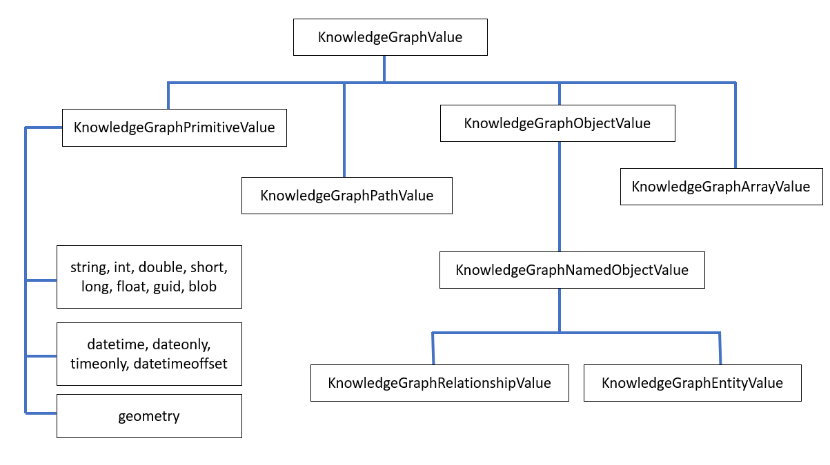

The complete KnowledgeGraphValue data model in the ArcGIS.Core.Data.Knowledge namespace is shown below:
- KnowledgeGraphValue is the abstract base class for all derived knowledge graph values. Examine
public KnowledgeGraphValueType KnowledgeGraphValueTypeto determine the value type and/or check using a cast (to the derived type). - KnowledgeGraphPrimitiveValue can wrap any (supported) primitive value - text, numeric, data/time, guid, geometry, blob. The primitive value itself can be retrieved via the
public object GetValue()method. Note: queries and searches return primitive values directly (as ints, longs, strings, doubles, etc.). They do not useKnowledgeGraphPrimitiveValue.KnowledgeGraphPrimitiveValueis for future use in the API. - KnowledgeGraphPathValue represents a series of connected entities and relationships usually described by an openCypher query of the form
p=(e1)-[]->(e2), p=(e1)-[]->(e2)<-[]->(e3)and so on. Entities and relationships connected by a path can be retrieved via thepublic KnowledgeGraphEntityValue GetEntity(ulong index)andpublic KnowledgeGraphRelationshipValue GetRelationship(ulong index)methods respectively. - KnowledgeGraphArrayValue can contain an array of 0 or more
KnowledgeGraphValuevalues and/or primitive values depending on the nature of the query. - KnowledgeGraphObjectValue is the base class for any object value in the knowledge graph. An object value stores values as properties (not unlike the fields of a row or feature). Each property consists of a key|value pair. The value can be any
KnowledgeGraphValueor primitive. The list of property keys can be retrieved via thepublic IReadOnlyList<string> GetKeys()method. Use the keys with the object value indexerpublic object this[string key]to retrieve the corresponding property value. Queries typically return named objects like entities and relationships (derived fromKnowledgeGraphObjectValue), however,KnowledgeGraphObjectValueinstances themselves can be returned in queries when the query defines an anonymous type "on-the-fly". For example, the query stringMATCH (b:Beer) RETURN { Xbeer: { Xname: b.name, Xid: b.id } }defines an anonymous type "XBeer" (based on the entity "Beer") which would be returned as a KnowledgeGraphObjectValue (and not as an entity). - KnowledgeGraphNamedObjectValue is the base class for named object values and derives from
KnowledgeGraphObjectValue. Named objects include entities and relationships. In addition to being able to store property values, named objects (can) also have an id (usually a guid) that uniquely identifies them, an object id, and a "type". The "type" describes the type or category for the particular named object value and corresponds to their associated underlying geodatabase table name and correspondingKnowledgeGraphNamedObjectTypecontained in theKnowledgeGraphDataModel(refer to the data model) section) - KnowledgeGraphEntityValue derives from
KnowledgeGraphNamedObjectValue. All entities, therefore, have values stored as properties, a unique id, can have an object id, and have a (string) type. Entities also have an arbitrary string label retrieved viapublic string GetLabel(). Entities that have a geometry can be accessed as features from a feature class whose name is the same as the*KnowledgeGraphNamedObjectValuetype string. Entities that do not have a geometry can be accessed as rows from a table (whose name is the same as the*KnowledgeGraphNamedObjectValuetype string). - KnowledgeGraphRelationshipValue derives from
KnowledgeGraphNamedObjectValue, same as entities, meaning that relationships in a graph model can also have properties, a unique id, an object id, and have a (string) type. Relationships too are accessible as features or rows from the knowledge graph datastore depending on whether they have a geometry or not. Relationships contain an origin and destination id identifying the origin and destination entities associated with the relationship. The ids can be retrieved via thepublic object GetOriginID()andpublic virtual object GetDestinationID()methods respectively.
An example of a general pattern for processing any supported value retrieved from the KnowledgeGraphRow array is shown below. Note the use of GetCount() and the KnowledgeGraphRow indexer to retrieve all values from the returned row array as well as the use of recursion to handle any "nested" values such as within KnowledgeGraphArrayValues and KnowledgeGraphPathValues (the custom "ProcessKnowledgeGraphRowValue" method is provided further below in this section):

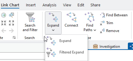

FFP Analysis Operations
Within the Pro Linkchart UI, on the Link Chart tab, are a number of pre-configured FFP analysis operations (within the "Scope" group), each designed to explore different relationships and patterns between entities on the link chart. Each of these pre-canned analysis operations can be configured using the CIMFilteredFindPathsConfiguration and are provided below.
- Expand and Filtered Expand: Discovers related entities (whether on the link chart or not) to whichever entities are currently selected. Filtered Expand gives you the option of selecting the specific type of relationships you want to use to discover entities Pro Help - Expand link chart content
- Connect: Discover relationships that directly connect (any) two entities together Pro Help - Add entities and relationships missing from the link chart - Connect associated entities
- Find Between: Discover entities that are directly connected to two or more selected entities in the link chart. At least two, and no more than ten, entities must be selected. Pro Help - Add entities and relationships missing from the link chart - Find entities between entities
First, at least one entity must be selected to expand from. Second, to mimic the built-in Expand (or Filtered Expand) operation limit the maximum length of all discovered paths to be 1. Direction is not important so that can stay as KGTraversalDirectionType.Any. Entities can be either origin or destination on discovered shortest paths so we leave the entity usage as FilteredFindPathsEntityUsage.AnyOriginAnyDestination. As we want to consider all entity types as possible destinations we configure the ffp_config.DestinationEntities using all the entity types pulled from the data model rather than from the link chart as the link chart content may currently only be including a subset of the available entity types.

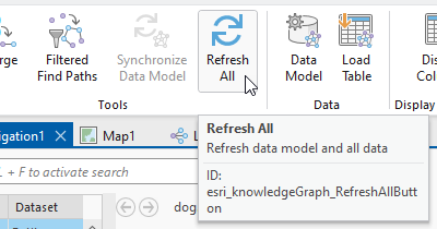

* Depending on the current application context, addins may want the knowledge graph UI to refresh to show schema updates. To refresh the UI, use the ApplySchemaEdits extension method to apply schema changes rather than the "standard" sb.Build(). If using sb.Build(), the knowledge graph UI, if active, may show messages similar to this:
The message alerts the user that the UI is aware that the underlying datamodel has changed but not what the change is/was and needs to be refreshed. To manually refresh the UI at any time, users will execute the Refresh All button on the investigation tab.
From within core host applications, sb.Build() will always be used as application context and UI refresh considerations are moot. For code snippets illustrating various common schema builder operations (create, modify, and delete), consult the ProSnippets KnowledgeGraph Schema Edits section.
