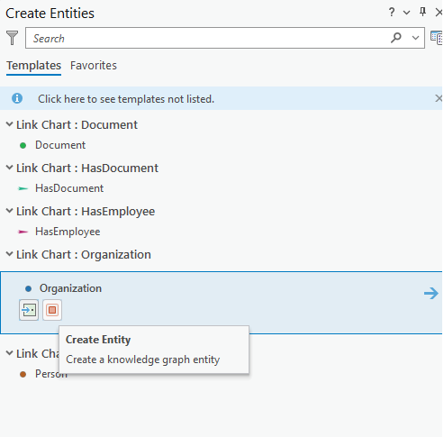

Note that in the tool constructor, the SketchType is set to Point. In the OnSketchCompleteAsync method, an EditOperation is created, the Create method is called using the CurrentTemplate and sketched geometry and then the edit operation is executed. We will use this code without any changes.
  • Build the sample and verify that there are no compile errors.
  • Run the the add-in in the (visual studio) debugger.
  • In Pro, create a new, or open an existing, project. Use the "New Investigation" button in the Knowledge Graph group on the Insert tab to create an investigation within your project. Select an existing Knowledge Graph service to define the investigation. Once the investigation has been added to the project, from the knowledge graph context menu in the table of contents dockpane, add the Knowledge Graph to a new link chart.
  • Save the project.
  • With the link chart open, ensure the Create Features window is open. Verify that your construction tool appears on the palette(s) for the entity layer(s). Activate the tool and create a new entity in any of the entity layers by sketching a point.

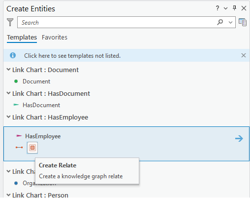

Next, lets create the relationship construction tool. As previously mentioned; relationships on a link chart are represented by "links" or lines. Whilst we could create a construction tool using a SketchType of Line, a link chart relationship construction tool uses a SketchType of Point. To create a link, the tool directs the user to identify the origin and destination entities with two separate clicks. We will use the SketchTip of the tool to provide information to the user and useful hints about the entities identified and/or hovered over. Once an origin entity is identified, a connection line or link from this (first) entity to the mouse location is displayed on the overlay. This connection line is updated whenever the mouse moves. When a destination entity is identified with a second click, the relationship link is created. This guide will illustrate the processes used in building a similar tool.
Add a new ArcGIS Pro Add-ins | ArcGIS Pro Construction Tool item to the add-in project, and name it CreateRelate. Modify the entry for the construction tool generated in the Config.daml file as follows:
  • Change the caption to "Create Relate".
  • Change the tool heading to "Create Relate" and the ToolTip text to "Create a knowledge graph relate"
  • Change the categoryRefID to esri_editing_construction_knowledge_graph_relationship indicating the tool will create knowledge graph relationships.
  • Your tool entry will have a content tag with a guid attribute. Don't change this attribute.

Build the sample and verify that there are no compile errors. Debug the add-in. Open your Knowledge Graph aprx. With the link chart and Create Features window open, activate a template on a link chart relationship layer and activate your custom construction tool.
Move the mouse around the map. Note the SketchTip and Cursor. It should update as you move over entity features and perform your selects.
Hover over an entity and observe the SketchTip and Cursor change.
Click on the entity to identify it as the origin entity. Notice the SketchTip change again and the connecting line draw on the overlay as you move the mouse.
Hover over a second entity. Notice the SketchTip, Cursor and overlay change.
Click on the second entity to identify it as the destination entity. This will automatically trigger the creation of the relationship record. Open the attributes window of the relationship layer to see the new record.
Once you have finished exploring the tools, (optionally) save your edits and close ArcGIS Pro.
