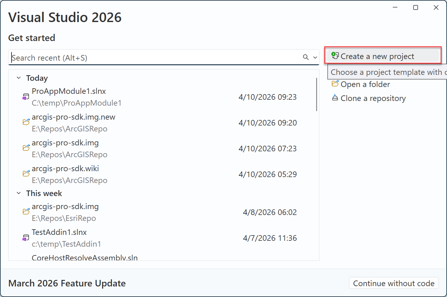

Step 1
Open Visual Studio and select New Project.
New Project

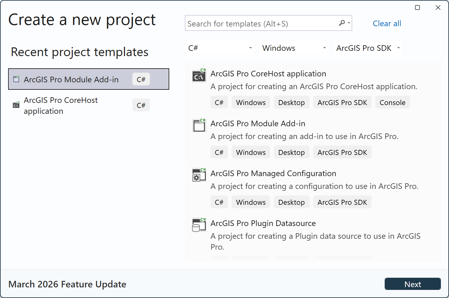

On the New Project dialog box, expand the Templates\Visual C#\ArcGIS or Templates\Visual Basic\ArcGIS folder. Select the ArcGIS Pro Add-ins folder (you may have other folders there if you also have the ArcObjects 10.x SDK for .NET installed).
Step 3
The ArcGIS Pro Module Add-in Visual Studio project item template displays. Select it and type ProAppModule1 for the name. Change the location or accept the default. Click OK.
NewModuleAddin

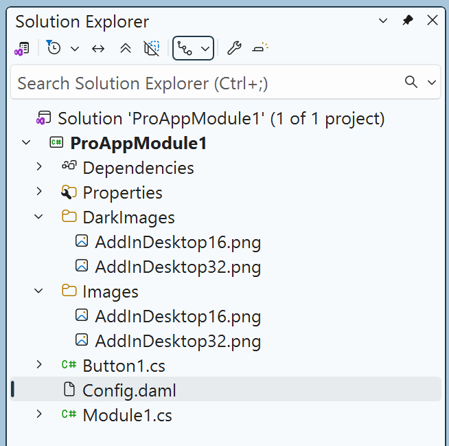

Visual Studio creates a new Visual C# or Visual Basic project for you. For the purposes of this document, Visual C# will be assumed; however, the procedure is almost identical for Visual Basic. You will notice the following content in your new project:
NewContent
The Config.daml file opens (by default) in Visual Studio. The Module1.cs file contains your add-in module code. The code will be similar to this:

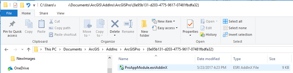

Open Windows Explorer. Navigate to the C:\Users\<Your user name>\Documents\ArcGIS\AddIns\ArcGISPro folder. You should see the add-in folder for your newly compiled add-in. The name of the folder corresponds to the ID (GUID) of your add-in.
<AddInInfo id="{8e95b131-d203-4775-9617-07481fbdfa32}" ...
Double-click the folder. You will see your add-in file within the folder.

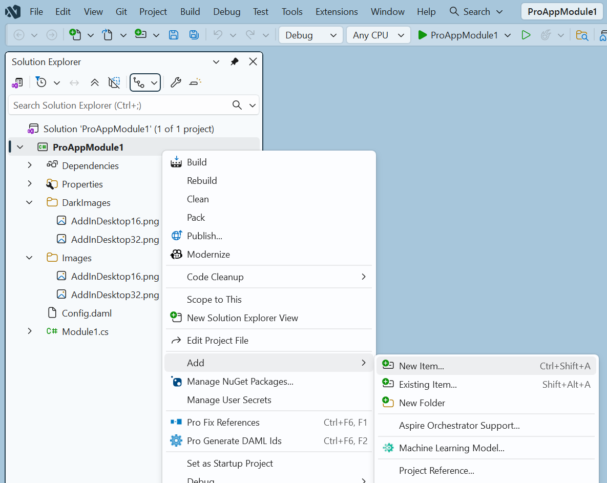

Step 7 Right-click the project title within Visual Studio and select Add > New Item from the Project Context menu.
AddNewItem

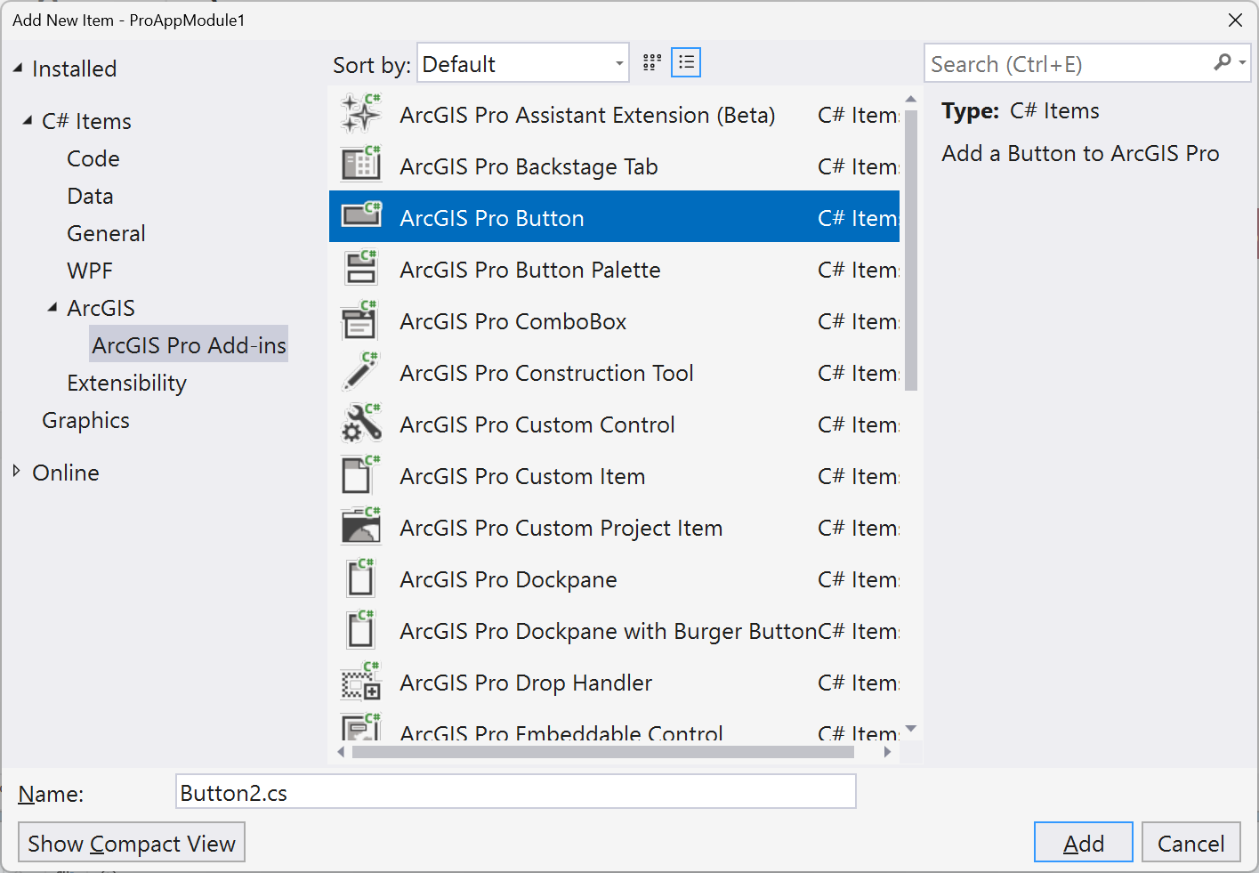

From the Visual Studio Add New Item dialog box, choose ArcGIS Pro Button from the list of available ArcGIS Pro SDK Item templates. Keep the default name Button1.cs and click OK.
NewButton

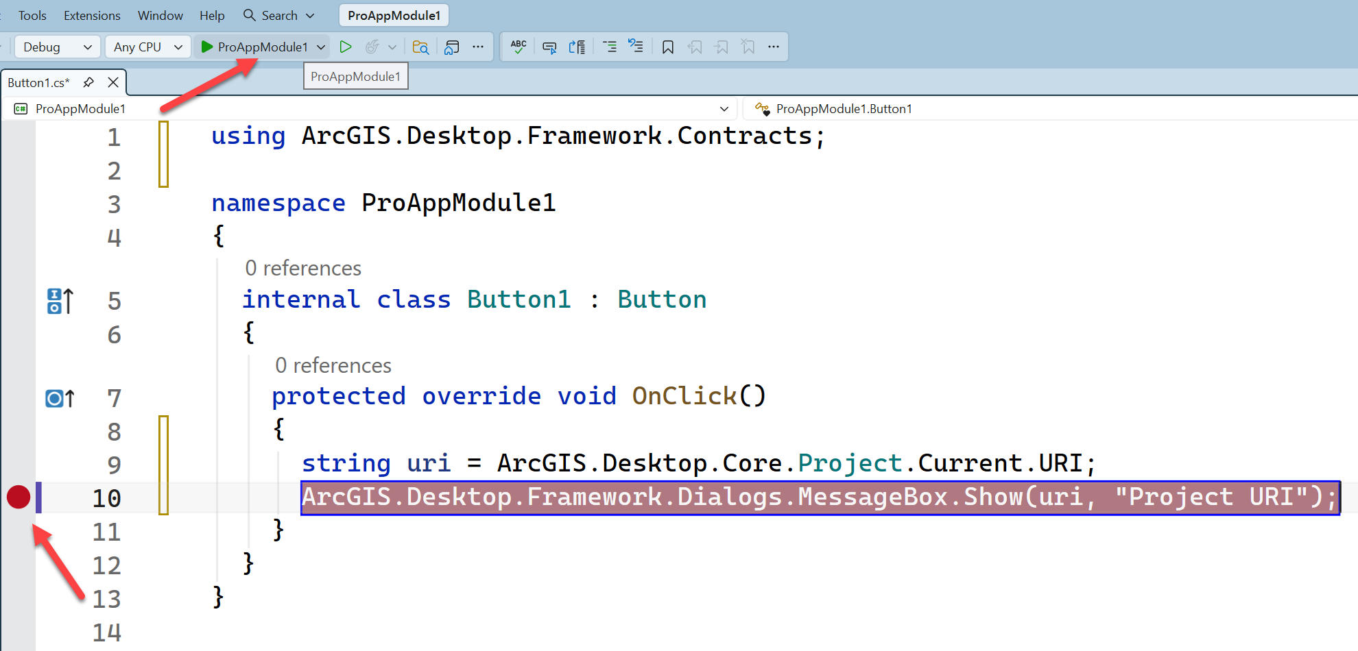

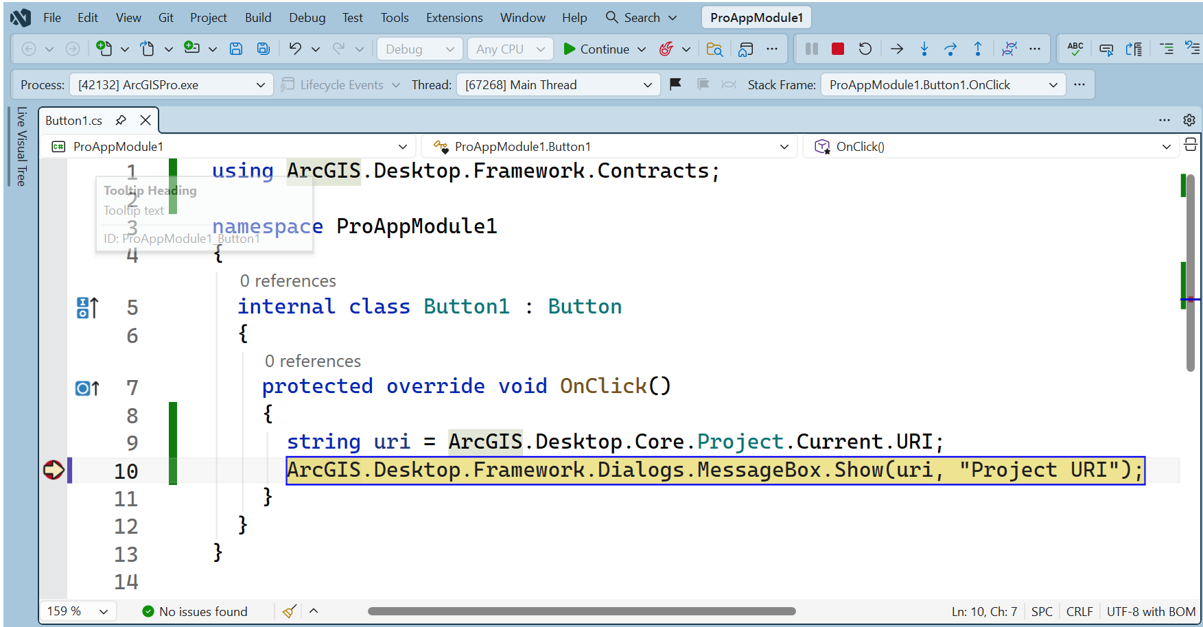

Within Visual Studio you should now see a new file, Button1.cs, that has been added to your project. Double-click that file and type the following code into the OnClick method:
 internal class Button1 : Button {
    protected override void OnClick()
      string uri = ArcGIS.Desktop.Core.Project.Current.URI;
           ArcGIS.Desktop.Framework.Dialogs.MessageBox.Show($"Project uri {uri}");

Place a breakpoint in the margin of your OnClick method and run your add-in in the Visual Studio debugger.
Breakpoint

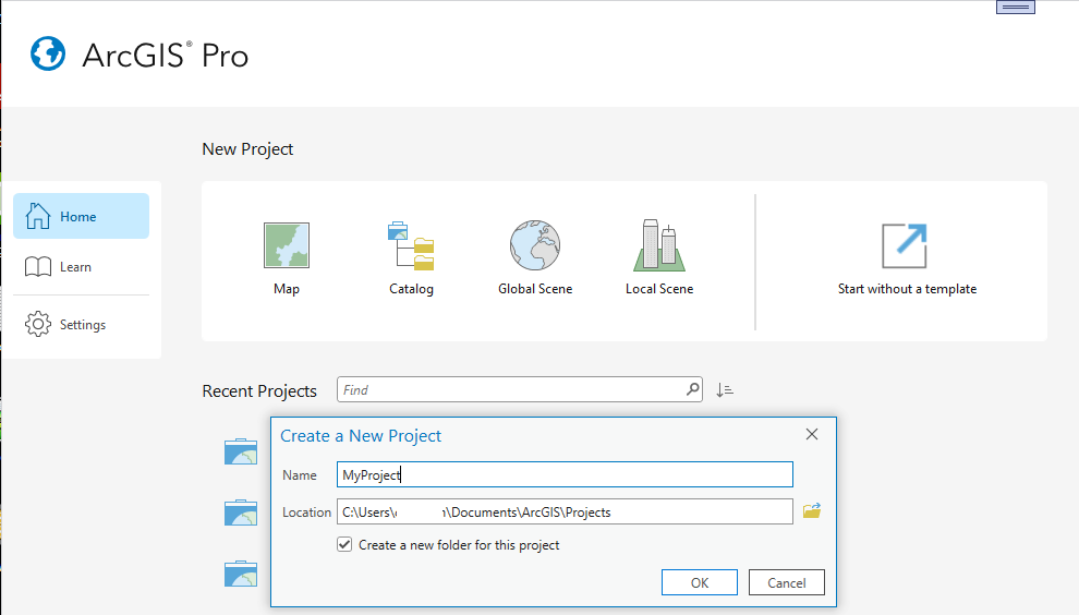

ArcGIS Pro starts. Allow ArcGIS Pro to complete its initialization. Create a new empty project using the template of your choice or open one of your existing projects. NewProProject

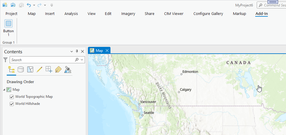

Click Add-In tab and click the Button 1 add-in button.
AddinTab
Step 13

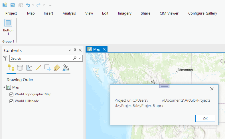

Your breakpoint will be hit in Visual Studio. Press F5 or click the Continue button to continue execution. The following message box displays.
Breakpoint2 NewProProject2
Click OK. Stop debugging.
