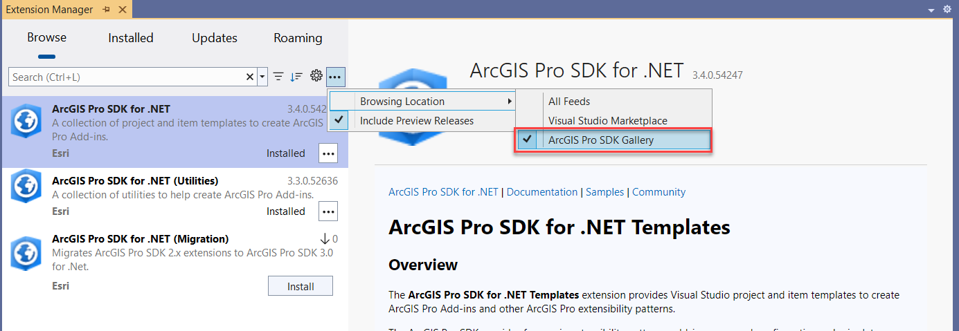

- On the Extensions menu, choose Manage Extensions. This will bring up the Manage Extensions dialog.

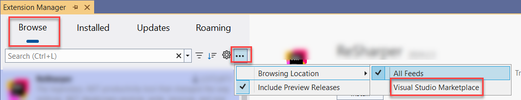

- Confirm that the "Browse Location" is set to Visual Studio Marketplace.

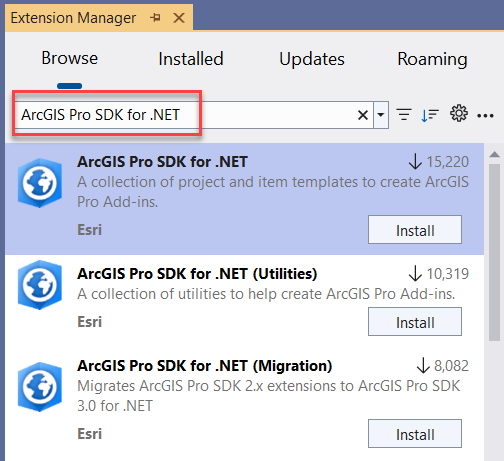

- Type ArcGIS Pro SDK in the search box. Among the search results found, the items you will need are ArcGIS Pro SDK for .NET, ArcGIS Pro SDK for .NET (Utilities) and ArcGIS Pro SDK for .NET (Migration) as shown in the following screen shot:

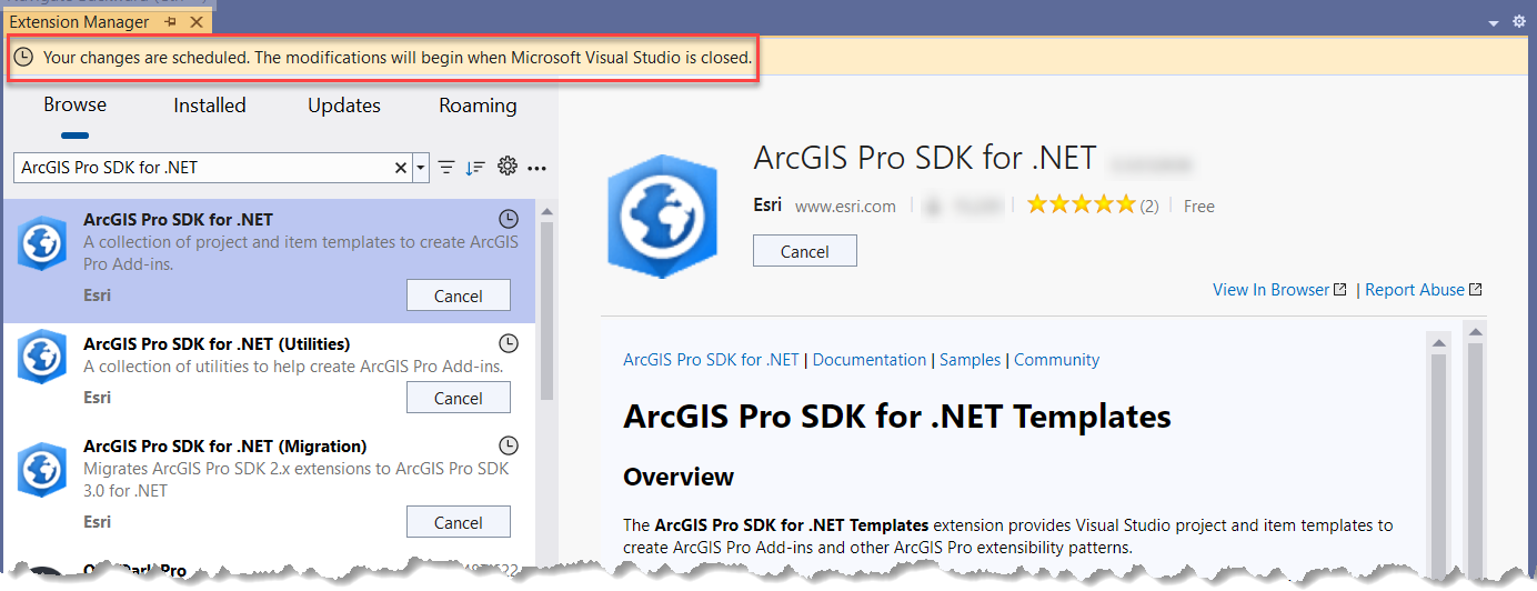

- Choose the ArcGIS Pro SDK for .NET package and click the Install button. Optionally, choose ArcGIS Pro SDK for .NET (Utilities) and ArcGIS Pro SDK for .NET (Migration) and click the Install button for each of these extensions. This will allow you to download and install all three extensions in one step.
- ArcGIS Pro SDK for .NET will be scheduled for install when Visual Studio windows are closed.

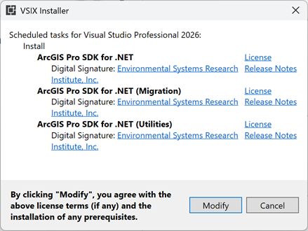

- The VSIX Installer dialog will appear. Click Modify to install ArcGIS Pro SDK for .NET. Proceed with the VSIX Install wizard to complete the installation.

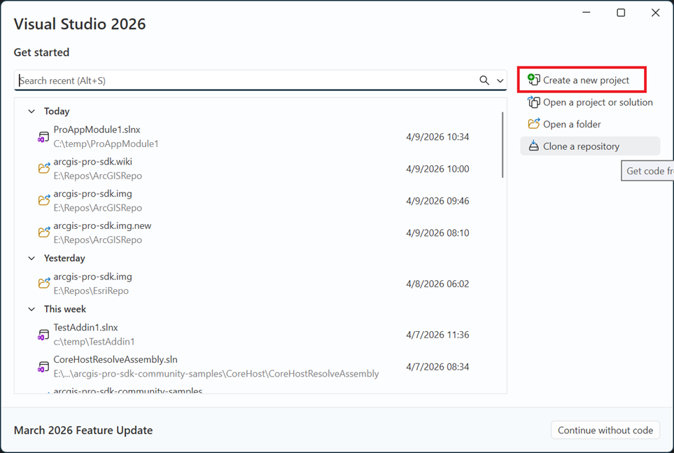

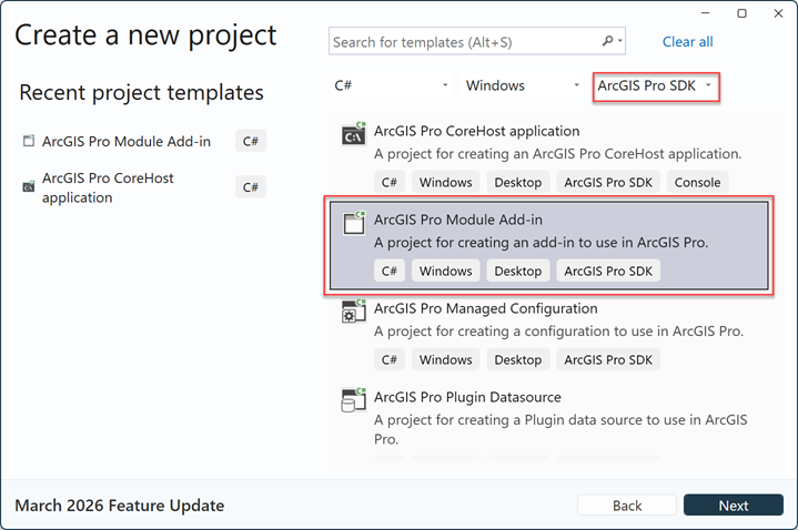

- Access the Create New Project option from the Visual Studio start window.
Filter all the available Project templates by using custom ArcGIS Pro SDK Project Type Filter. You should see ArcGIS Pro SDK templates.

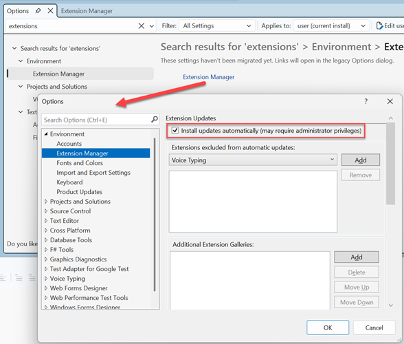

Warning: If you have the Automatically update extensions option checked in Visual Studio, you will already have the newer version of ArcGIS Pro SDK for .NET on your machine.
We recommend that you turn this feature off. With this auto-update extensions feature in Visual Studio, you could get into a state where you're using an older version of ArcGIS Pro with a newer version of ArcGIS Pro SDK (which was upgraded automatically in Visual Studio). If this happens, you will encounter errors when you attempt to create an ArcGIS Pro add-in using the SDK. Enable/disable auto-updates per extension in Extension -> Manage Extensions. Enable/disable auto-updates at a global level through Tools -> Options.

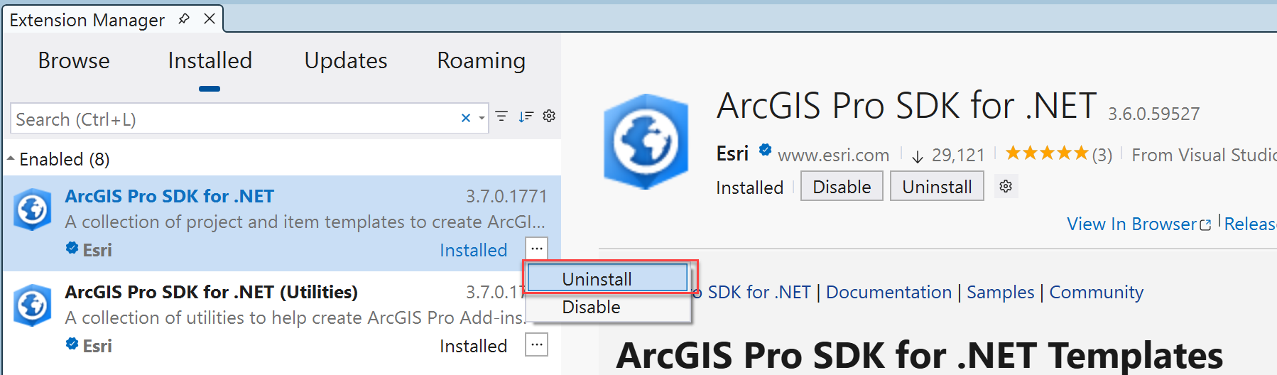

- Start Visual Studio. On the Extensions menu, choose Manage Extensions. This will bring up the Manage Extensions dialog.
- Click the Installed tab at the top.
- Find the ArcGIS Pro SDK for .NET, ArcGIS Pro SDK for .NET (Migration) and ArcGIS Pro SDK for .NET (Utilities) packages and click the ellipsis button and select Uninstall.
