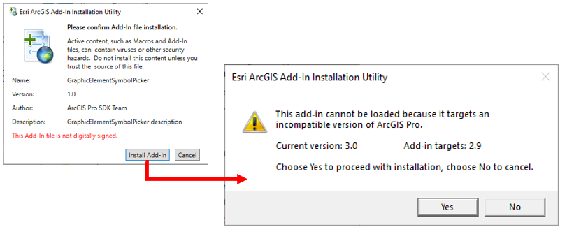

Registering add-ins
Attempting to register a 2.x add-in, configuration, or plugin datasource against Pro 3.x will fail though it will still be deployed. RegisterAddin.exe will pop-up a warning message alerting you that the add-in or configuration you are attempting to install won't be loaded because it is incompatible with the current version of Pro.
Proceeding with the installation deploys the archive file to the respective folder but when Pro starts it will not be loaded.

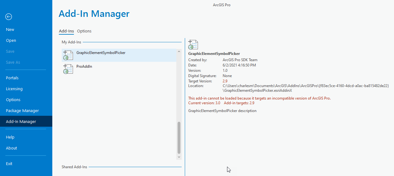

Add-in and Configuration Does Not Load
In many cases you may already have add-ins or configurations installed on your machine from a 2.x release when you upgrade Pro to 3.x. When you run Pro, previously installed add-ins, configurations, and plugin datasources from a 2.x release will not load in Pro 3.x. Any add-in that is incompatible with the current release will be shown as disabled on the Add-in Manager backstage tab of Pro. The add-ins must be migrated to Pro 3.0 or better before they can be loaded. The same is true for configurations, plugin datasources, and core host applications*.
*Core host applications must be migrated but they are not loaded by, nor registered with, Pro.

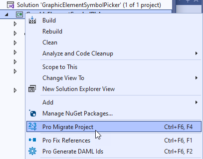

To install "Pro Migrate Project", run the "proapp-sdk-migration.vsix" that comes with the Pro SDK at 3.0 and 3.1. This will add the utility to the Visual Studio 2022 project context menu (alongside the other Pro SDK context menu options).
To run the migration utility, open the respective add-in, configuration, plugin datasource, or core host application project in Visual Studio 2022. Next, right-click and run the "Pro Migrate Project" option to convert the add-in project (whether add-in, configuration, plugin datasource, or core host application) to .NET 6. The conversion utility can be used to convert both C# and VB.Net 2.x add-in projects.
When the "Pro Migrate Project" conversion utility is run it prompts the user as to whether or not they want to proceed:
Assuming "Yes" is selected, the conversion utility performs the relevant conversion of the add-in project to .NET 6. The user should acknowledge the "migration completed successfully" prompt and click "Reload" on the Visual Studio prompt to reload the project. Post conversion:

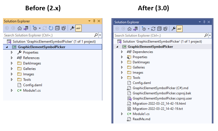

Before and After conversion view of the Visual Studio TOC of a 2.x Add-In:

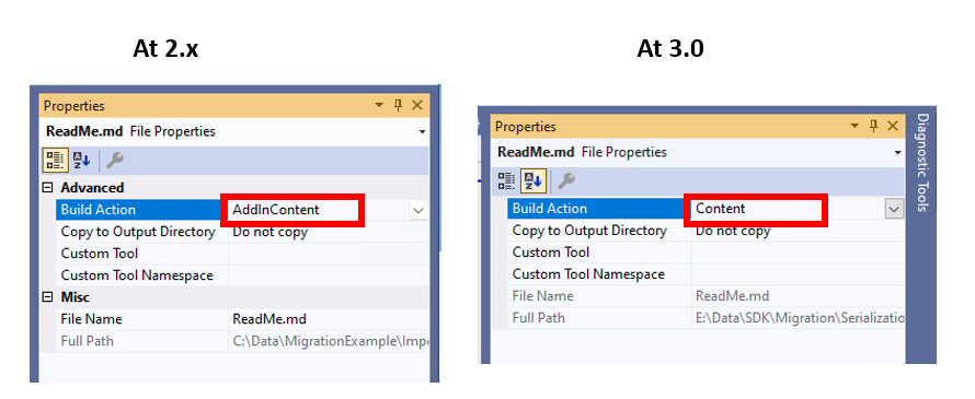

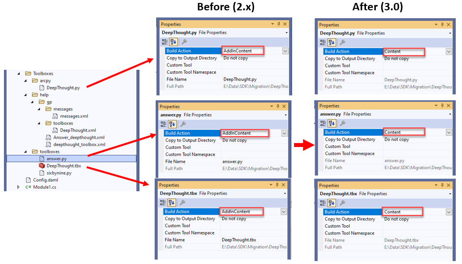

AddinContent
At 3.0 and better, the custom Visual Studio build action AddinContent is no longer supported. To embed custom content within the add-in archive, add-ins should use the built-in build action Content instead.
The Pro SDK "Pro Migrate Project" tool will automatically convert AddinContent types to Content in the converted .csproj and .vbproj, otherwise the change must be made by hand.
<!-- At 2.x -->
 <ItemGroup>
   <AddInContent Include="ReadMe.md" />
 </ItemGroup>
<!-- At 3.x -->
<ItemGroup>
  <Content Include="ReadMe.md" />
</ItemGroup>

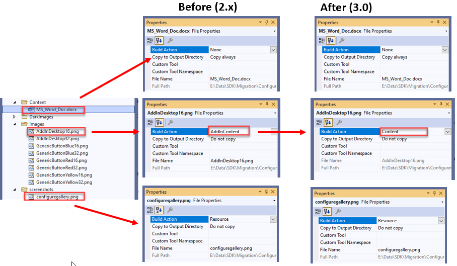

Other Custom Content
Any custom .csproj or .vbproj content added as Resource, Content, AddinContent (see above), or None will be migrated into the converted .csproj or .vbproj by the migration tool. The "Copy to Output Directory" setting is also preserved*.
* There is a bug with Visual Studio version 17.0.0 - 17.1.2. Copy to Output Directory always shows "None" in the item properties window. To determine if the Copy to Output Directory is properly set, view the item definition in the .csproj or .vbproj file. It should look similar to the below xml:
<!-- content type None, CopyToOutputDirectory 'Copy Always' -->
<ItemGroup>
    <None Include="Content\MS_Word_Doc.docx">
      <CopyToOutputDirectory>Always</CopyToOutputDirectory>
    </None>
<!-- content type None, CopyToOutputDirectory 'Copy if Newer' -->
<ItemGroup>
      <CopyToOutputDirectory>PreserveNewest</CopyToOutputDirectory>
    </None>

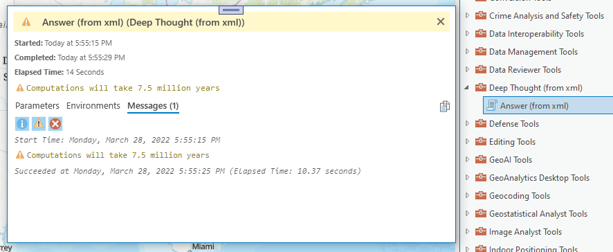

Embedded Python Toolbox
The add-in migration tool will migrate the add-in as well as the custom toolbox content to 3.x. No further action is required. However, as previously mentioned earlier in this document, the special content tag "AddinContent" is no longer supported at 3.x. The migration tool converts all of the toolbox content previously marked as AddinContent at 2.x to the built-in type "Content" (see below). The built-in Content type behaves in exactly the same way as did AddinContent.
Run the toolbox add-in.
Open the converted .csproj or .vbproj, to view the changed the toolbox content types:
<!-- Before migration-->
<ItemGroup>
    <AddInContent Include="Toolboxes\arcpy\DeepThought.py" />
    <AddInContent Include="Toolboxes\toolboxes\answer.py" />
    <AddInContent Include="Toolboxes\toolboxes\sixbynine.py" />
    <AddInContent Include="Toolboxes\help\gp\Answer_deepthought.xml" />
    <AddInContent Include="Toolboxes\help\gp\deepthought_toolbox.xml" />
    <AddInContent Include="Toolboxes\help\gp\messages\messages.xml" />
    <AddInContent Include="Toolboxes\help\gp\toolboxes\DeepThought.xml" />
    <AddInContent Include="Toolboxes\toolboxes\DeepThought.tbx" />
  </ItemGroup>
<!-- After migration-->
<ItemGroup>
    <Content Include="Toolboxes\arcpy\DeepThought.py" />
    <Content Include="Toolboxes\toolboxes\answer.py" />
    <Content Include="Toolboxes\toolboxes\sixbynine.py" />
    <Content Include="Toolboxes\help\gp\Answer_deepthought.xml" />
    <Content Include="Toolboxes\help\gp\deepthought_toolbox.xml" />
    <Content Include="Toolboxes\help\gp\messages\messages.xml" />
    <Content Include="Toolboxes\help\gp\toolboxes\DeepThought.xml" />
    <Content Include="Toolboxes\toolboxes\DeepThought.tbx" />
  </ItemGroup>
Consult the ProGuide Content and Image Resources, Python Toolboxes for more information on custom content, embedding python toolboxes.
