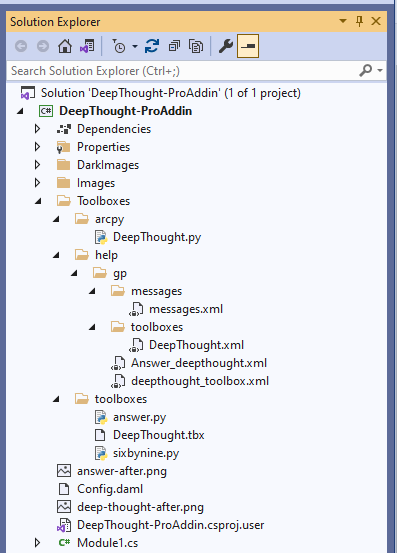

Assuming your Add-in project is open within Visual Studio:
  1. Right-click and add a "New Folder" to your Visual Studio add-in project.
  2. Name the folder "Toolboxes".
Toolboxes folder

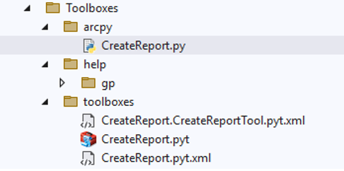

  1. Add any required subfolders to the Toolboxes folder. For example, subfolders for a toolbox, a Python module used by the toolbox, and/or any other supported files used by the toolbox. Refer to Extending Geoprocessing Through Python Modules for some examples. Also, this Esri Community post may prove useful on getting the add-in folder structure correct: Embedding Toolboxes in ArcGIS Pro.
    1. To generate the arcpy support files, run arcpy.gp.createtoolboxsupportfiles(toolbox_path) in ArcGIS Pro first. “pycache”and “esri” folder will be generated in the same location of the toolbox. (Since the toolboxes are already under the Toolboxes folder in the project, so the generated folder should be under the Toolbox folder too.)
    2. To have folder structure like below, copy the folders (“arcpy” and “help” folder) inside esri folder, paste them under “Toolboxes” folder. And delete the “pycache” and “esri” folder under toolboxes folder.
  2. Right-click on the Toolboxes folder, or any of its sub-folders, select Add->Existing Item.
  3. Browse to the toolbox(es) and supporting file content you wish to embed in your add-in within the Toolboxes folder and each respective subfolder if there are any.
Note: use "Add as Link" to add a link to a file in its original location rather than making a copy within the Visual Studio project folder hierarchy.
AddAsLink

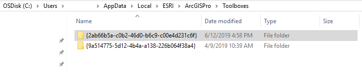

  5. A Toolboxes folder is created at \Users\<username>\AppData\Local\ESRI\ArcGISPro\Toolboxes if not previously created.
  6. Toolboxes will contain "Guid-ed" subfolder names corresponding to the add-in ids of add-ins loaded into Pro for the current session that contain "Toolboxes" folders. The contents of the Toolboxes folders will have been copied into the respective "Guid-ed" subfolders.
