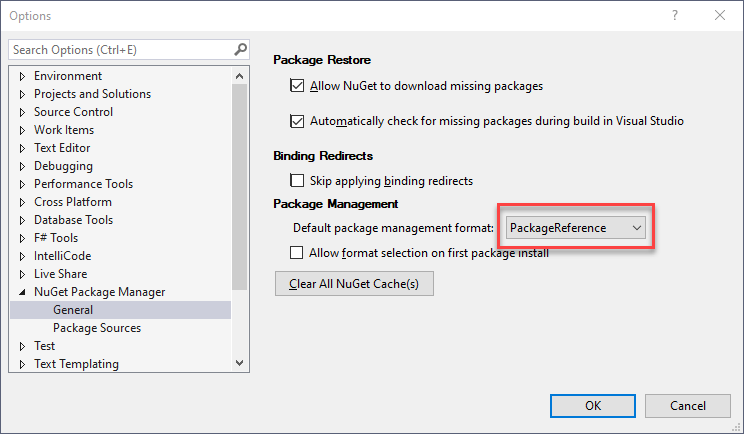

The ArcGIS Pro Extensions30 NuGet will only work with the PackageReference NuGet Package Management format setting in Visual Studio.

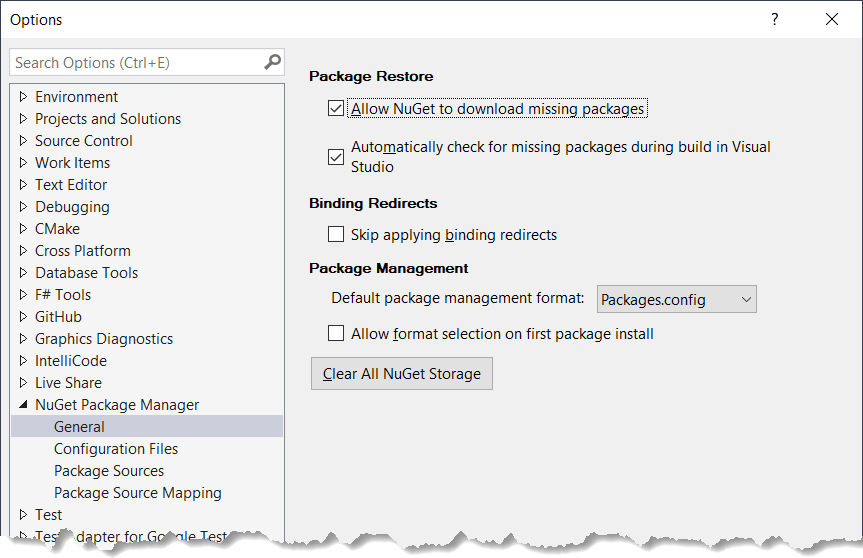

The NuGet Package Management format in Visual Studio needs to be PackageReference in order for the ArcGIS Pro Assemblies in the NuGet to be included correctly as references in your add-in or configuration project (the default is Packages.config which is incorrect). Within Visual Studio Select "Tools->NuGet Package Manager->Package Manager Settings" and change the Default package management format to PackageReference:
PackageReference
This is also covered in Step 4 of the install instructions below. Use of PackageReference as the default Package Management format mimics the same semantics for the NuGet assemblies as if Copy Local=False were set on the individual assemblies directly. We (you) do not want copies of the NuGet assemblies copied into the local add-in Visual Studio project and the Pro assembly cache i.e. Copy Local=True semantics which is the default NuGet behavior if the Package Management format is set to Packages.config. Refer to ArcGIS Pro Assembly references in your project for more information on Pro API assembly references and Copy Local.

  4. In the Options dialog, under NuGet Package Manager, select PackageReference from the drop-down for "Default Package Reference Format". Click OK to dismiss the Options dialog. PackageReferences.png

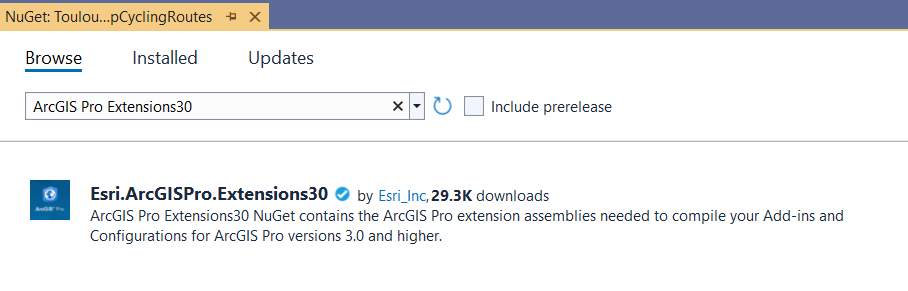

  8. Type "ArcGIS Pro Extensions30" in the Search text box. SearchNuGetGallery.png

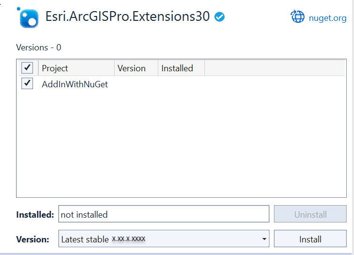

  9. Select the Esri.ArcGISPro.Extensions30 NuGet package.
  10. Confirm that the version drop down lists the "Latest Stable xxxx" version. Click the Install button. LatestStable.png

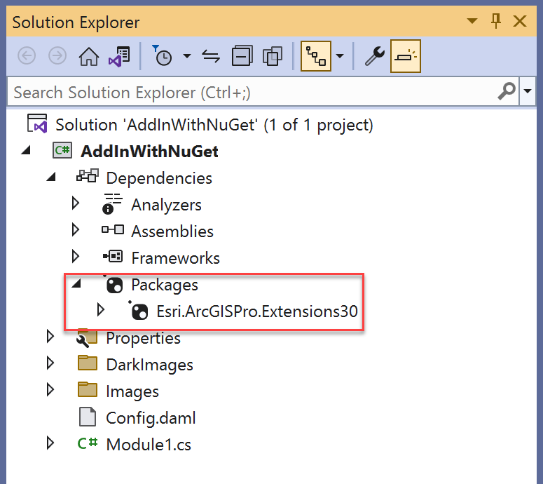

  13. In your Solution Explorer in Visual Studio, expand the Dependencies > Packages node. Notice that the Esri.ArcGISPro.Extensions is now listed as a NuGet reference.
  14. Compile your Add-in or Configuration project. The compilation will now use the ArcGIS Pro Extensions30 NuGet. Note: if, after adding the NuGet, you do not see a package reference but instead see a packages.config has been added to the project as well as copies of the ArcGIS Pro API assemblies check your NuGet Package Manager default package format (as explained in Step 4 and in the Requirements section above). Make sure the default package format is set to PackageReference.

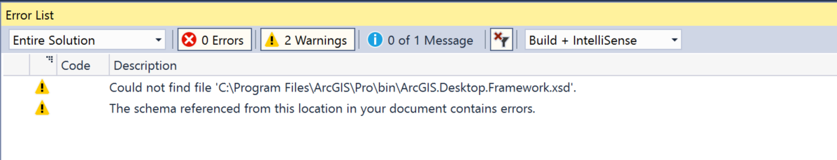

    • If you build an add-in or configuration project without ArcGIS Pro installed, you will get a warning that ArcGIS.Desktop.Framework.xsd schema is not found. This is the schema that is used for the Config.daml file included in the add-in and configuration project. This should not affect the compilation process.
