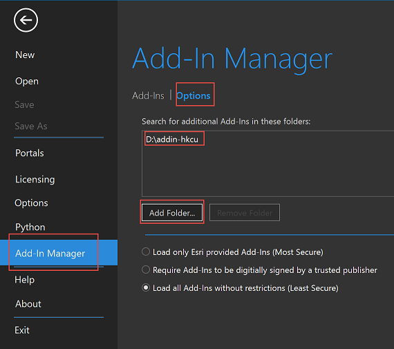

3. Current User well-known folders
At the user level, you can define well-known folders via the Add-In manager on the ArcGIS Pro backstage. In the Add-In Manager, click on Options > Add Folder... The folders defined here will be stored under [HKEY_CURRENT_USER\SOFTWARE\ESRI\ArcGISPro\Settings\Add-In Folders] in the registry. ArcGIS Pro will search any user-specified well-known folders at start up after any well-known folders declared within a configuration and any well-known folders specified in HKLM\...\Add-In Folders. See HKCU Add-in Folders.
well-known-folders
For example: This operation adds the following registry key to the HKEY_CURRENT_USER hive
Windows Registry Editor Version 5.00
"D:\add-in-hkcu"=""
The folder D:\add-in-hkcu would be searched before the default user folder but after any well-known folders declared within a (active) configuration or the HKEY_LOCAL_MACHINE hive.

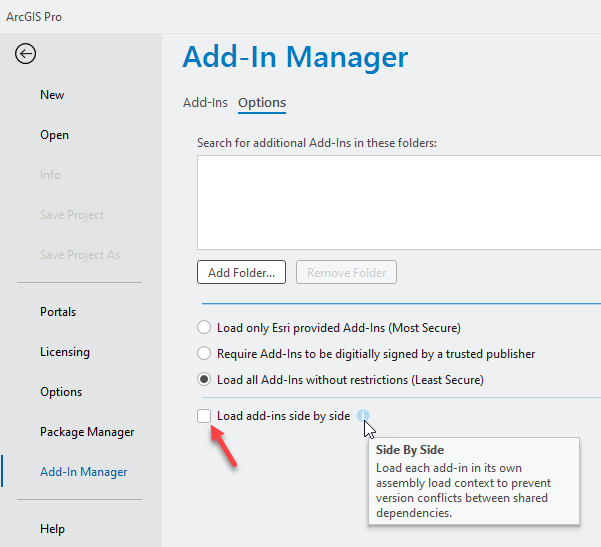

Starting at 3.5, addins and configurations can be loaded into their own assembly load context. Each assembly load context can load it's own version of an assembly allowing addins to each load their own version of addin assembly dependencies (to avoid conflicts), something that is not currently possible at 3.4 and earlier. More information on assembly load contexts can be found here: Microsoft Learn - About System.Runtime.Loader.AssemblyLoadContext.
This setting makes sure each add-in runs independently so that it doesn't interfere with others. This helps avoid problems caused by different add-ins using different versions of the same components. It also makes the system more stable—if one add-in has an issue, it’s less likely to affect the rest of the application.
3.5 Procedure
At 3.5, addins and configurations must set a registry key to be loaded into their own context. The default behavior, at 3.5, without the registry key being set or set to 0, is to use the AssemblyLoadContext.Default for addins and their dependencies. To opt-in for the independent AssemblyLoadContext behavior, set either the:
HKLM\Software\ESRI\ArcGISPro\Settings\SideBySideAddIns = 1 (DWORD) or HKCU\Software\ESRI\ArcGISPro\Settings\SideBySideAddIns = 1 (DWORD).
3.6+ Procedure
At 3.6, the registry key has been removed and the default behavior of the application now uses an application administrator setting UseSideBySideAddins - refer to Pro Application settings available for administrator control. The default value for UseSideBySideAddins is false or "off". This retains the default behavior at 3.5 and prior. The setting is also available as a checkbox on the Addin Manager backstage tab in Pro:
To load addins side by side (into their own context) to prevent version assembly conflicts, users should check the checkbox "on" (and/or set the UseSideBySideAddins administrator setting to true).

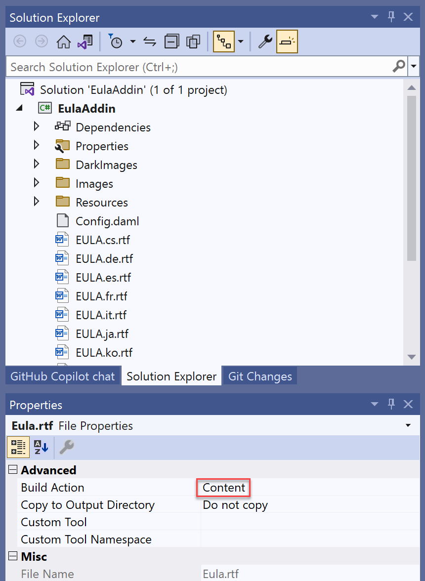

Display End user license agreement, EULA, with Addin installation

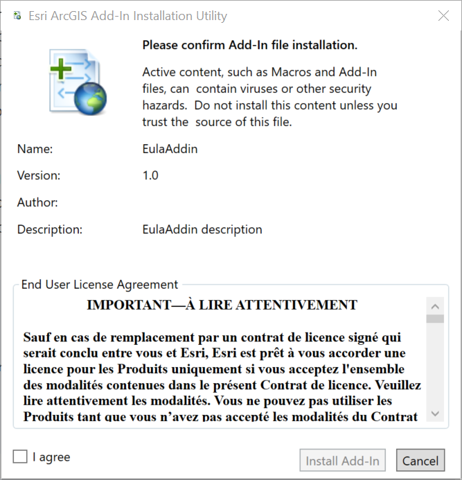

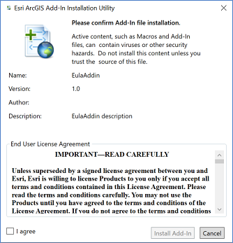

To display an End user license agreement (EULA) when an Add-in or a Configuration is being installed add your EULA information to the add-in as a EULA.rtf file. The file must be an rtf. It must be named "EULA". Include the EULA file at the root of the add-in .csproj or .vbproj project file. Set the Build Content property of the Eula.rtf to Content.
When the add-in is installed using RegisterAddin.exe (as opposed to simply copying it) the EULA file will be extracted from the Add-In metadata and displayed in the Esri ArcGIS Add-In installation utility dialog. The end user will have to click the "I agree" check box in order to enable the "Install Add-In" button and proceed with your installation.
If localized Eula files are included in your add-in, the Add-In installation utility will display the localized version of the EULA. The localized Eula displayed will match ArcGIS Pro's language setting. So, for example, if ArcGIS Pro is set to the French language, Eula.fr.rtf will be displayed in the installation dialog.
In order to display a localized EULA, the localized EULA files must follow the specific naming convention shown below:
